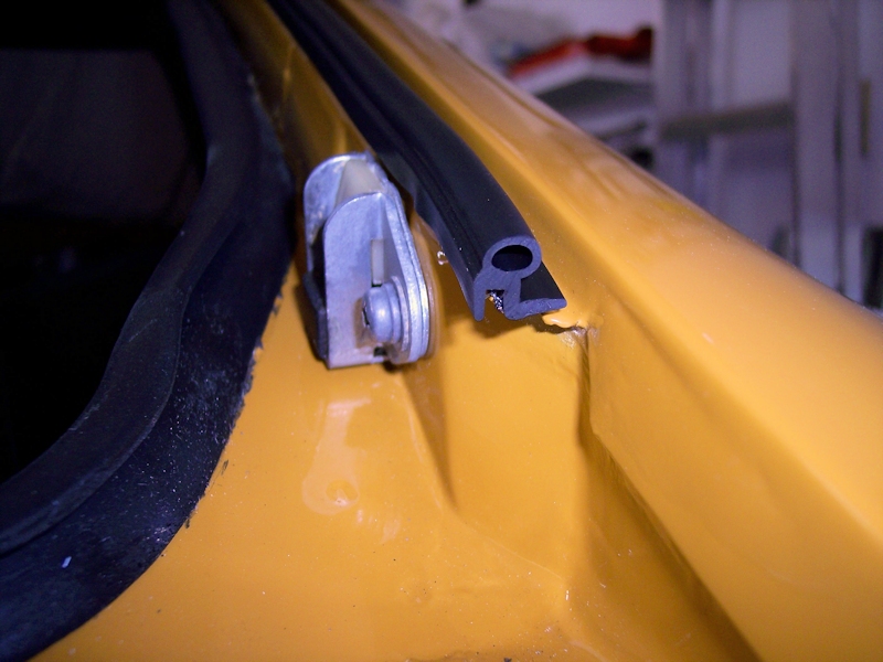

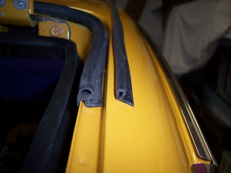

The usual set-up for the three-piece kit is a tubular profile for the upper piece and a pair of flat profile pieces for the lowers.  I think the one-piece version carries the tubular profile through all the way but you might want to confirm.  I did not like the OE approach as it did not adequately seal along the sides.  The one-piece version was not available at the time, I made my own with two additional uppers to carry the tubular profile all the way down the drip rails.  I don't know where the one-piece is available but I think you'll find it more satisfactory.
