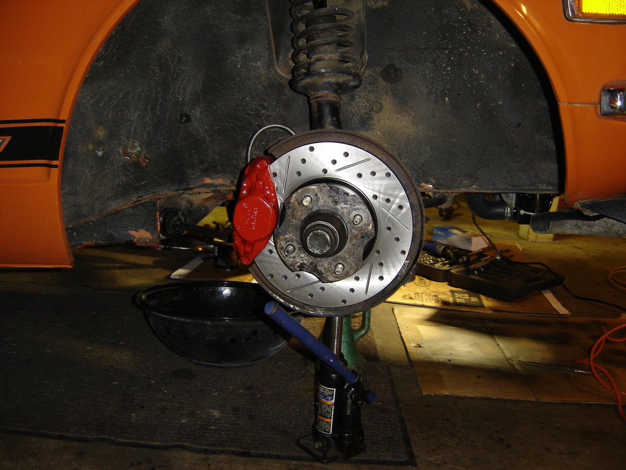

here's what i bought from chain stores for around $200.  Slotted and drilled rotors reman calipers and a can of red paint.  Also bought the stainless hoses from the calipers to the hard lines.
