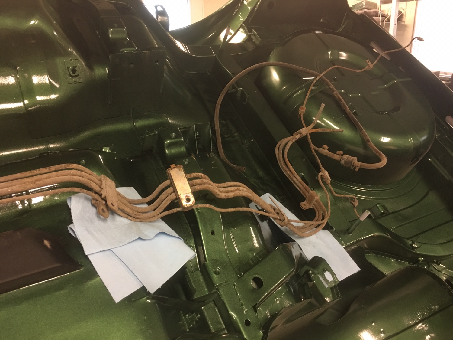

Making new lines for my buddy's 260:

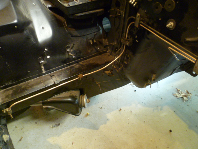

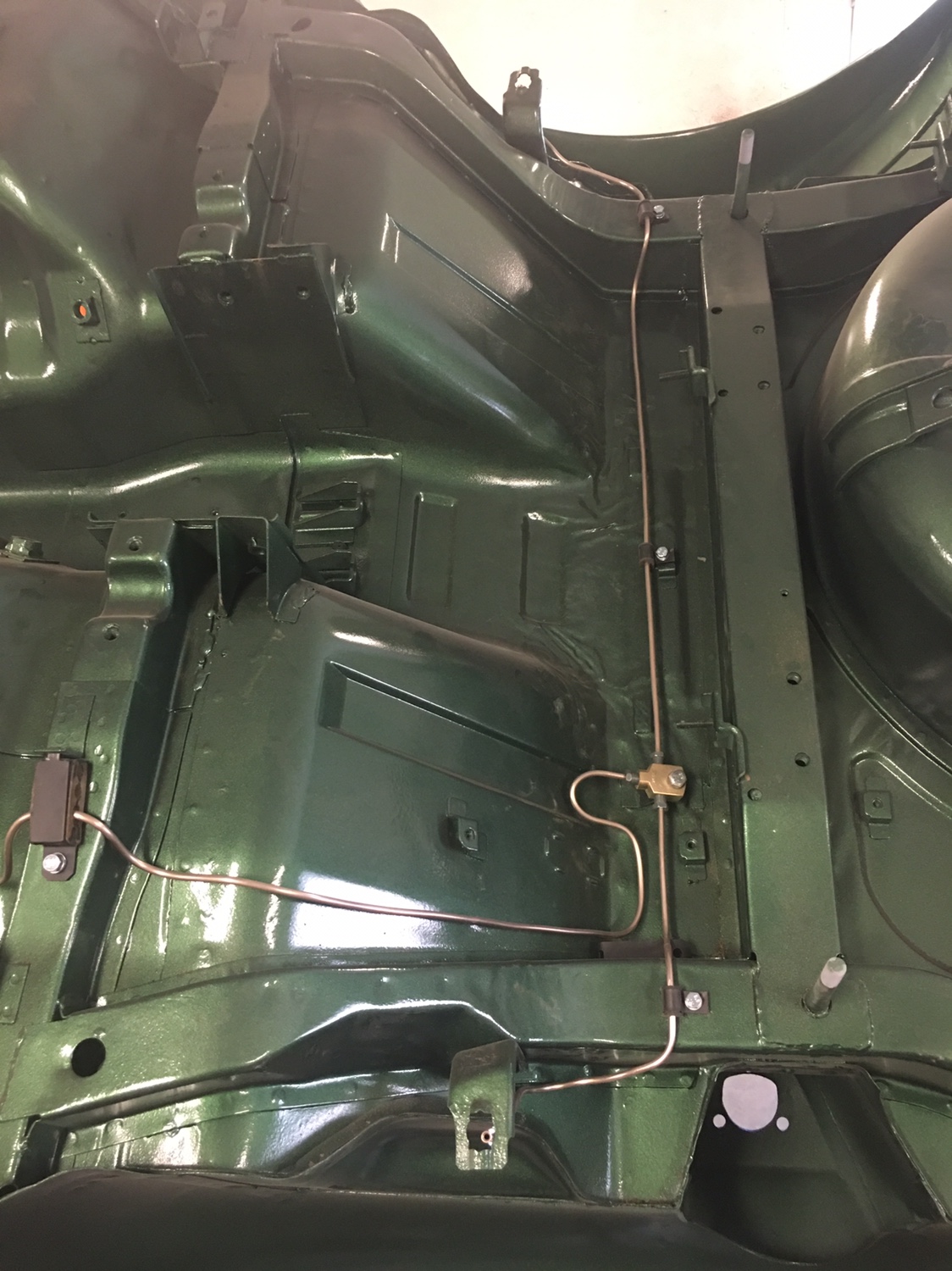

6 hours messing around in the garage today. Just going to bolt this back in I think. So much easier!
...jk!
Put in the back brake lines first.
I then made up the main line from the front... 6" too short! That's why you buy 50' of this stuff! I will have some spare line leftover but it is cheaper to order more to start with than to reorder!
