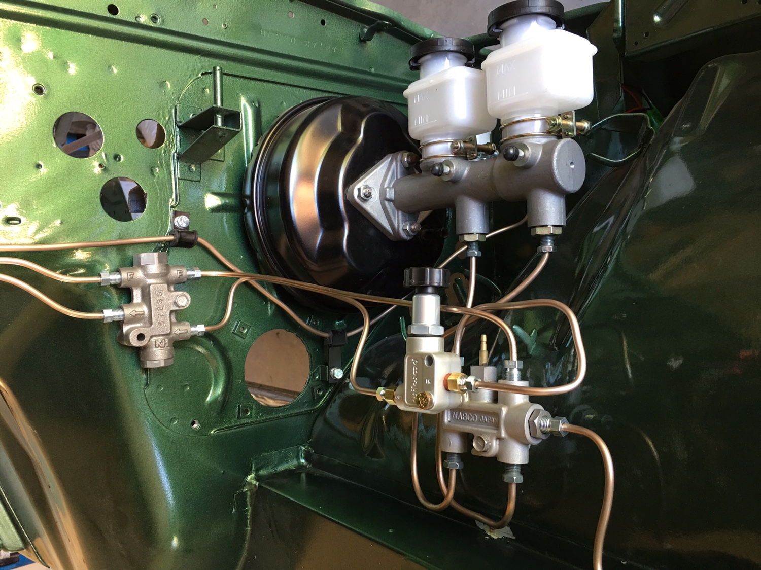

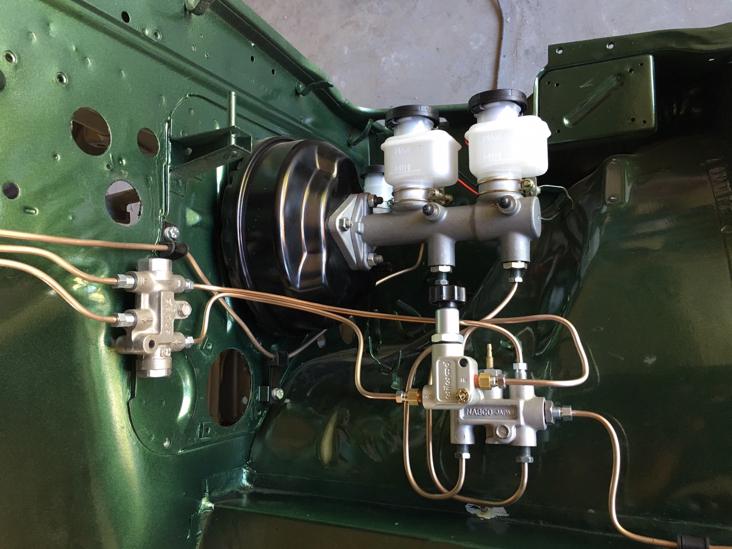

Bolted the Wilwood prop valve to the Nabco warning light distribution block.
Routed the rear brake lines back to the stock prop valve.

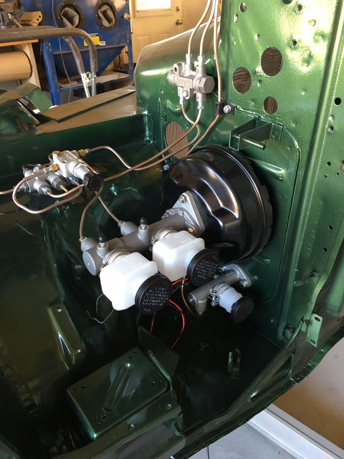

And yes, that is a bit of paint that peeled where a residual drop of brake fluid from the master cylinder fell onto the front rail. I will have to touch that up later... [emoji35]
Mark, you installed the brake lines while the car was still on the rotisserie? That is completely cheating! Wish I had thought of that.

Will do Chris. I finished my last two brake flares (hopefully) today too. Had to use imperial fittings to the prop valve.
