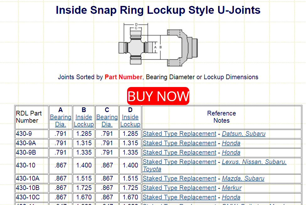

Holy moly.  I took another Google and ended up on RockFORD driveline, not Rockwell.  And found this.  You might be on to something.  Check the other dimensions.  Looks like four possibilities.

http://old.rockforddriveline.com/ujointinside.htm
So you're going to assume that the inner dimensions of the yoke are accurately machined, and use the internal clips?  Could work.  Nissan might have found that staking saved clips and time on the manufacturing line.  I hope that there wasn't a final machining step that they skipped also.

From what I read today, staking is a cost and time saving method of assembling the prop shafts. I believe the machining process for the shafts stayed the same from late series one to the S130 vehicles. The inner surface looks well machined in the photos I posted. That and the 280Z shaft has been modded with these u joints many times before me. The fact that they list the 280’s in their catalog for this part is enough reassurance for me to try. Regardless, this shaft was not going back in with the old joints so no loss.
I think they started staking because the smaller u-joints aee easier to fit. The measurements I took were 36mm inside faces, but that was with u-joint still in place so not very accurate. I think the inside is machine accuratly, because it would require less balancing weigths. My concern would be the tolerances used. 36mm could be 36.2 on one and 35.8 on another.

Wow. Neat find. I looked over the info at the website, and all indications are that it (supposedly) will work.
Only thing that looks like a little hokey to me is that there won't be a full surface contact area for the clips. Because of the way the yoke is machined off at an angle like that, only the "tips of the legs" of the clips will be doing any retention. the bottom "U" portion of the clips will be floating in air. Assuming I'm understanding the geometry correctly...
That chamfer is a concern of mine too. You could slide the circlip around the cup so it gets maximum contact. You would need enough clearance around the back of the cup. Sometimes the distance is too small and the circlip jams between the cup and yoke.

The other thing that needs to be checked is the inside distance "B" in post 1861. Is the tolerance of this distance suitable to fit inner circlip u-joints? Could be batches out there with distances like 35.8mm or 36.3mm. That could cause a problem.
