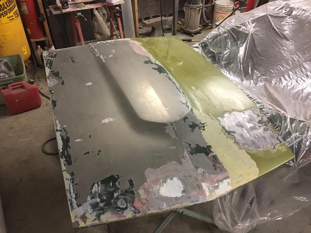

A little progress tonight on the hood.

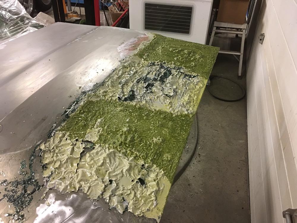

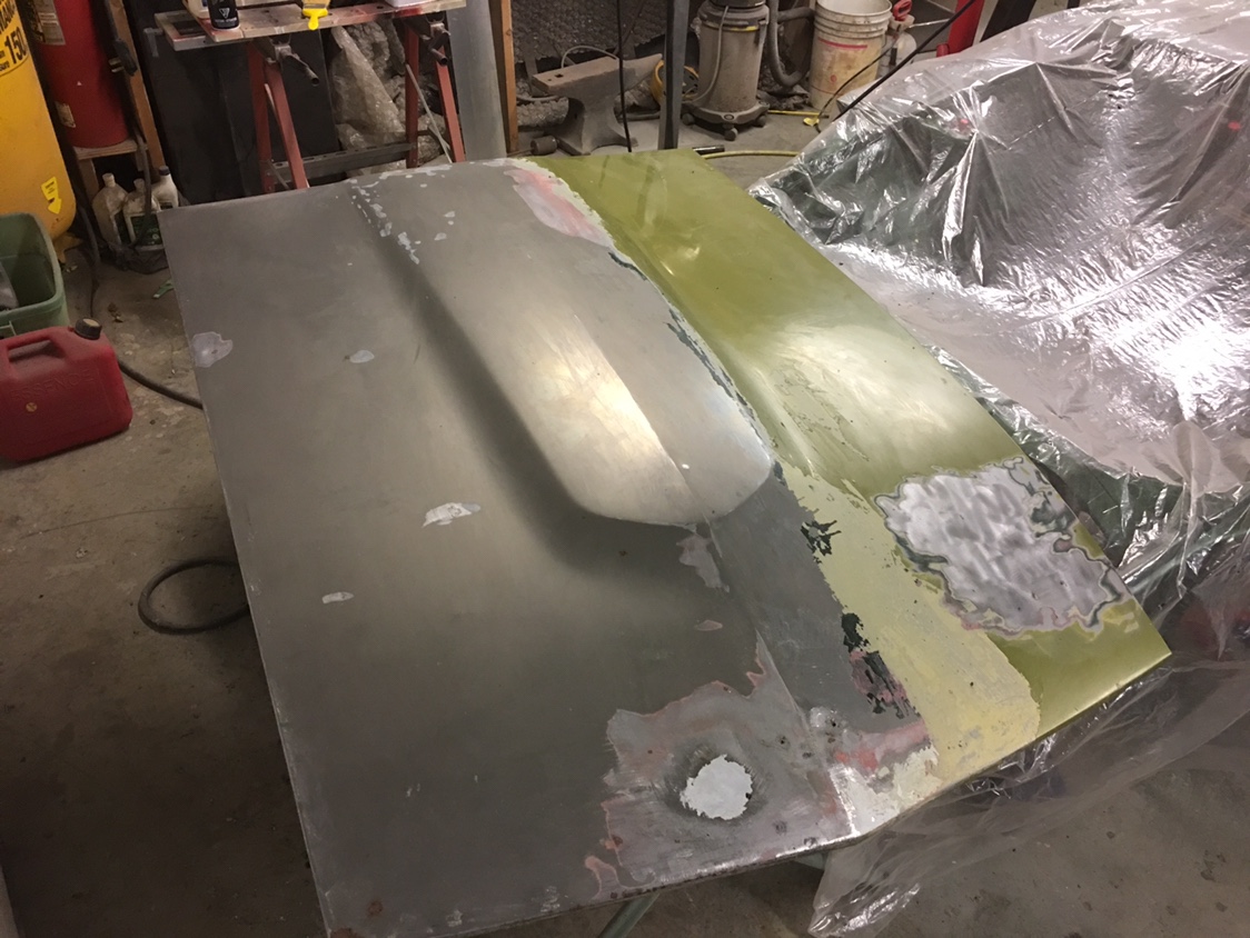

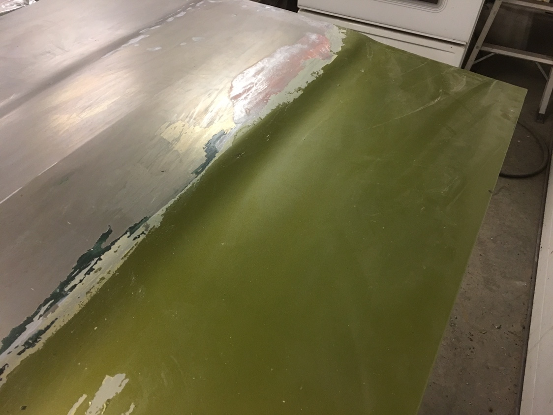

Question about paint stripping. I see in the early top-of-hood' pictures that the stripper took the first coat and pretty much left the remaining coats.

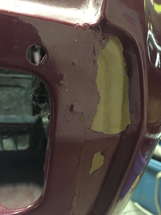

I have a project going right now that I have to remove a single layer of badly applied paint from the original stock paint. There are several chips out of the top layer, from storage damage,  that I can easily make larger by manually picking more paint off. I don't trust the prep, so that layer has to go.  See below.
Wondering if sanding or a liquid stripper is the way to go to just get that crappy red layer off. Even if it does remove the top layer pretty well, am I risking the effect that the stripper has of releasing the paint bond of the lower stock layers? Any experience?
I rarely remove stock paint, as it is usually very very well bonded to the body, and in this case, this car is as close to rust free and previous body work/repair free as I've seen in a Datsun of any variety. There is no compelling reason to take this one to bare metal.
Any insight or recommendatoin is of course welcome, but I really just want to hear what Mark experienced when he removed that paint with the stripper, and how the layering removal worked/looked.

I’ll respond by saying that the paint stripper does seem to work in layers. The longer you leave it on, the more it removes. I don’t think I would trust it to not remove more than one layer though. I found that the milder versions of Heirloom stripper from Canadian Tire would be a safe start, but I would do small patches and remove it as soon as it starts to bubble.
It does seem to do an awesome job when it gets to the bare metal though! Like a factory fresh panel! And no residual effects when it evaporates meaning no paint bleed later on.

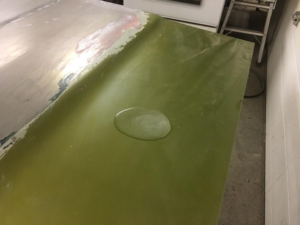

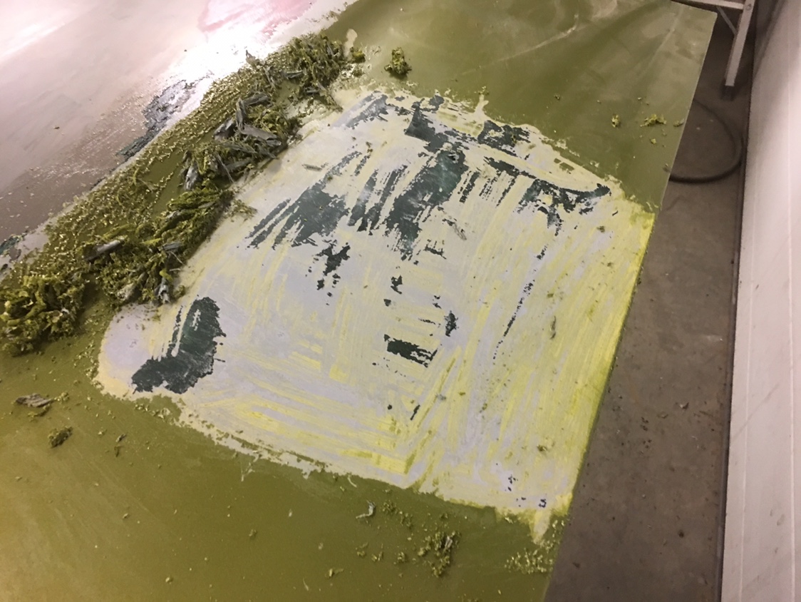

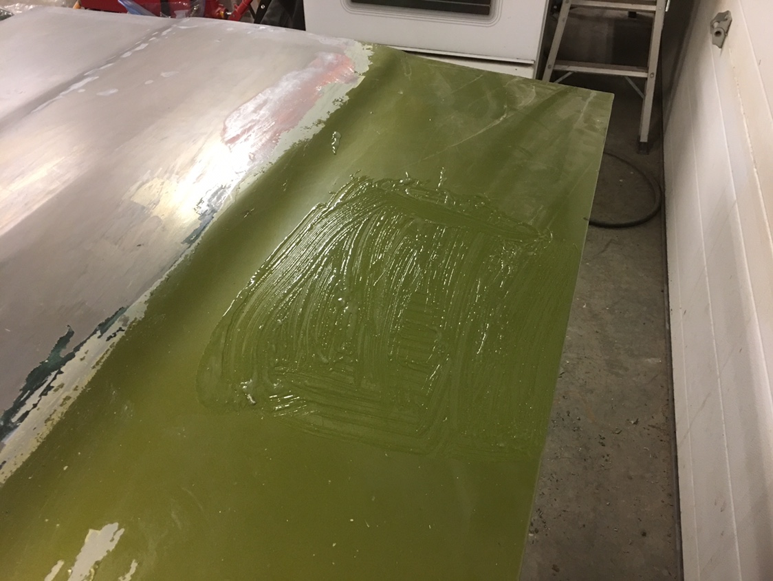

Cheap top coat on epoxy primer
Heirloom Max stripper.

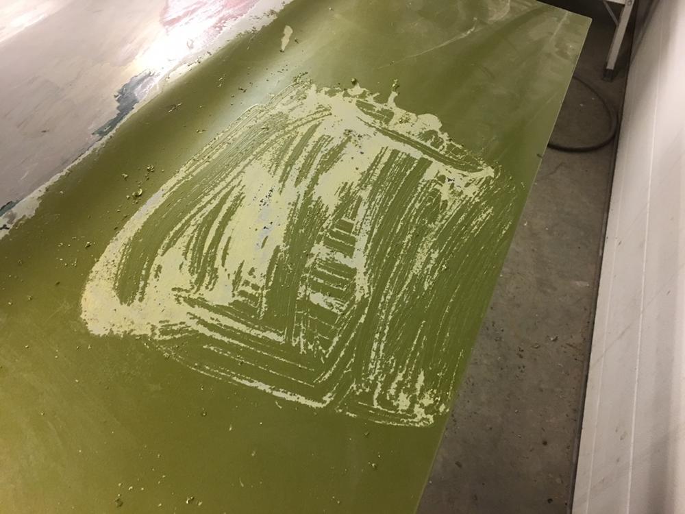

One minute later
Two minutes
Scrape test at three minutes

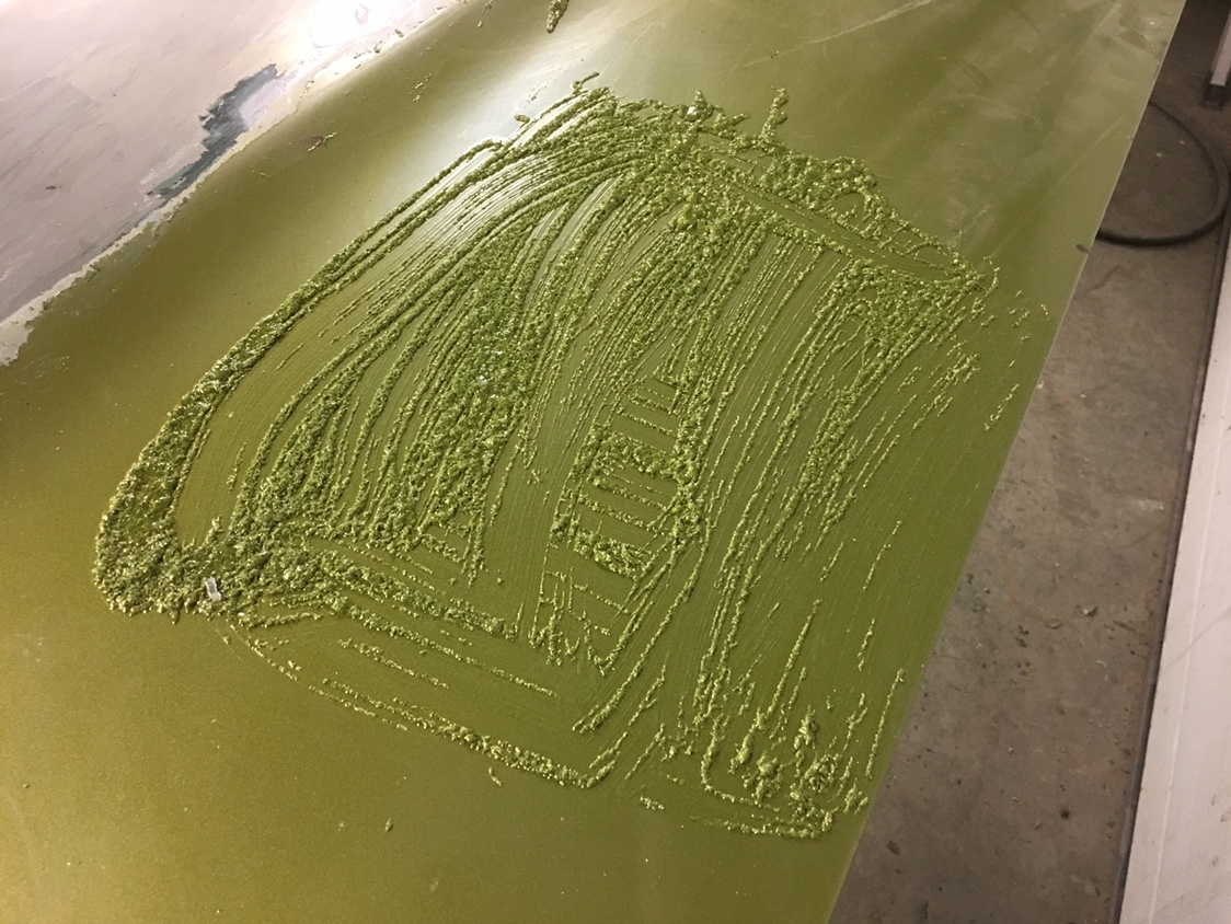

More stripper and one extra minute then scraped again.
In the end it recommends leaving it on until the surface is softened then reapply as needed.

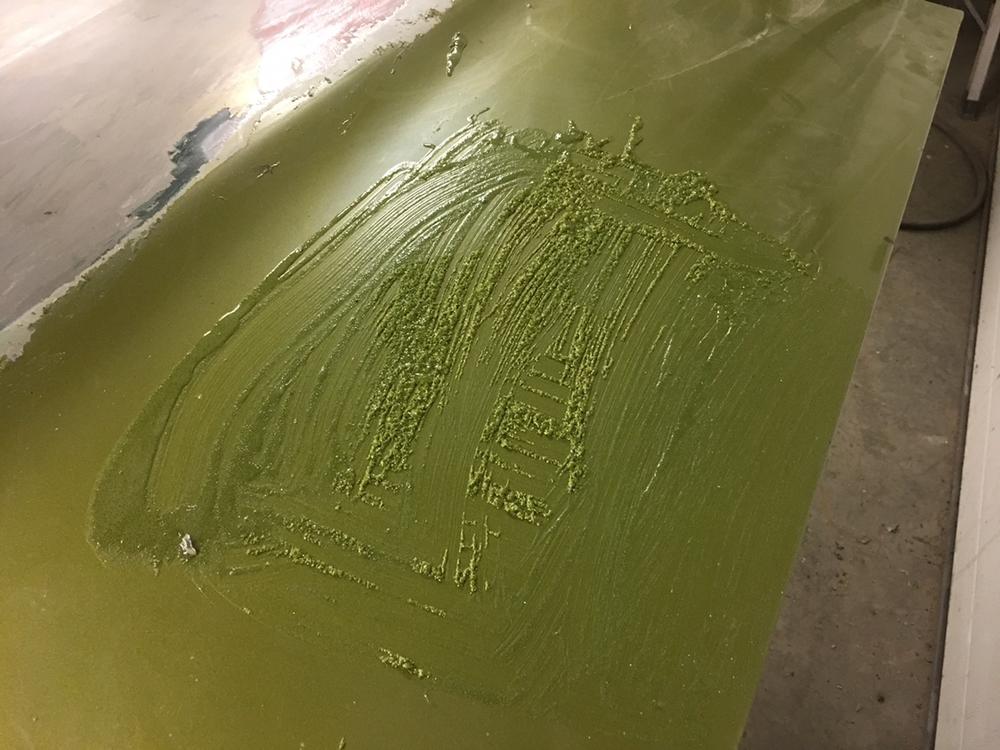

Five minutes and counting...
