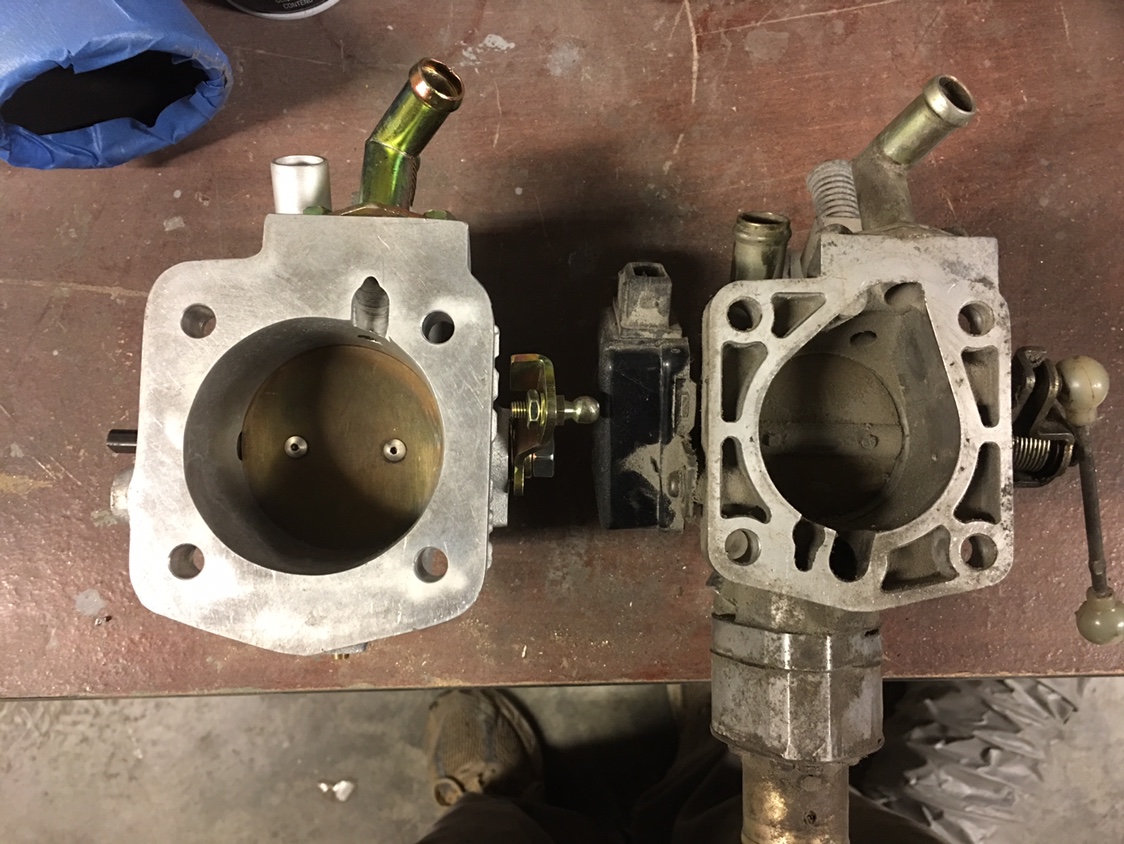

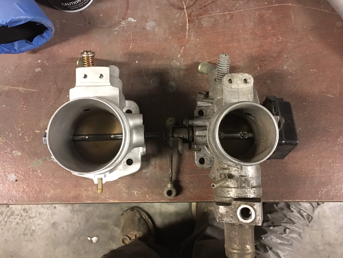

Should be a bit more “throaty” for sure. I haven’t heard Jim’s engine before but it was always carbureted as well. He will have to be the final judge! @zKars

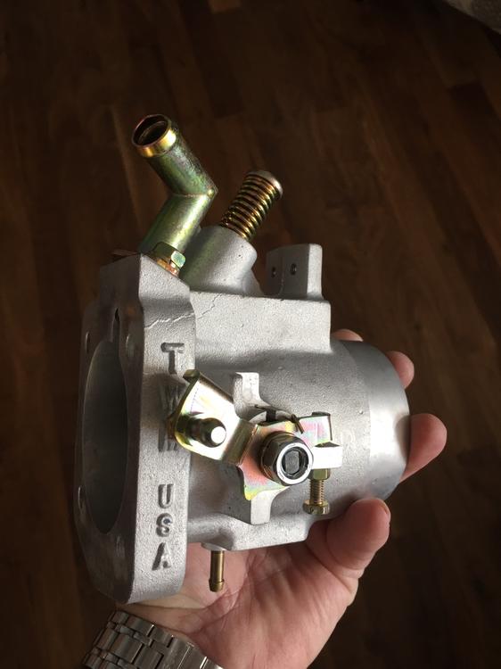

I will have a bit of porting to do on the factory intake that I polished a year or so ago...

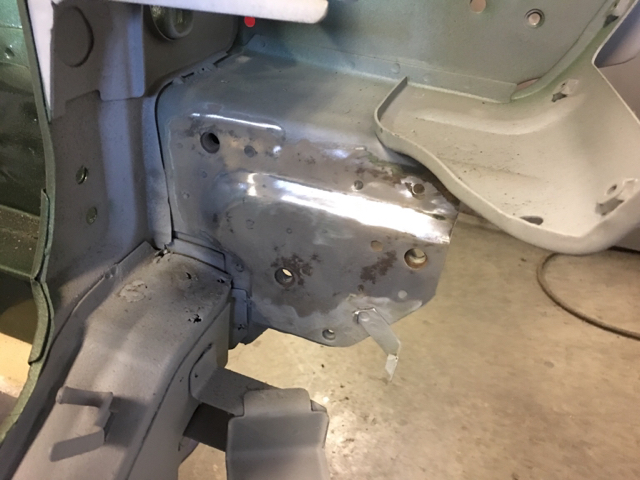

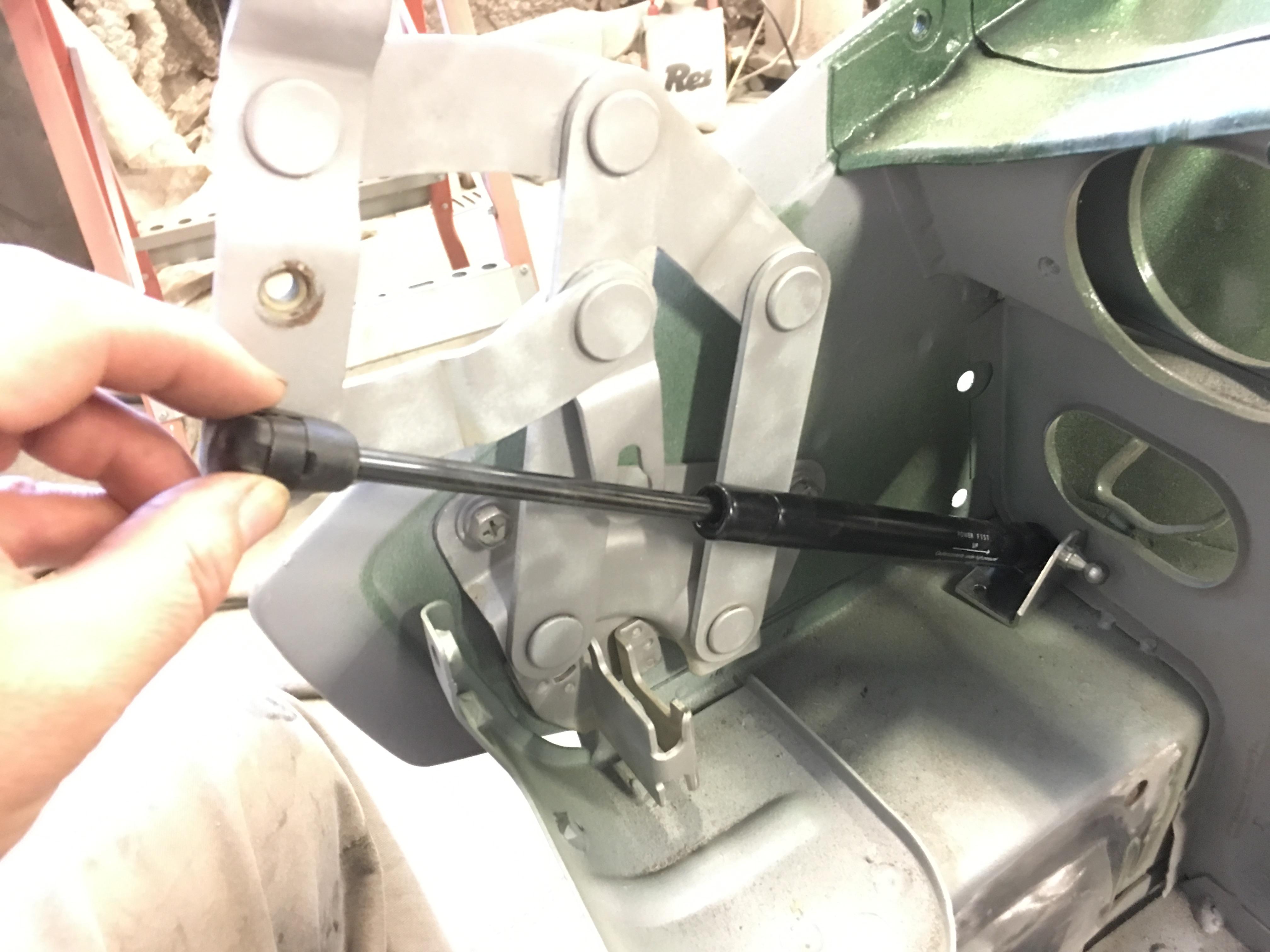

Cleaned up the front bumper shock mount areas a bit. Prepping for the gas shock hood mod.
Sandblasted the old lifts

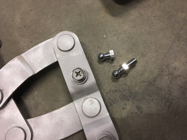

All the parts needed
Cut off the screw mounts on the ball heads and position for welding
Comparison of the uncut head with the cut threads version

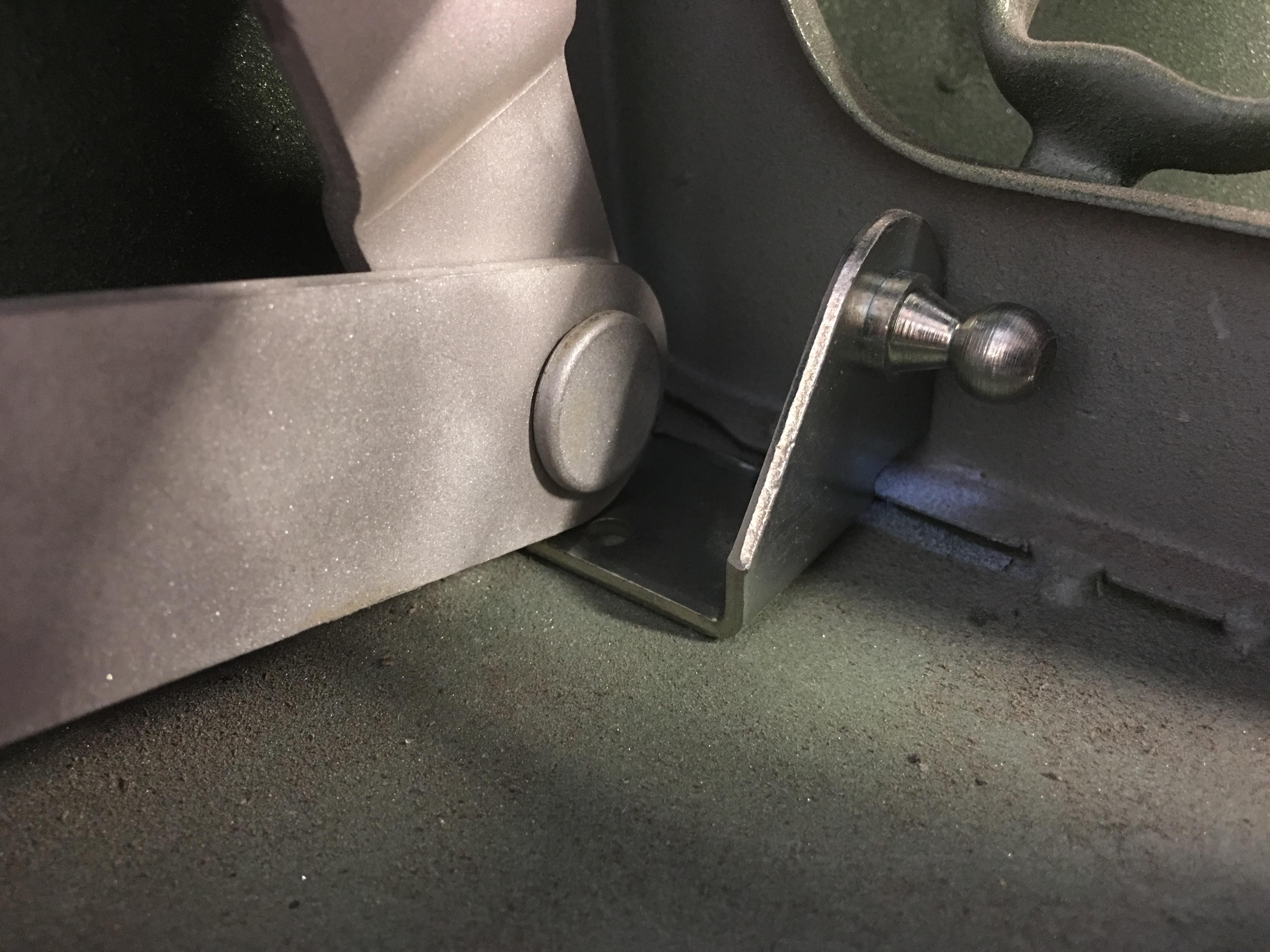

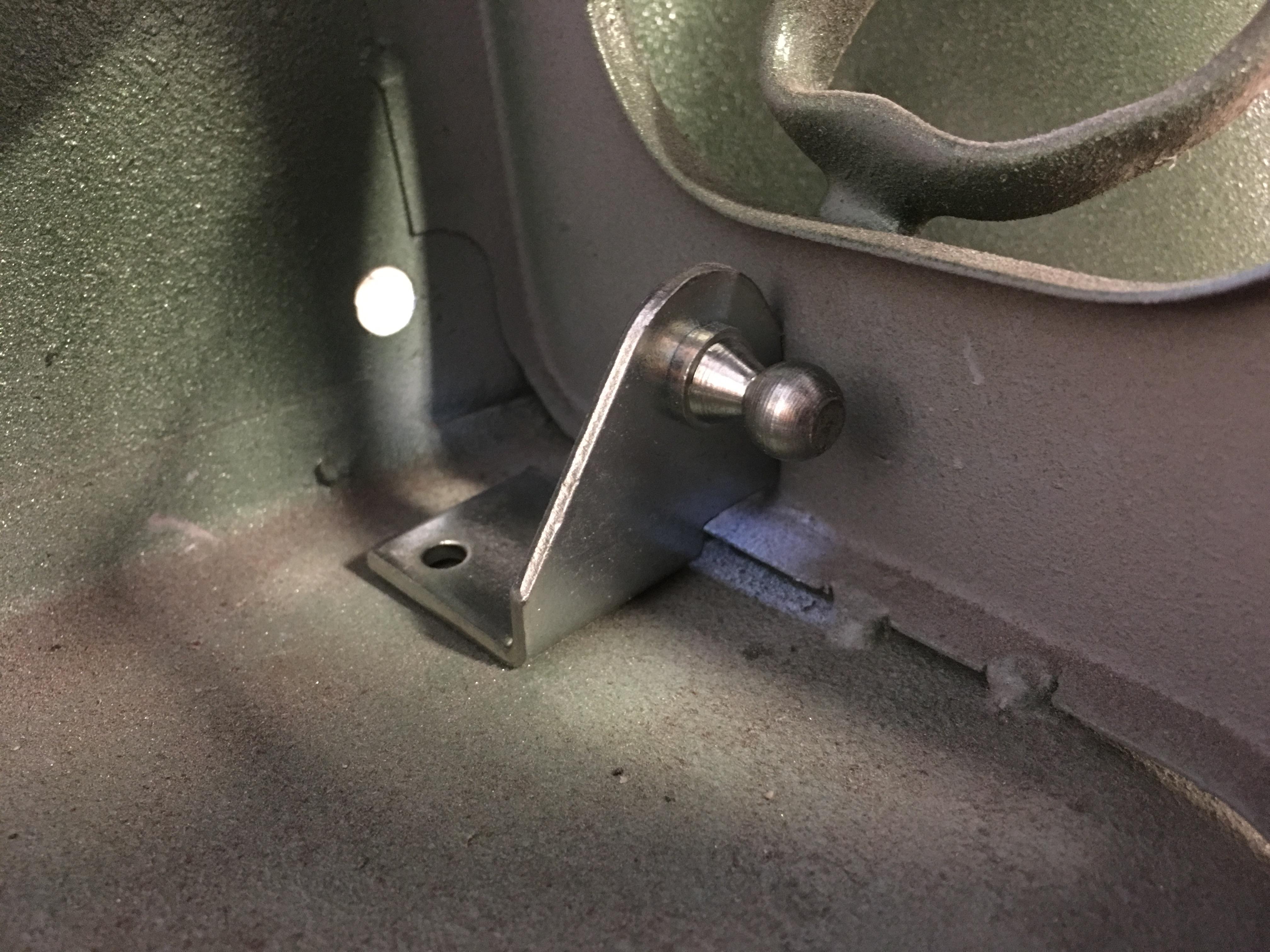

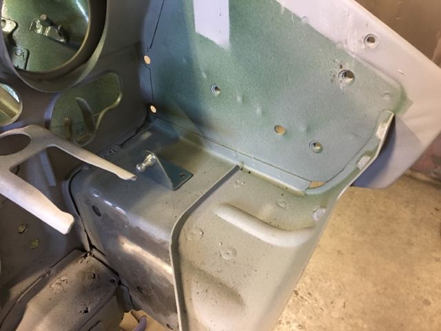

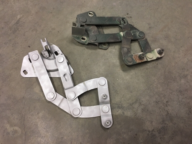

The plan is to finish prepping the hinges, then position the lower bracket and weld it to the frame.

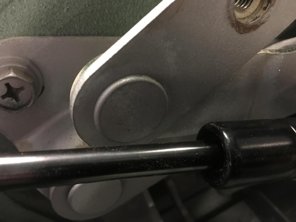

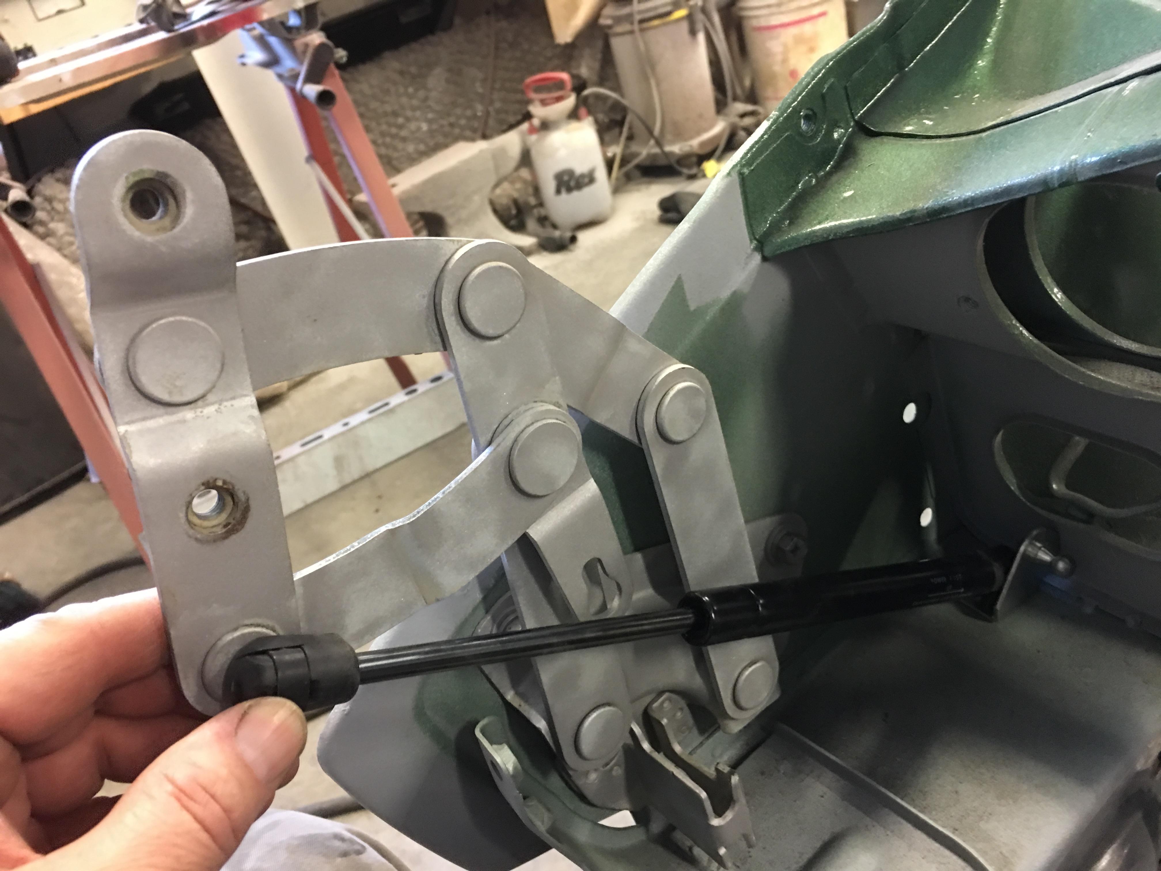

Some test fitting shows the bracket will be up against the rad support wall so I trimmed the bracket down. The full range of motion will have the strut fully extended at open and fully closed at hood closed. Not a lot of extra room but this should work! I plan on leaving the torsion bar fittings on the hinges as a backup system.
