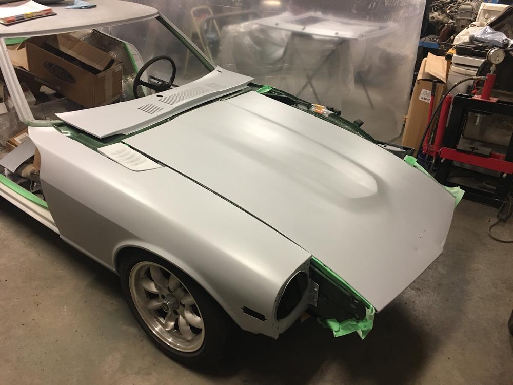

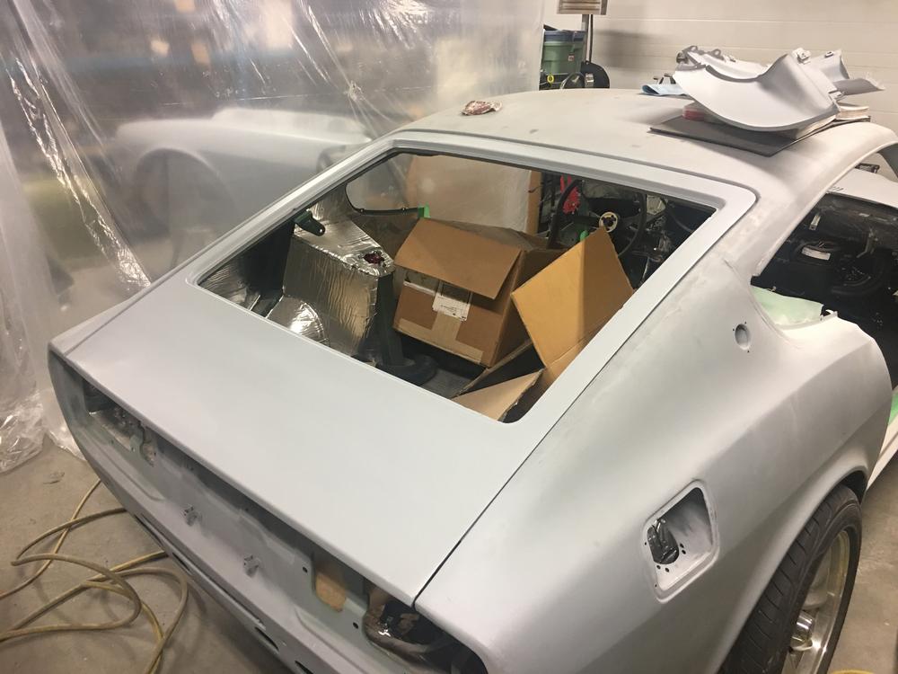

12 hours ago, wheee! said:
A little more time in the shop tonight. Finished the hood primer and half of the hatch! One fender and the outer side of the hatch left!
