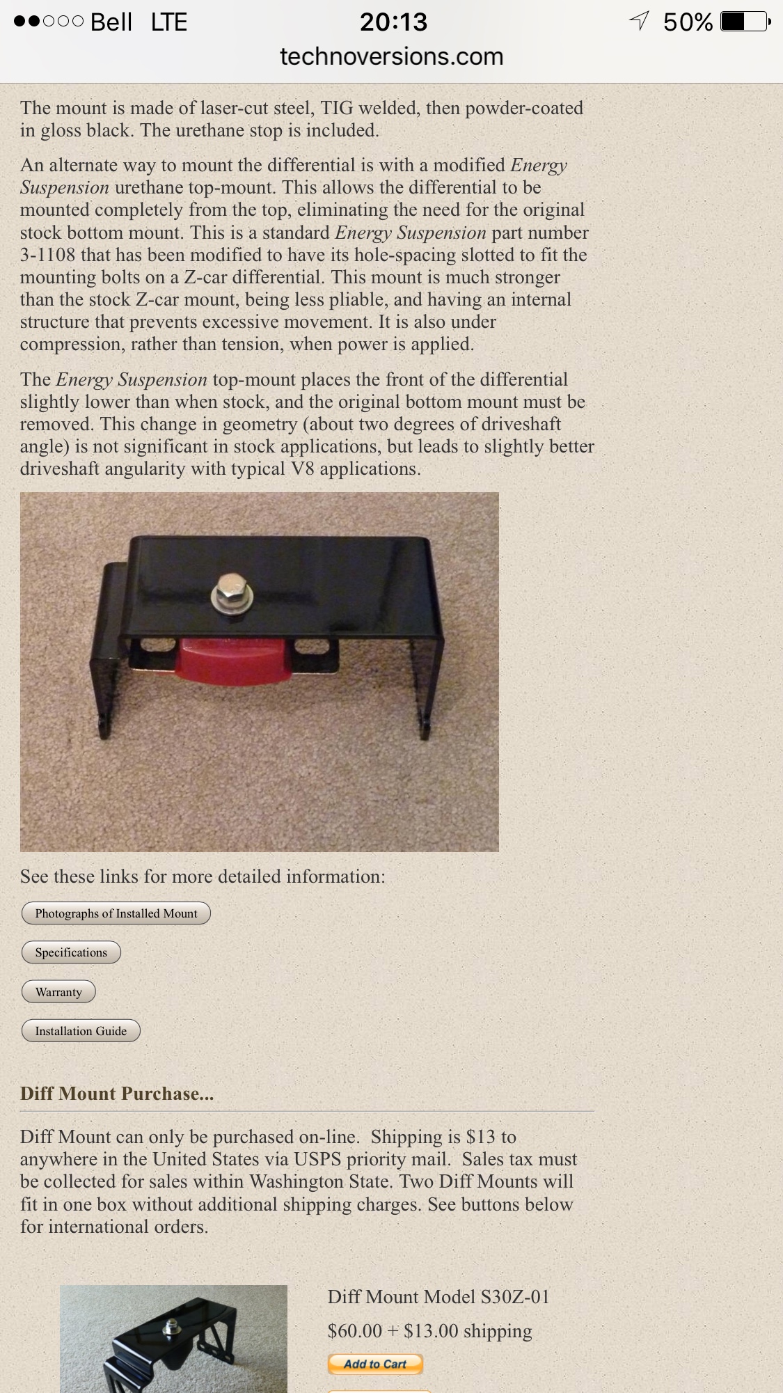

Ordered a TechnoVersions GM trans mount for my RT diff mount! That and my powder coating lights. And a thermal temp gun. And a 3M paint cups kit. Oops. eBay happy I guess.
Hey wheee!, I have the RT diff mount on my birthday list (hoping it helps solve both clunking and jerking).  If you use the GM mount, do you still need the lower diff mount from Nissan (55415-N4301), or does it replace it?
You do not need the lower diff mount (rubber component) as the GM mount both supports and cushions the diff with a suspended bolt that will 'catch' the diff in case of bushing failure.
See their page for details!

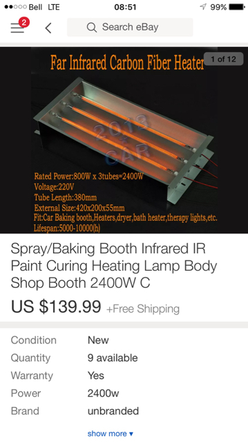

Some pics of the powder coating parts I ordered...
Thermal temp sensor
2400w baking light

Baking Light is in along with most of the other toys I ordered. I added a few things to the buy list as well. Picked up the TechnoVersions modified trans mount for the RT Diff Mount. Gonna powder coat that diff mount too!
