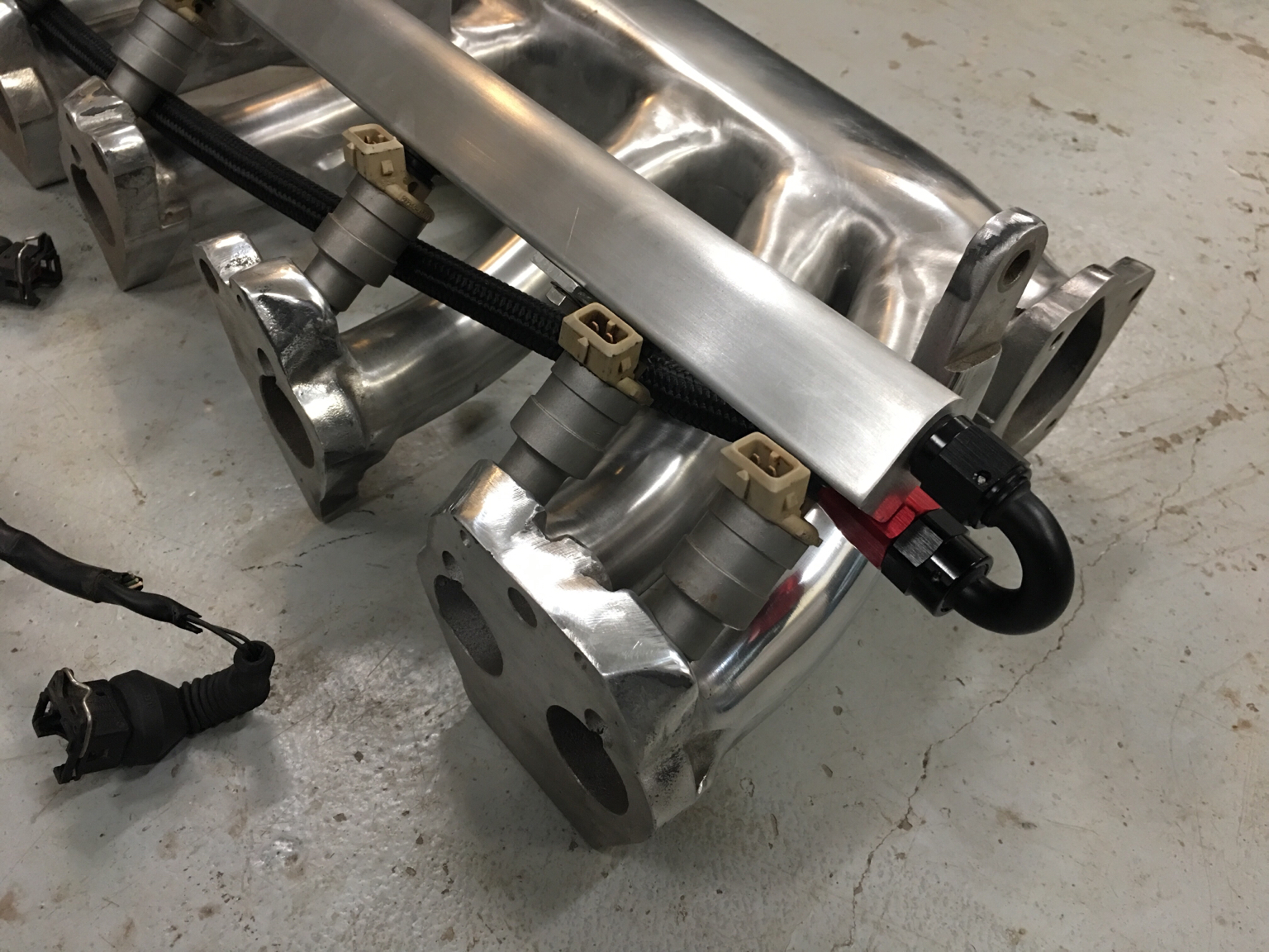

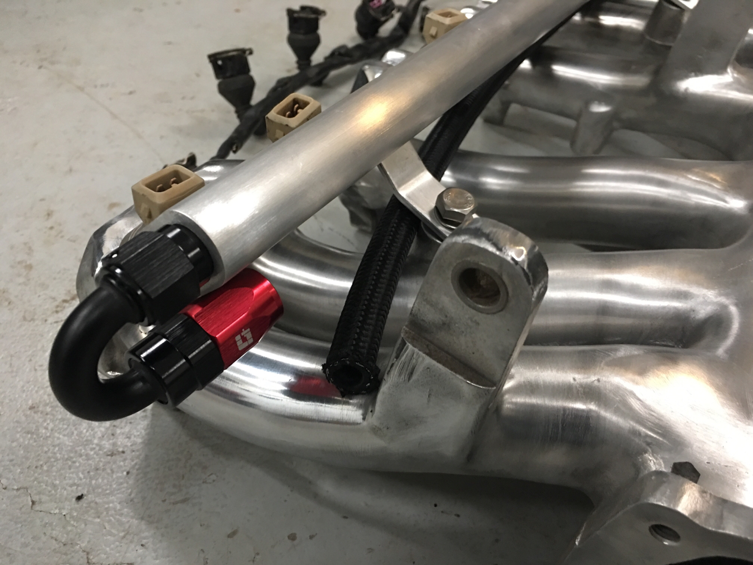

I have more AN Fittings on the way so that it will be perfectly assembled on the car. No barbs. The fuel line will feed from the firewall, under the fuel rail, up 180 degrees into the front of the rail, past the pressure gauge, out the rail, into the pressure regulator and back to the tank. All with AN 6 black and red fittings.

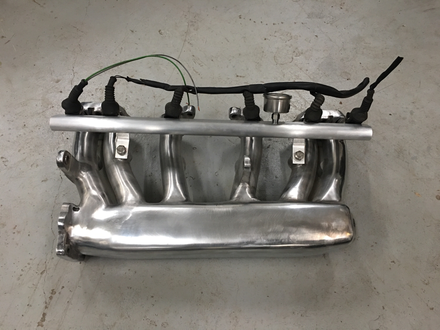

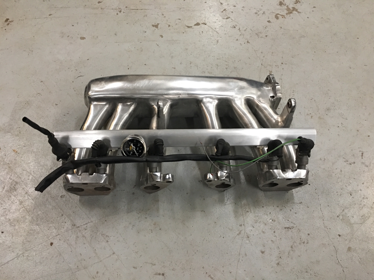

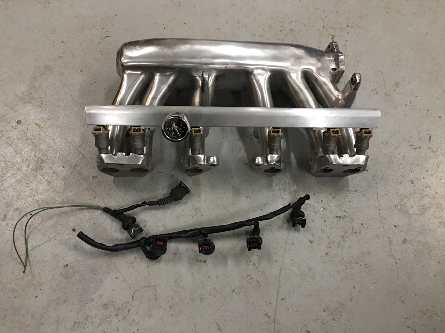

Some quick pics of the pieces. I don't have all the fittings here yet, so just approximating the look with injectors and hose, new quick clips for the harness etc. I have a 12 pin connector kit to attach the fuel rail to the fuel injection harness. That should make moving the intake off the motor a lot easier. I will build a custom harness for the injectors.

Looks great. I'm trying to decide my plumbing now. Not sure if I want to do all the 6an fancy stuff- but it looks cool. I have to run all new lines from the tank on my 71, so I'm starting from scratch.
How many hours do you have in making that intake look that good?
Ughhh.... I would say over 40....
I plan on cleaning it up really well, degreasing, pre-heating and off gassing, then powder coating it in the new Eastwood Chrome powder coat to protect it. I don't think I could ever polish it enough or properly to be happy...

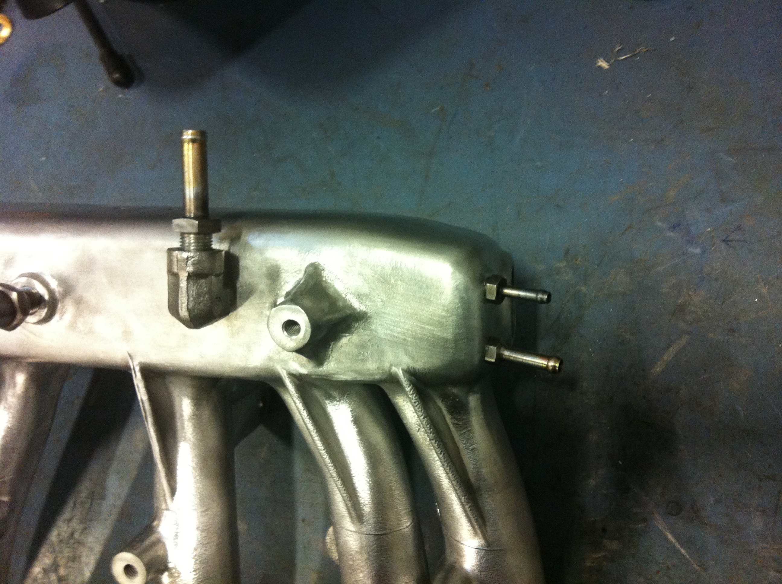

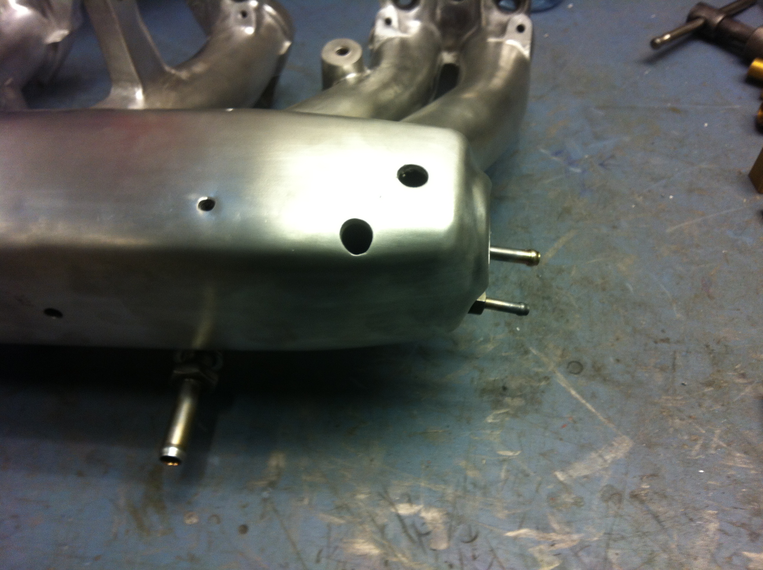

You did away with all your vacuum ports?
Nope! Just hid them!!
The brake booster  line faces the booster now and the two ports on the rear feed towards the firewall. I may block one off still and run a vacuum block on the firewall too...
The old ports were TIG welded closed.
