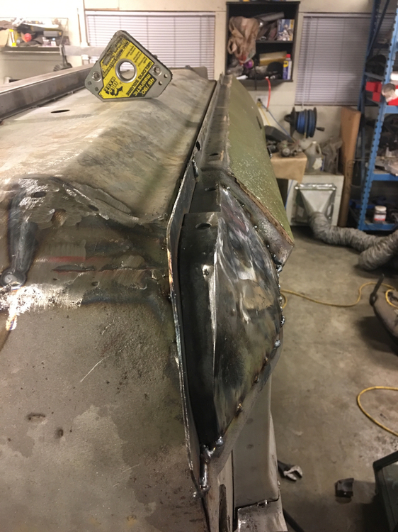

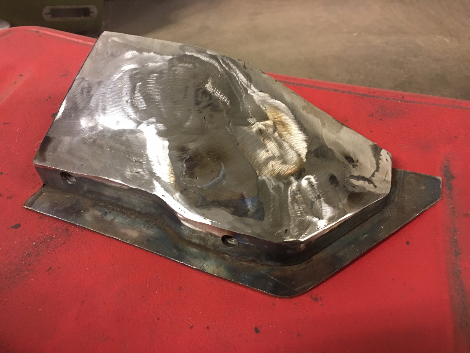

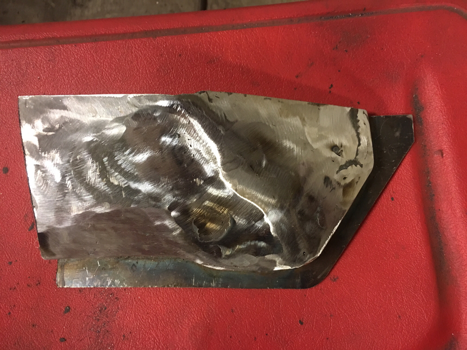

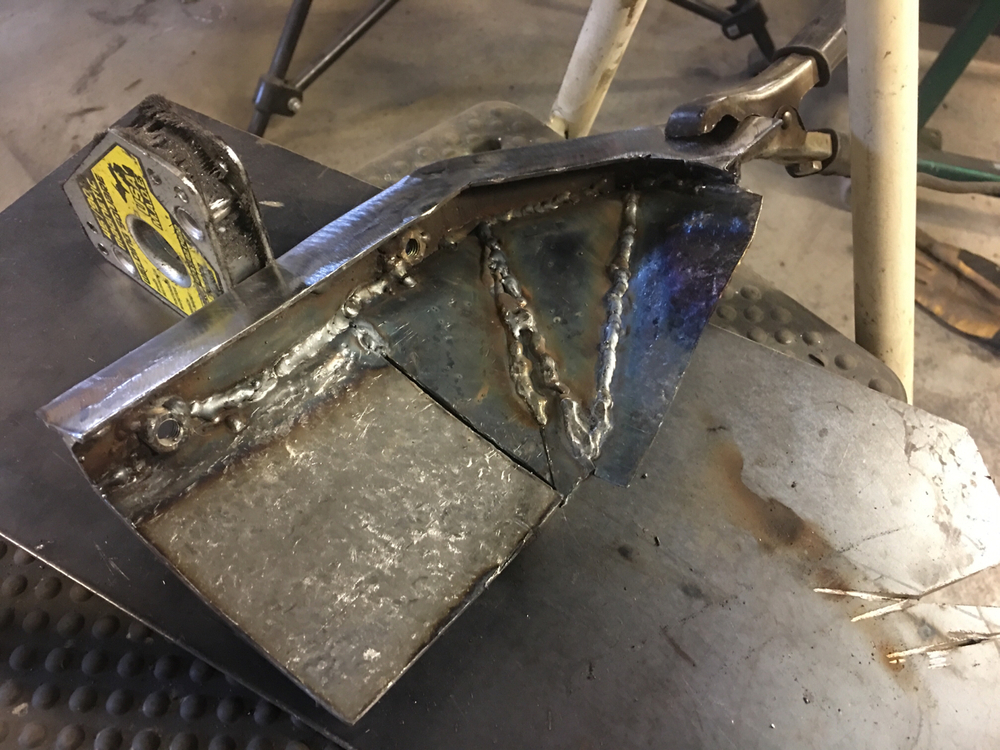

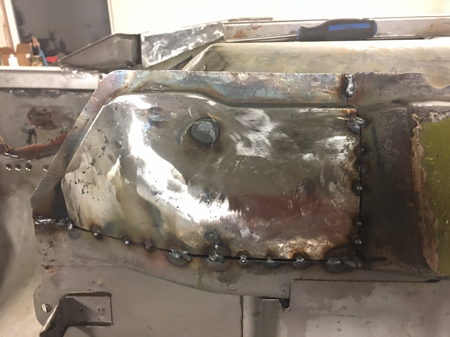

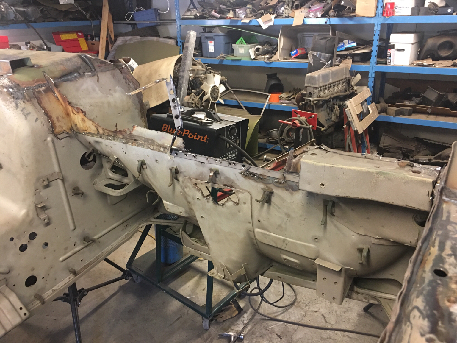

I'm such a butterfly! Got sidetracked with building the new "bulldog" end for the passenger side.
Made a form around the dead one and welded in new capture nuts. Stretched, pounded, cut and welded the shape out. Still needs final fitting...

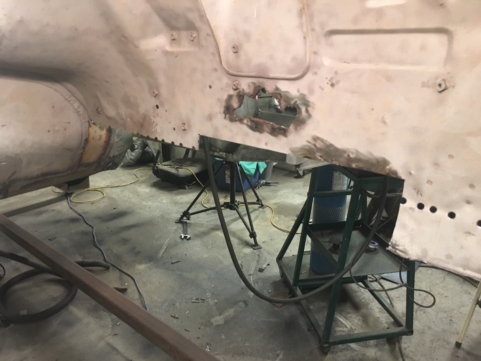

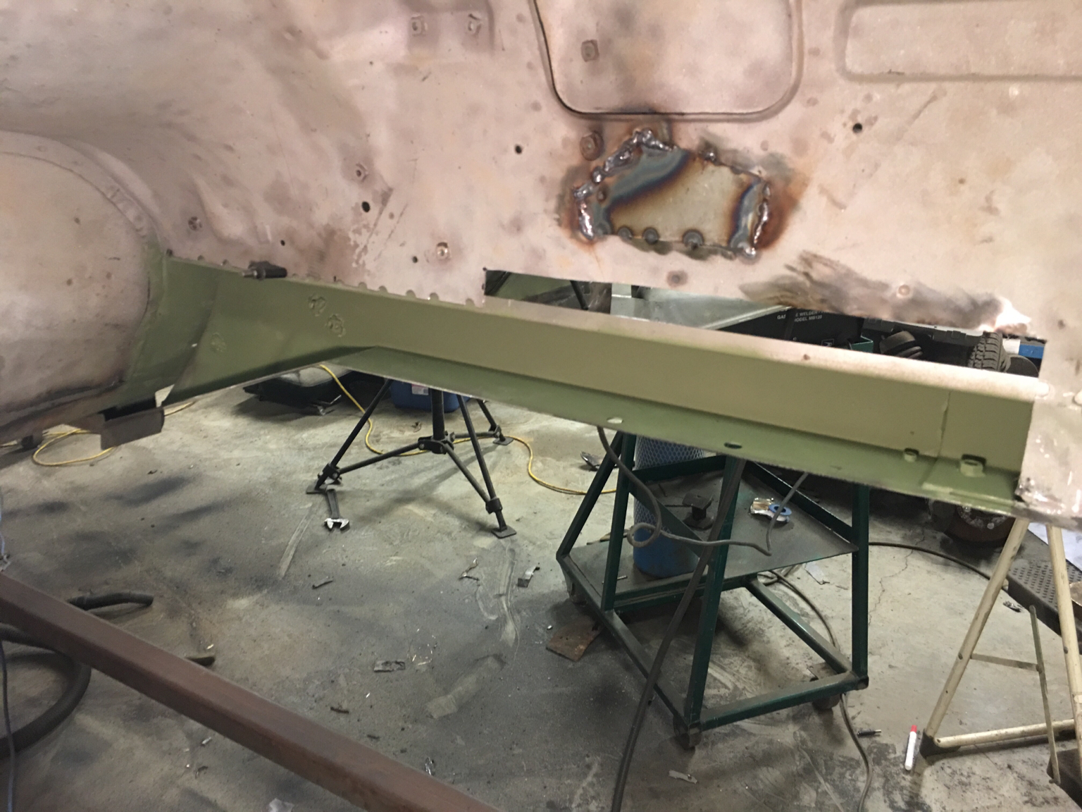

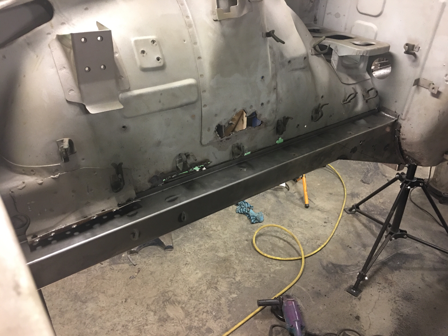

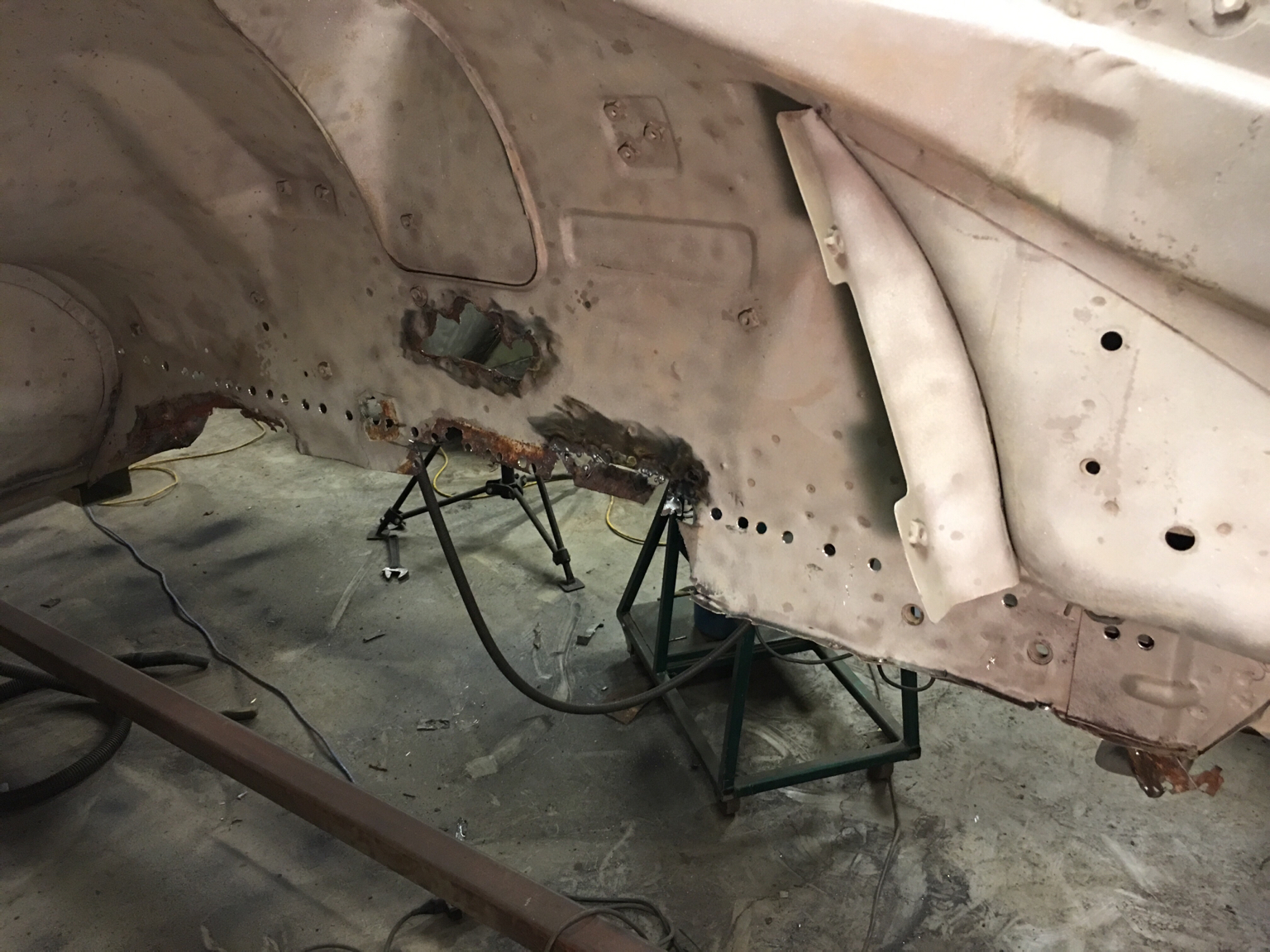

Hey when working on the sections where something structural is cut out (frame rail, firewall portions, doglegs) what is done to mitigate the chassis from moving around/bending?
That passenger frame rail shot looks completely nuts.
