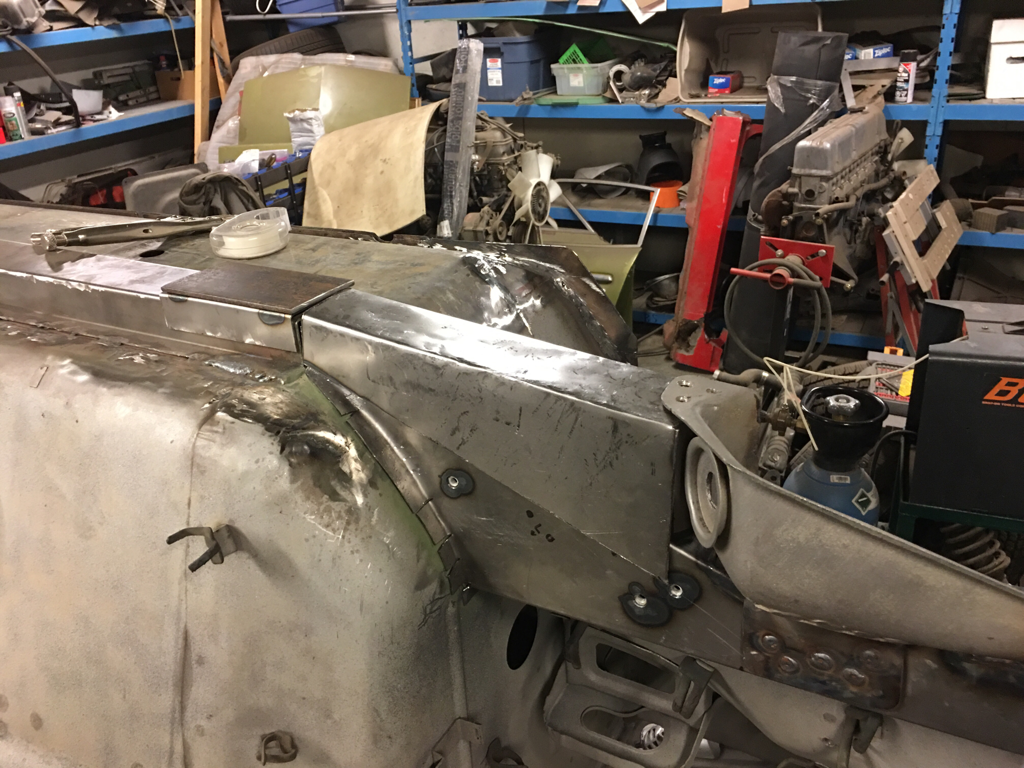

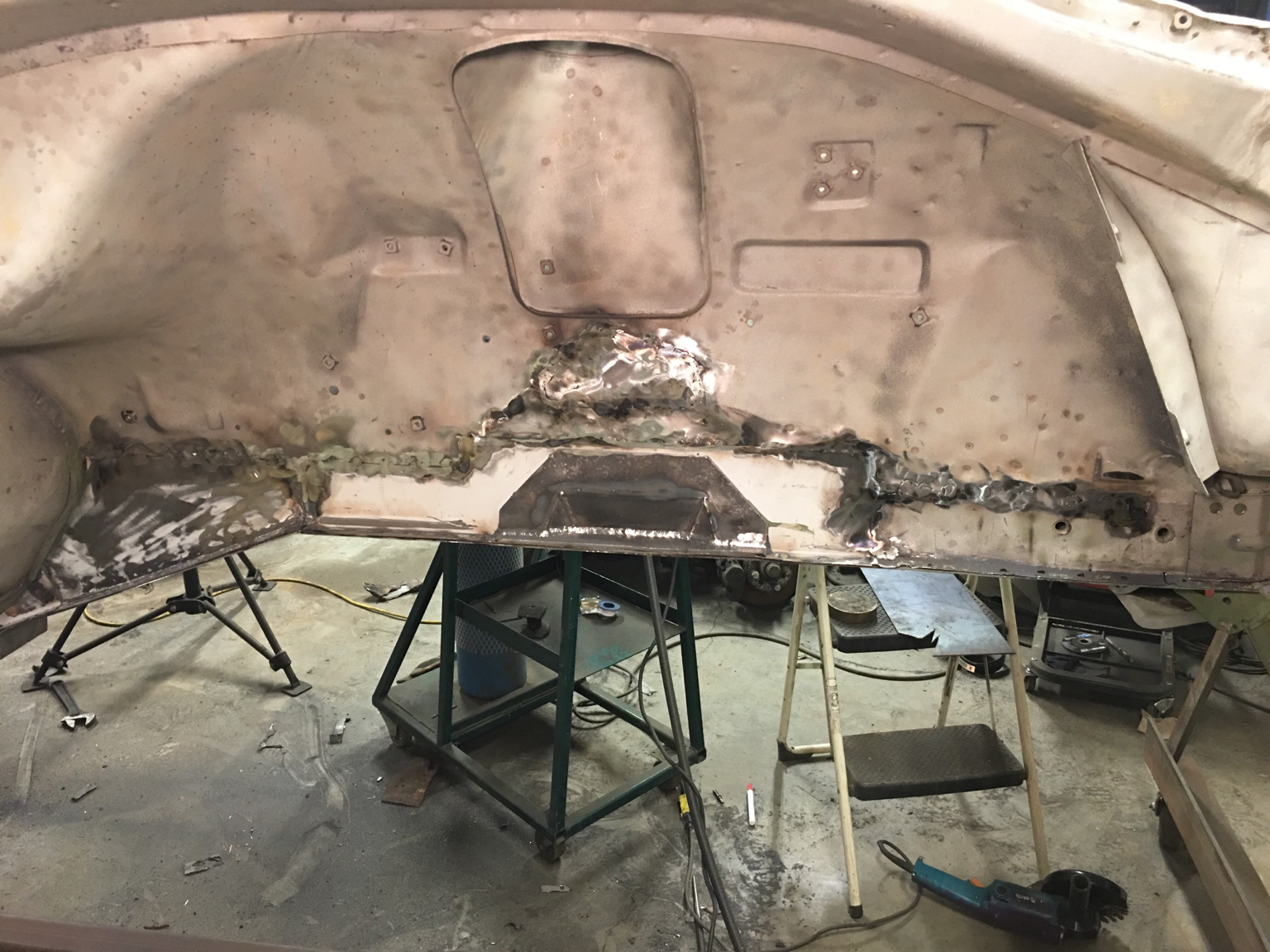

Minor update. Got the frame rail tacked in. Tacked the patch panels in place too. The pictures always look weird with the metal reflections looking bright then black etc. It will look so much better under primer. But that's later.

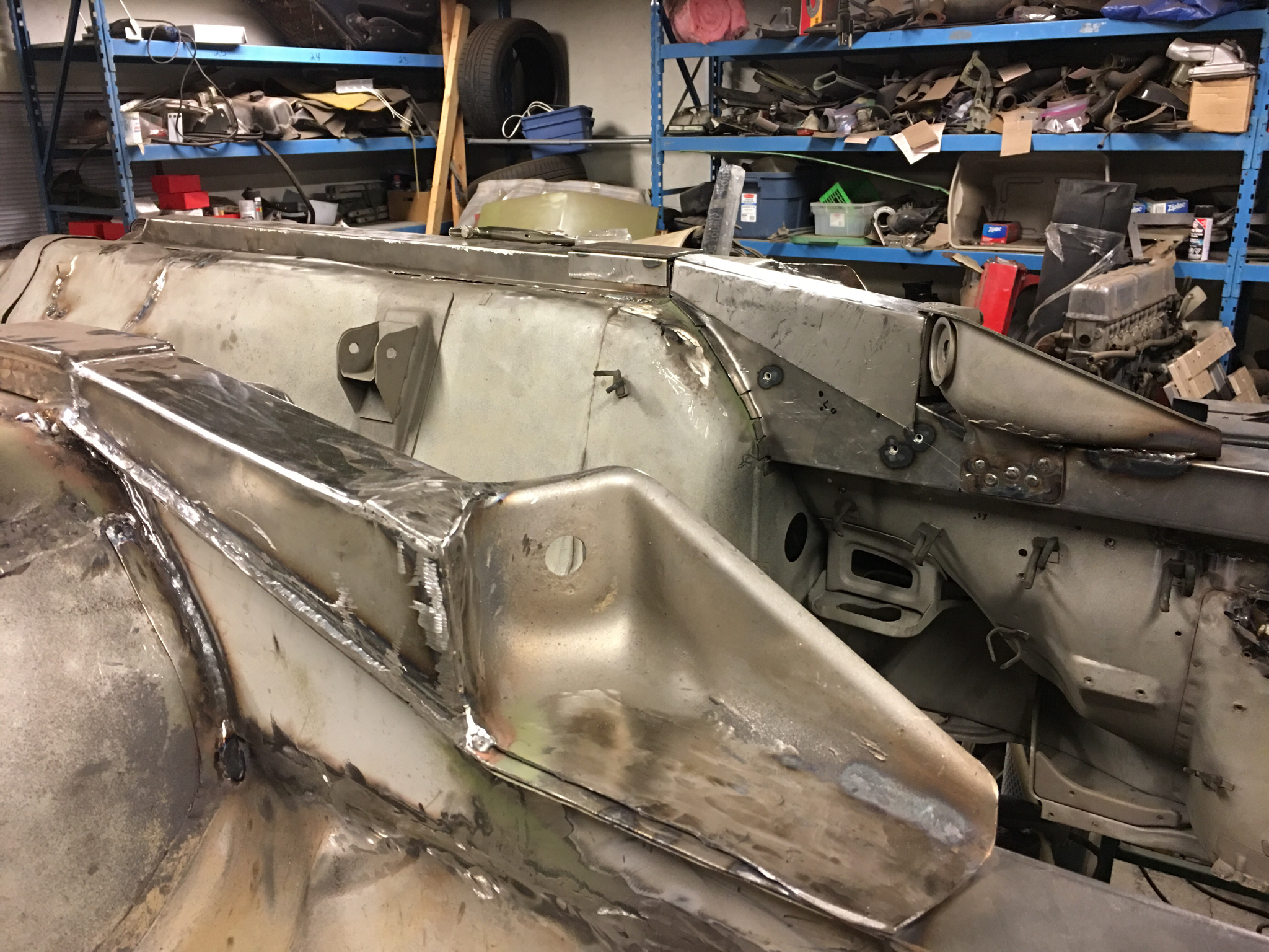

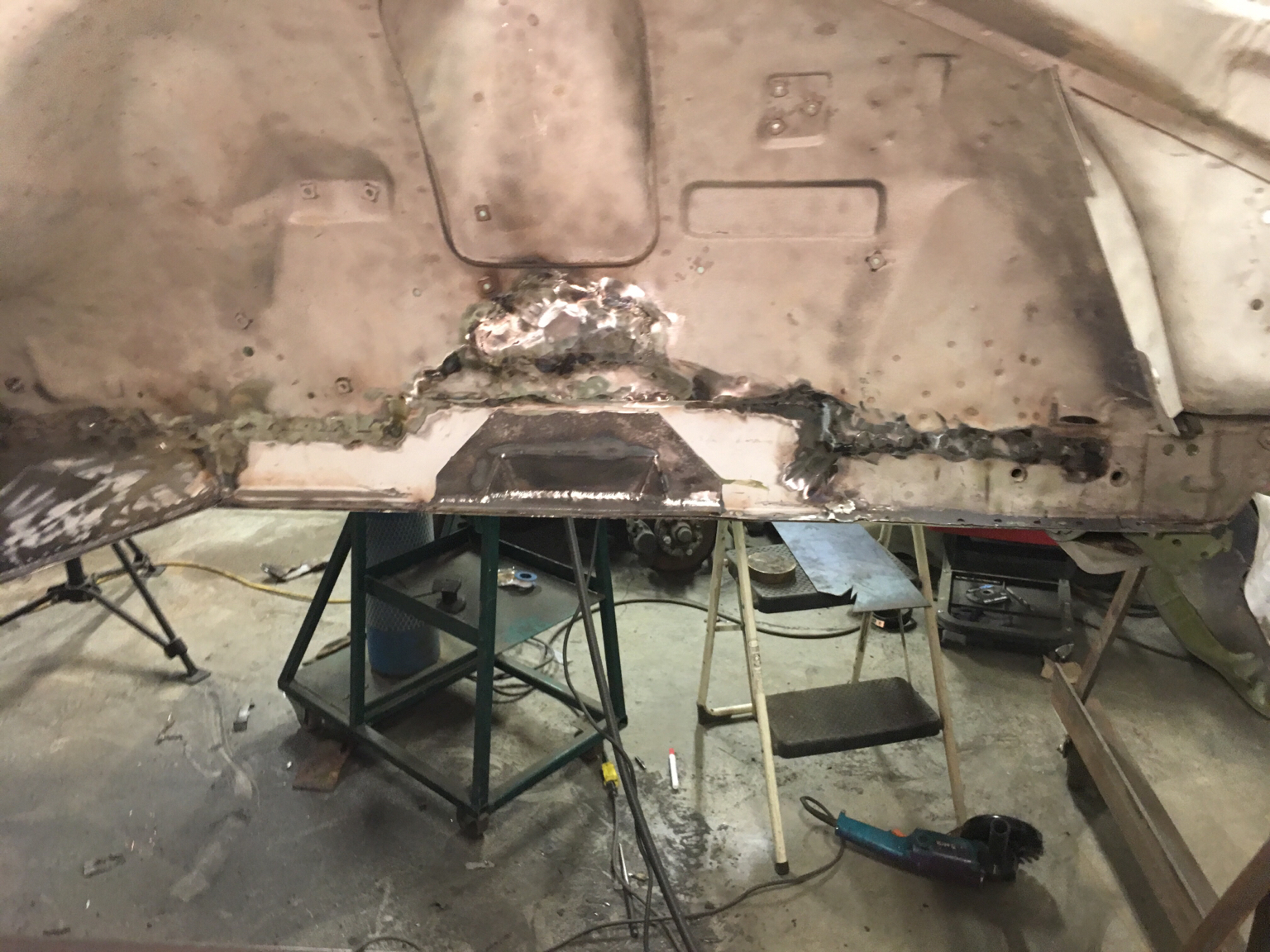

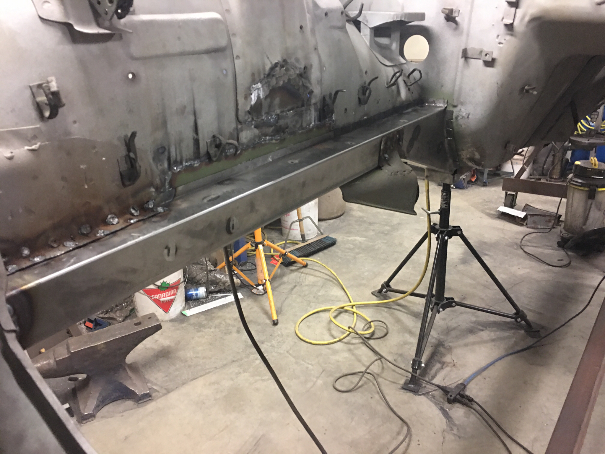

Much better day welding! Fixed the nozzle flow issue and re-welded the TC mount point. Started fabbing the brace for the passenger side frame rail and floor pan support. Initial work looks good. I think I'll call it a night!

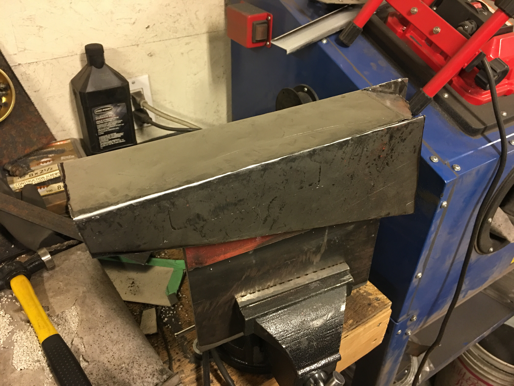

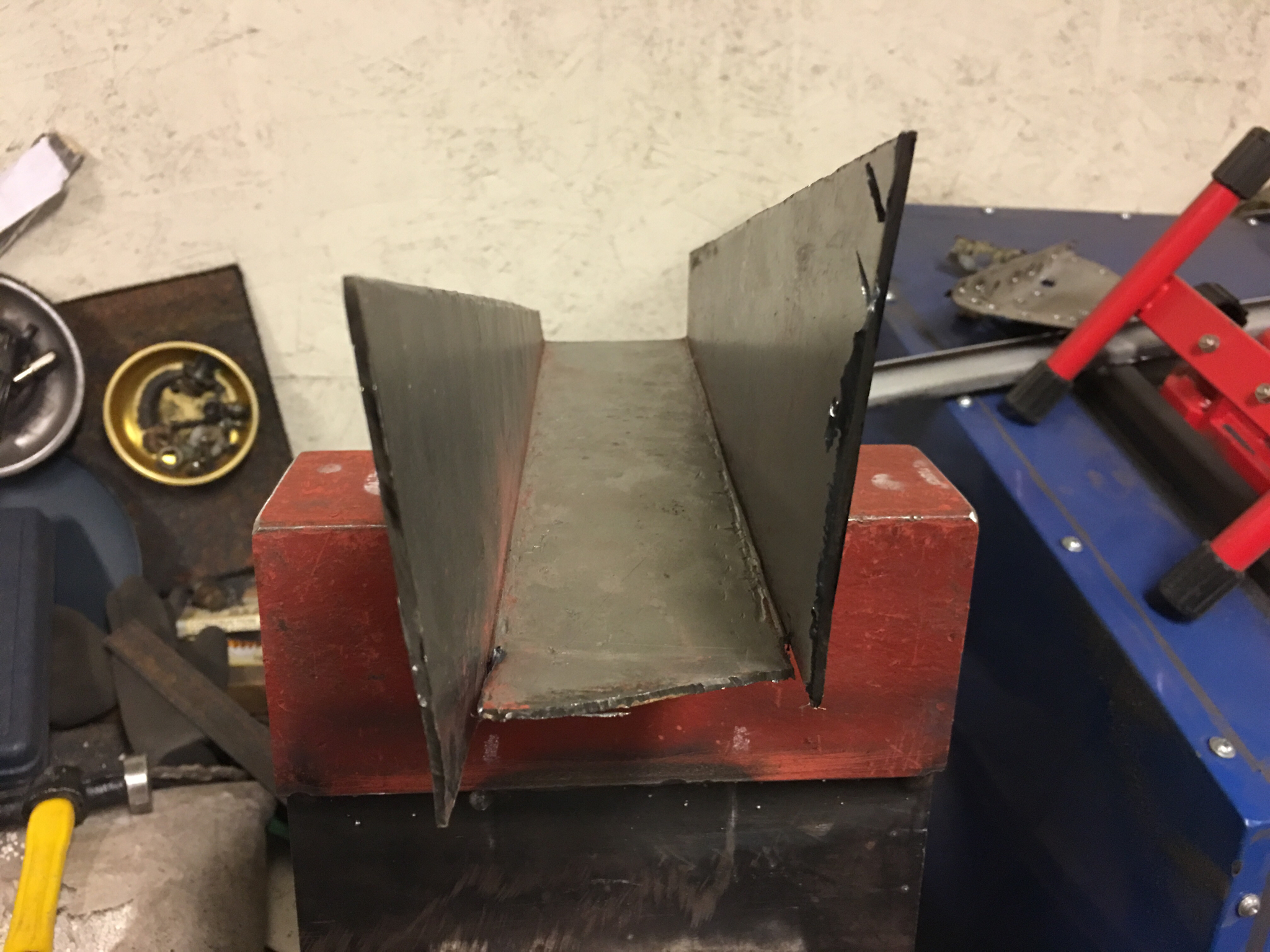

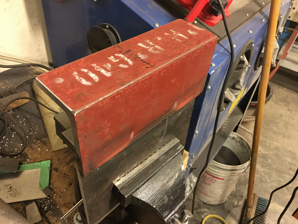

Actually quite boring. Hardened steel angle iron. 3/8" x 3 1/2" cut down to 2 3/8" so the 2 5/8" channel will fit over it easily. A piece of flat stock 5/16" plate welded under it for height clearance and clamping area in the vice.... pretty simple. The red corrosion paint is marked with an identifying number for the metal stock.
No armour from a tank if that's what you were hoping for LOL!
