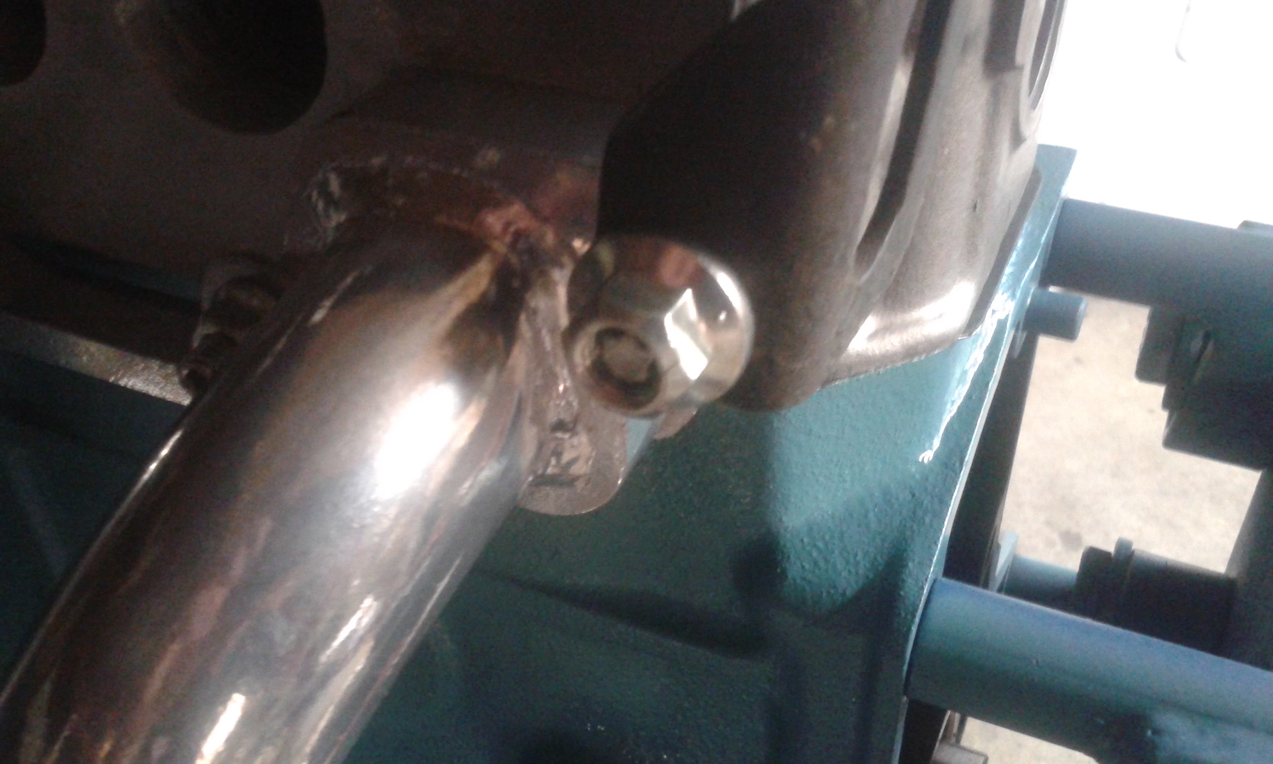

I need some ideas please!
I started fitting the header and rear slinger on and realized I do not have enough threads for my crimp nut to work.  Went to Nissan then Fastenal, no luck.  The guy at Fastenal suggested buying a M10-1.75 bolt that was long enough, hacksaw the head off and use it as a manifold stud.  He didn't have one in stock. :(   I'm using the M10 because that rear hole was wollard out and what I have is the longest Nissan has in that size, it's for their Titan 8 cylinder pickup.
Tomorrow I'm gonna hit the hardware stores and try and find one in stainless steel.  It needs to be about 2&1/2 inches long to bottom out in the head then attach the header and the engine slinger.
Do y'all think that's a good idea or should I find an alternative way of lifting the back end of the motor & transmission combo?
Thanks for any advice.  Here's what I have now;
If I had a nice-looking engine I'd only put the engine puller on when I was pulling an engine.  I don't even know why Nissan leaves those on unless it just makes factory assembly easier, they don't want to add a step, and they're inexpensive.  They're certainly not very attractive.  I'd install the engine then remove it and put it in a drawer.
If you are not going to retain the slinger after install, you could pull the stud & temporarily replace it with a bolt that is long enough to be secure.
When done, remove the bolt and re-install the stud.
Thanks guys, that makes perfect sense. That's why I didn't think about it, too simple!
I have removed the front one from my 280 after installed.
Another panicked brain fart from a gassy guy!
