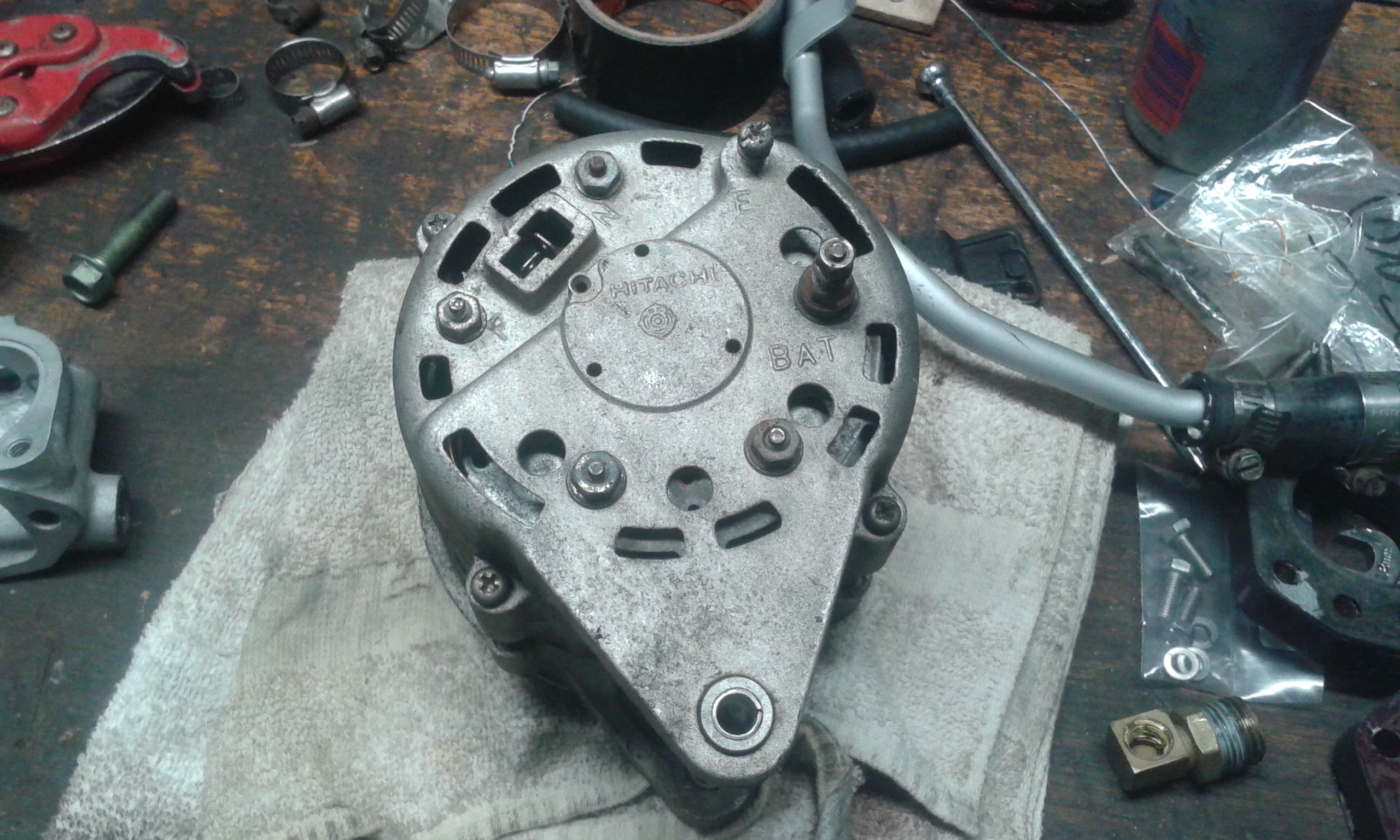

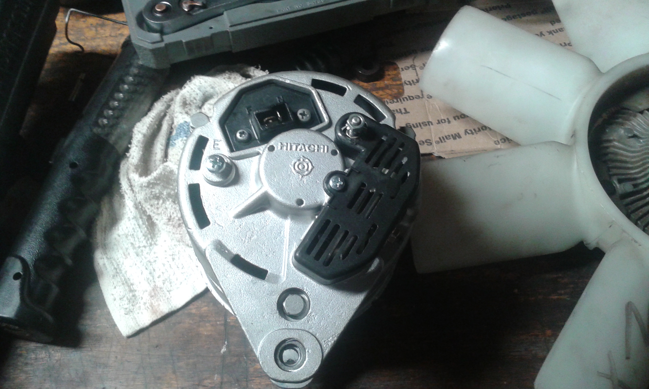

siteunseen Posted April 30, 2016 Author Share #368 Posted April 30, 2016 Here's the new one I took off and the old one I'm putting back on for now. Then I'm buying all Dave's stuff to modernize this old car. Link to comment https://www.classiczcars.com/topic/50909-72-240z-rebuild/?page=31#findComment-493925 Share on other sites More sharing options...
Zed Head Posted April 30, 2016 Share #369 Posted April 30, 2016 Those are both external. The F and the N of the "T" plug tell the story. Internal uses S and L. I'm using an ancient 1981 280ZX wrecking yard alternator on my converted system. My parts sore alt crapped out and never had much juice at low RPM. Link to comment https://www.classiczcars.com/topic/50909-72-240z-rebuild/?page=31#findComment-493927 Share on other sites More sharing options...
siteunseen Posted April 30, 2016 Author Share #370 Posted April 30, 2016 So if put the old one it's gonna blow the ignition fuse again? Link to comment https://www.classiczcars.com/topic/50909-72-240z-rebuild/?page=31#findComment-493929 Share on other sites More sharing options...
Zed Head Posted April 30, 2016 Share #371 Posted April 30, 2016 Actually, it doesn't seem like that would be the cause of your problem, but I don't know for sure. The L wire would be running to F or N which might be a short and pull enough through the Lamp to blow the fuse. The S wire might be doing the same but that should happen as soon as it's plugged in. CO, SteveJ, or Dave might know the circuit well enough to say. 240Z circuits are bit odd. Either way, you'll need a ZX alternator to use with Dave's ZXP plug. You could just get the right one and try it. Worst case you waste another fuse. Link to comment https://www.classiczcars.com/topic/50909-72-240z-rebuild/?page=31#findComment-493930 Share on other sites More sharing options...
