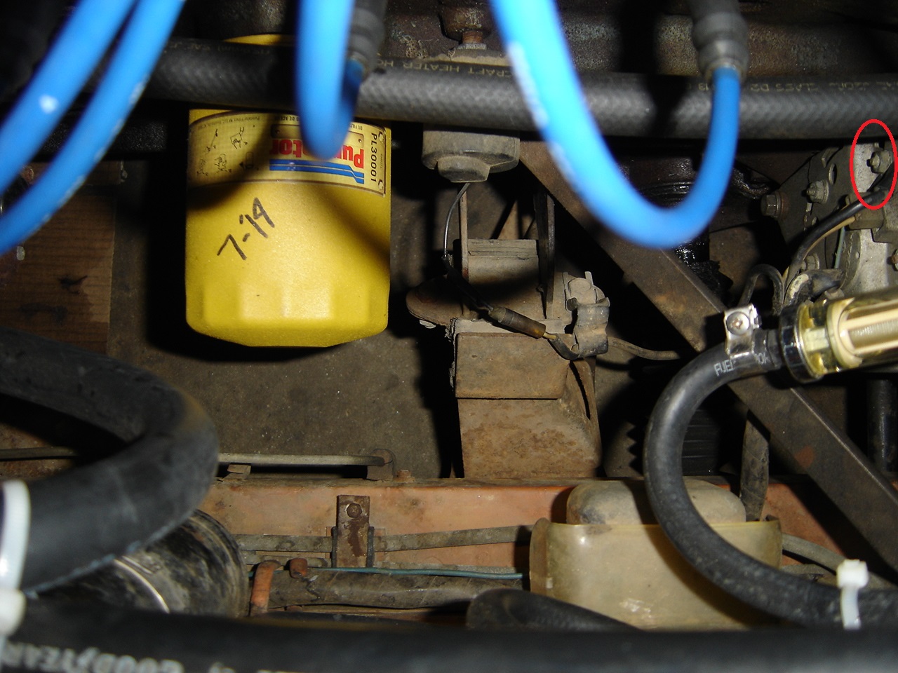

siteunseen Posted April 30, 2016 Author Share #381 Posted April 30, 2016 I found a pre tear down picture and it really is connected to the F post. Maybe @Zs-ondabrain can tell me why. You can see it's to the left of the horizontal part of the T connection. Link to comment https://www.classiczcars.com/topic/50909-72-240z-rebuild/?page=32#findComment-493947 Share on other sites More sharing options...
Captain Obvious Posted April 30, 2016 Share #382 Posted April 30, 2016 That's not ground on the F connection. That's ground on one of the bolts that hold the two halves of the alternator together. The "F" label refers to the connection in the T connector, not that bolt head. They just put the label very close to the bolt head so you're thinking it' related. It' not. That bolt head is ground, but ground should really be connected to the "E" screw though. Link to comment https://www.classiczcars.com/topic/50909-72-240z-rebuild/?page=32#findComment-493948 Share on other sites More sharing options...

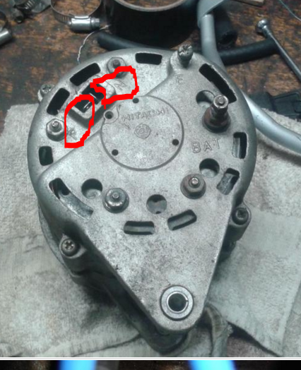

Zed Head Posted April 30, 2016 Share #383 Posted April 30, 2016 (edited) We have a Cool Hand Luke situation here. F and N are the T plug terminals. You circled what could be used as E, for ground (the whole case is grounded). So that would be right. I would take the T plug off and measure resistance to ground from each female pin. Maybe you pinched a wire or have a short in your regulator. Then you could also measure power there with your meter, and the key On. Edit - added an F and N picture. Edited April 30, 2016 by Zed Head Link to comment https://www.classiczcars.com/topic/50909-72-240z-rebuild/?page=32#findComment-493949 Share on other sites More sharing options...
