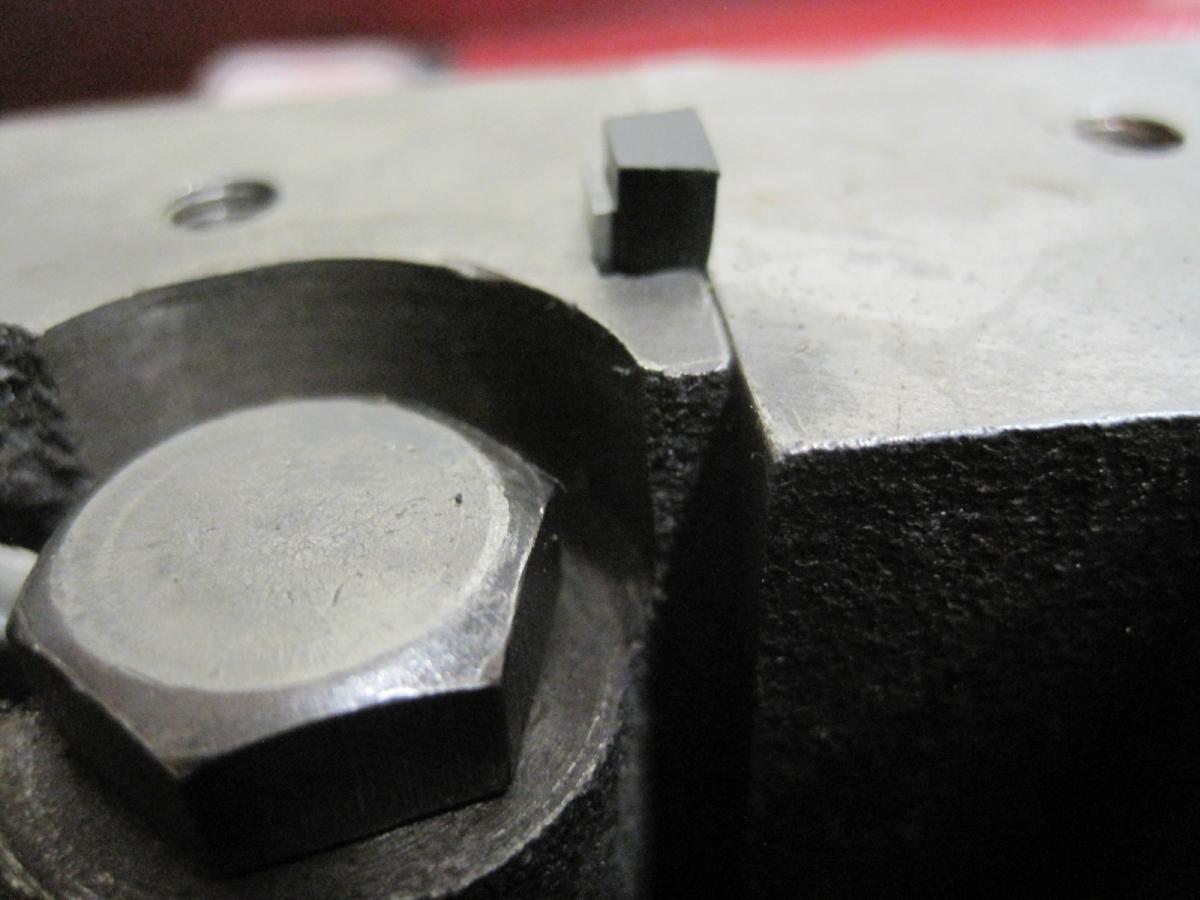

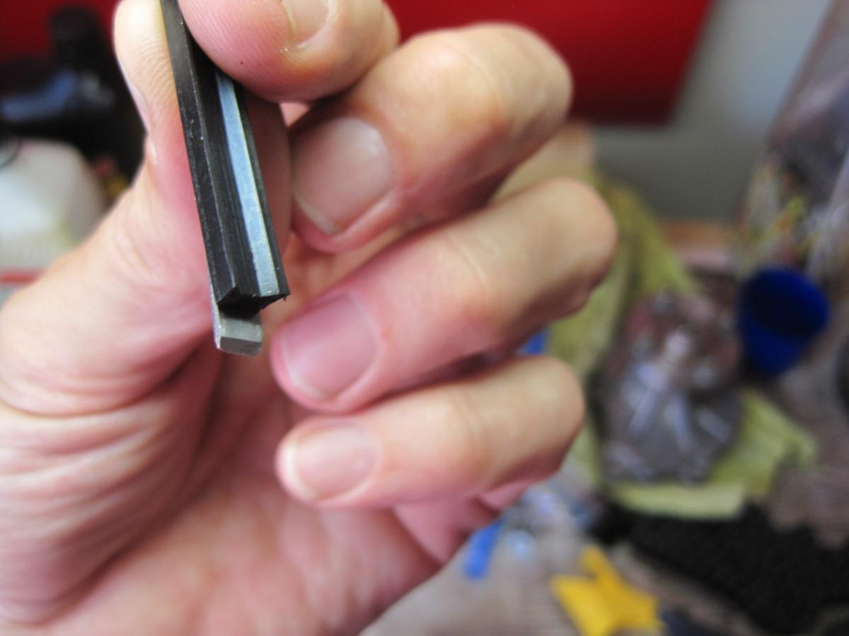

Getting some stuff done, but need some verificaion. Ready to put rear main side seals and I need to be sure so this doesn't haunt me. See pics.
"lips" to the block side, and stake to the crank side. I also noticed that the rubber seal has a slight taper to it. It definetly when in one way easier then the other. Not easy to see, but easy to feel.
Isn't this described in the How To Rebuild book?  With some other tips about added sealant on the corners for insurance.
