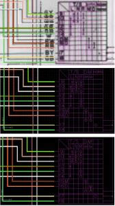

What software are you using to trace. I started tracing, but found it was not so neat as I wanted. Ended up using the original as a tamplate in AutoCAD. With EndSnap, Grid and Polylines its easy to connect the parts and everything stays neat and tidy. I know DraftSight from Dassault systems works very similar to AutoCAD, but its lousy in Paperspace. NanoCAD works good in paperspace, but not so good as DraftSight in other areas.
Here are some screen shots in stages. Background JPEG, Grid on & Grid off.

Here is a little update, still messing around with the layout a bit. moving things around to get a better fit with the wiring spaces. Ill add the colour key later.

You may wish to consider thicker wires so that two-colour wires can be seen at further zoomed-out views. Thicker wires may also help in reading printed versions too!

Blue, thanks for the input. I was coming to that conclusion too. The line weights are ok on A1 format prints, but if you drop it down to A3 the detail is lost.
I want to get it so you can print it on A2 or A3 and maybe make a 4 piece drawing you can print on 4x A4's and tape them together to make a A2 drawing.
Ill play with the line weights tomorrow.

I increased the line weights by 100% (Scale factor 2). See what you think, I can quickly adjust it if they are still to thin.
Tomorrow Ill divide the schema into 4 A4 and see if it prints ok.
