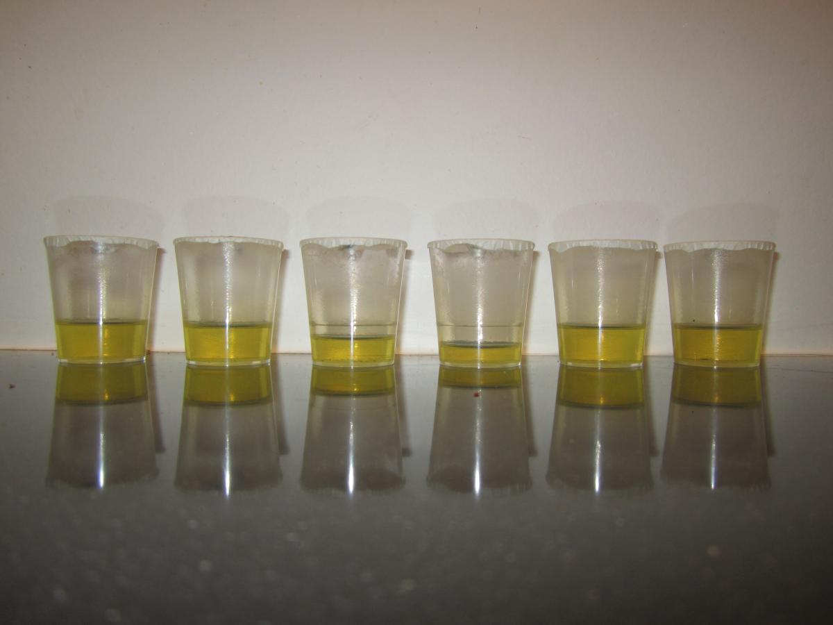

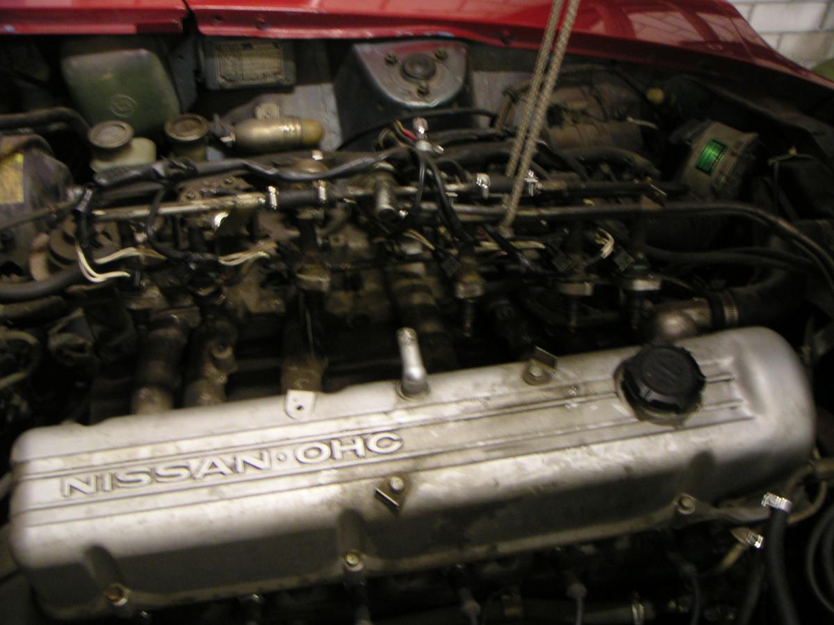

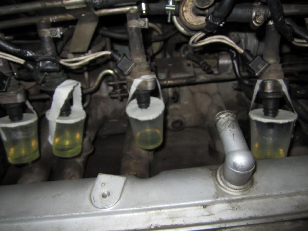

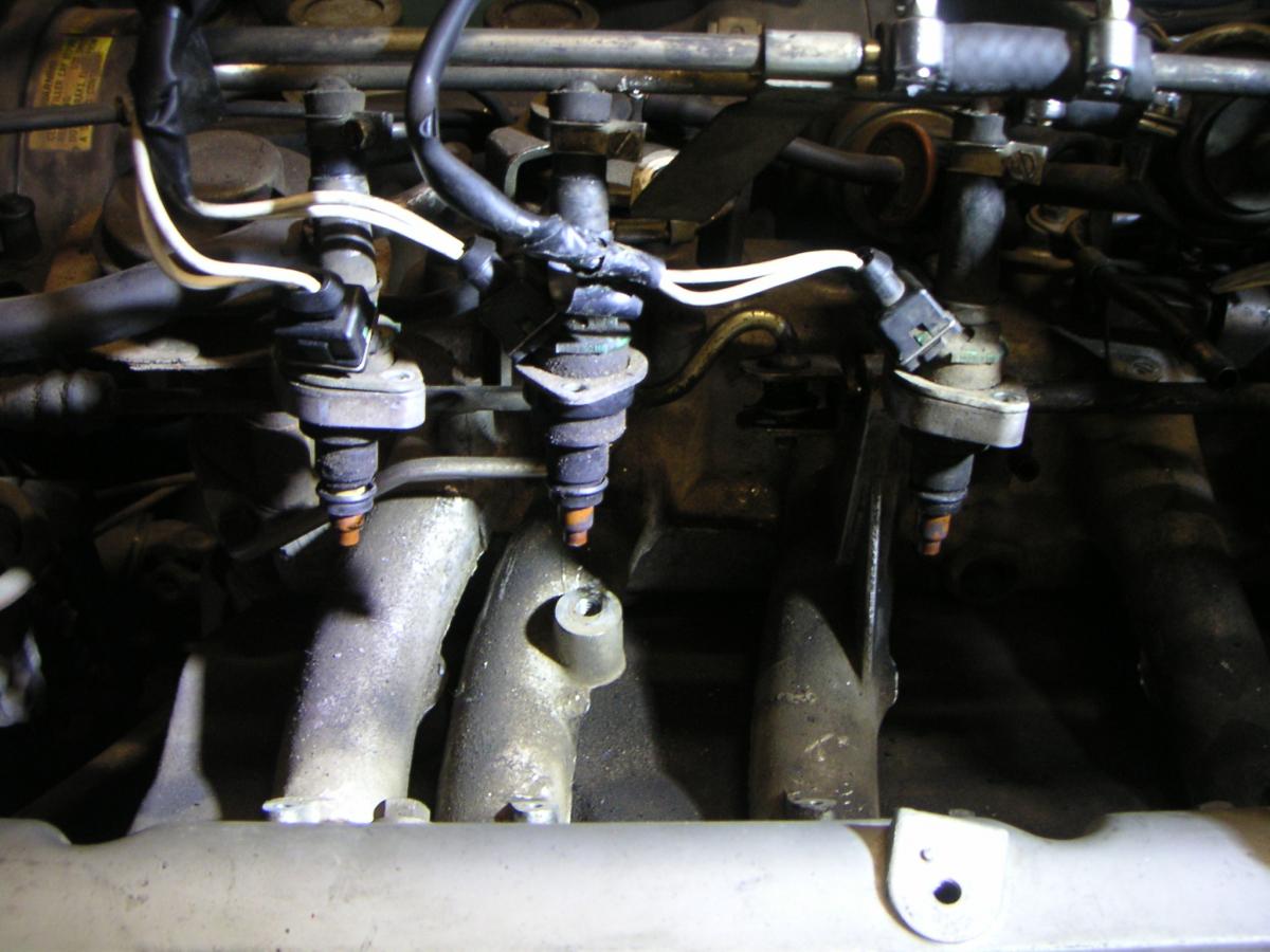

I had a problem with to lean cyclinders a couple of years back. I did a simple (ans I mean more crude than simple) test to see if the injectors were the problem.
Basically I removed enough of the mounting fixtures so I could get the injectors and fuel rail up high enough to see the tips clearly.
Then I found some plastic cups from a local store "Action" (what you could call a $2 dollar shop) and strapped them onto the injector tips.
Removed the spark plugs, rigged the AFM open and cranked the engine for about 20seconds. I didn't go to long on the starter. Didn't want to burn it out.
It was enough to see number 4 was amost blocked, number 3 partly and number 2 was maybe a small amount. See last photo: left nr 1 to right nr 6.
After that I reverse flushed them with a long hose full of fuel mixed with injector cleaner, air compressor and a 9 volt battery to trigger the injector. Kept repeating the flush until they where all flowing ther same amount in a beaker.
Good luck finding you problem. If you need more photo's or info let me know. Glad to help.
Chas

Chas, you may have just helped me change my mind and check flow of my injectors. I was thinking about it yesterday while my wife and I were hiking in the Los Padres National Forest. That was loads of fun BTW.
I was just thinking that I may as well check flow also because I'm going to have the fuel rail off of the intake. If I'm that far into it I may as well check everything. On your cups, what did you use to seal the tops? Is that some sort of tape?
And did you remove the cap and rotor from the dizzy so there was no spark?
