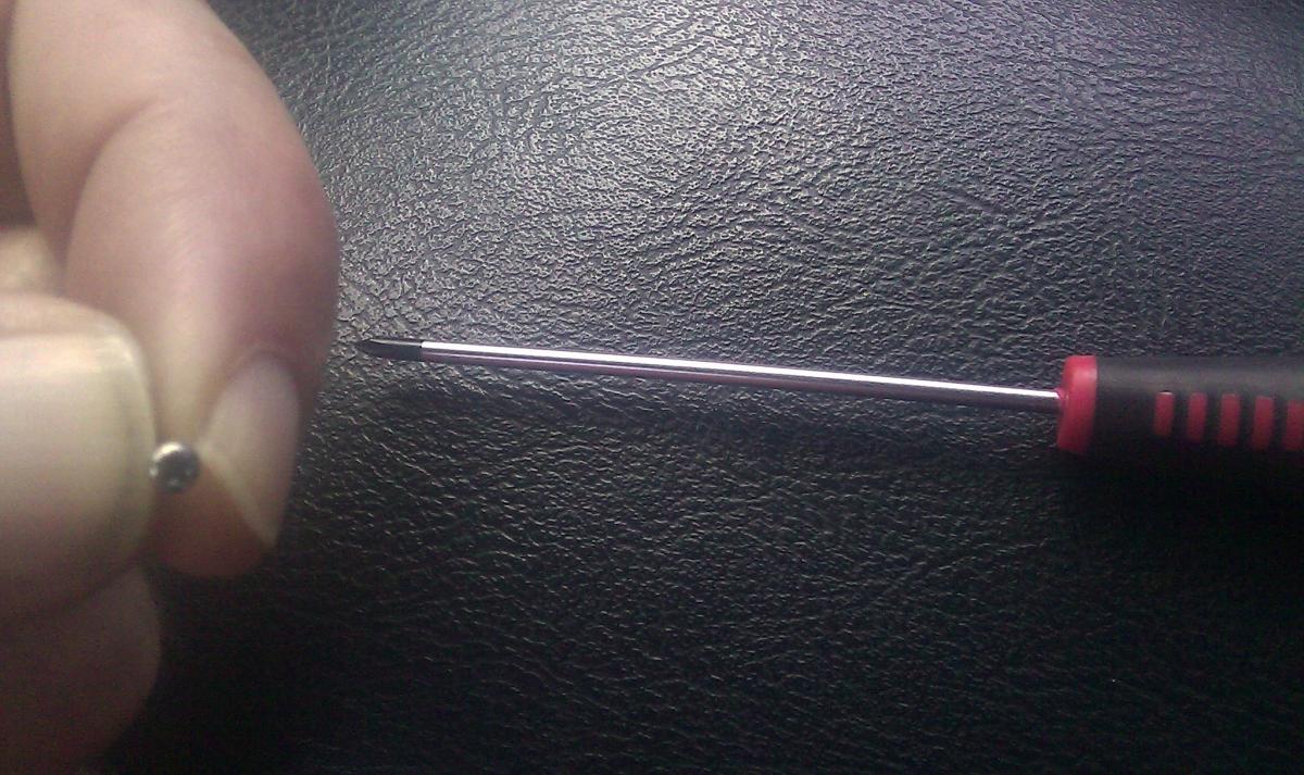

Dulled the sharp tip of my 00 phillips screwdriver, and the little JIS screw backed right off.

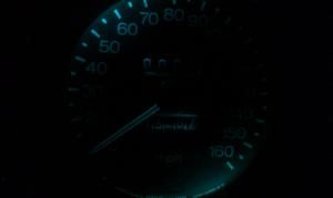

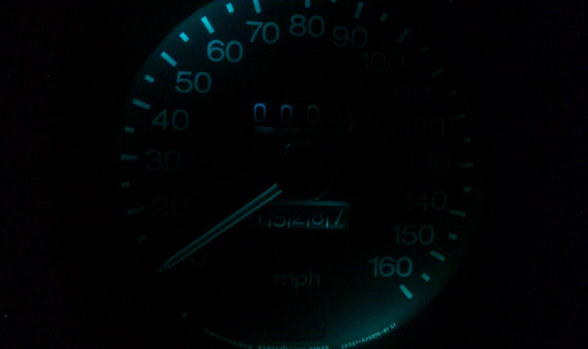

Speedo & tach lighted much, much better, took a quick not so great pix, the cam does not pick up all the lighted dial.

Excellent. I love it when a plan comes together. Good thinking on the cable re-route to make future work easier. I should have done that too.
