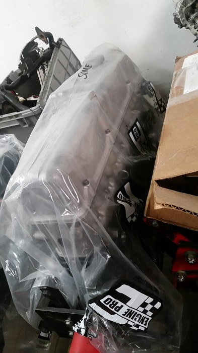

Got a call from A buddy of mine today. He was having some interior work done on his '78 Volvo and saw Rebello Racing across the parking lot. He dropped in and dropped my name and Dave said he had been trying to reach me. When Mike said that, I realized I had forgotten to tell Dave when I changed my number! Yikes!
Anyway, the engine is done. It will take while to outfit it with its EFI stuff before it is fired, but progress!
