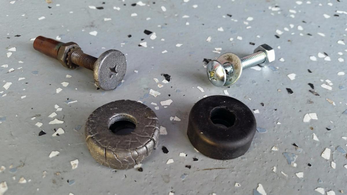

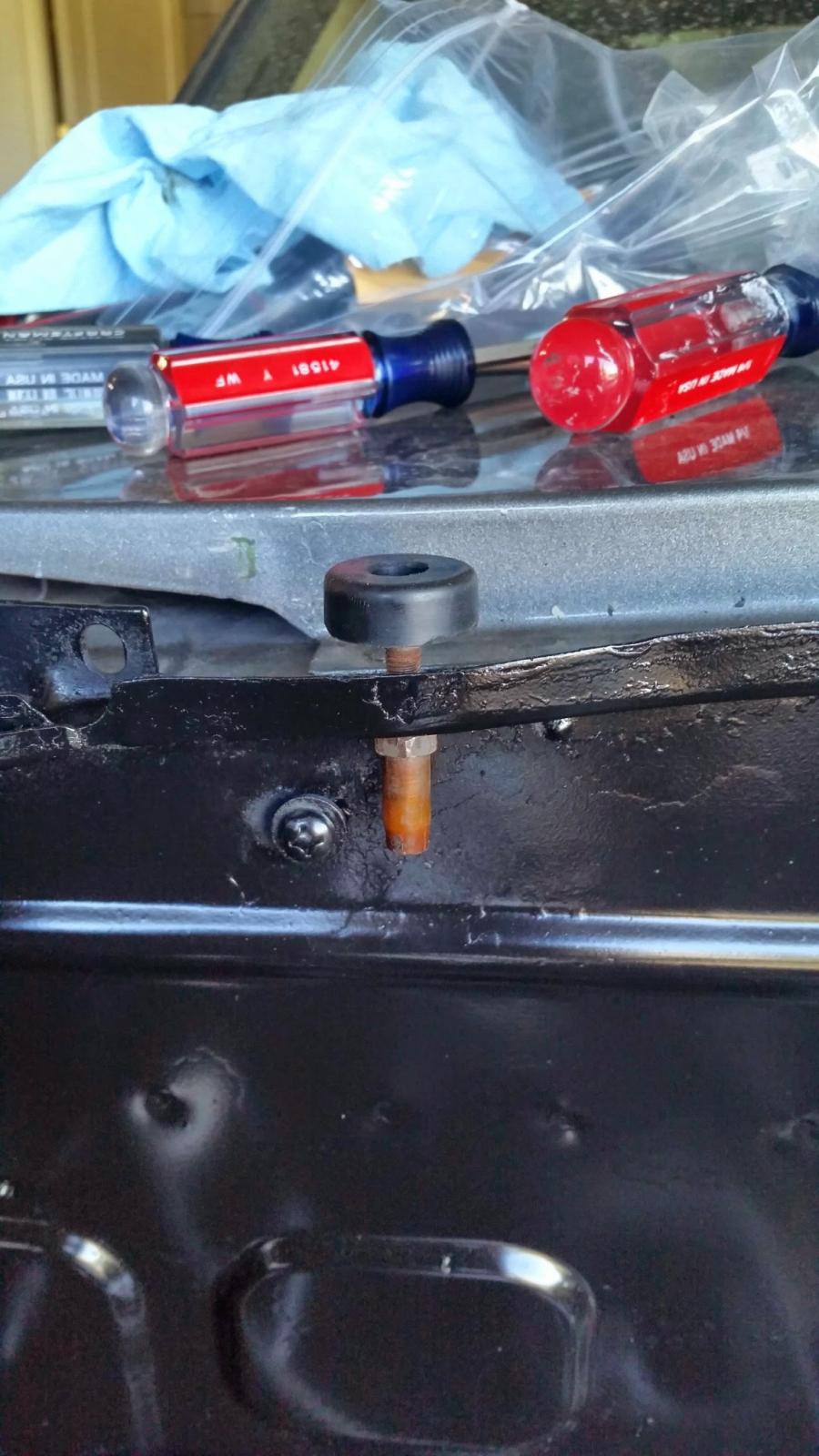

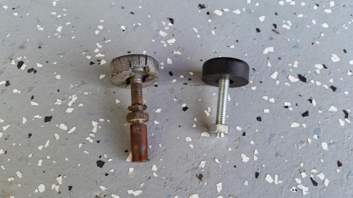

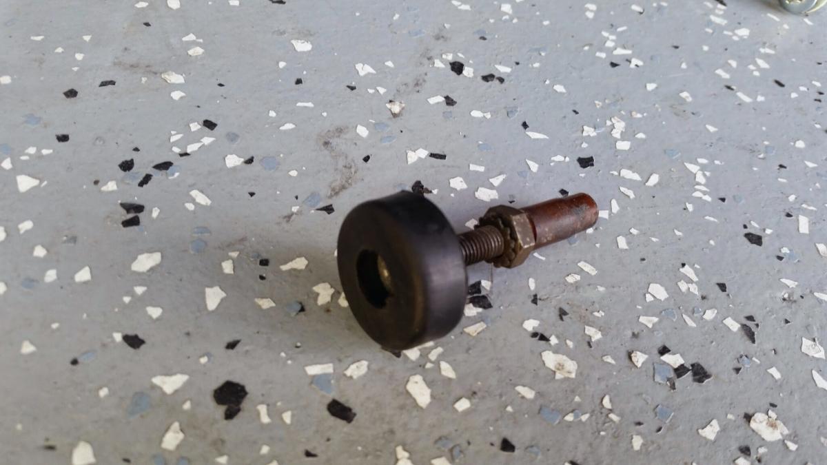

I ordered a set of hood bumpers for my early 260z from Black Dragon and a bunch of under hood rubber bits to go with them.  I was disappointed to find the hood bumper bolt was a standard phillips machine screw, and i was more disappointed to find that it was an SAE thread which did not match the car.  On the plus side the rubber bumper looked to be the right size so I was able to put that on my old hood bumper.  All said and done i got enough parts to get what I needed done but it sure missed my expectations.  Attached are a side by side pic of the old and new, a pic of both with the rubber removed, my hybrid assembly and finally the finished installed product.

I just ran into the same thing with the BD hood bumper screws. I did the same thing you did by just transferring the rubber bumper to the old studs. However, that's the first problem I've had with their parts......for the most part, they are an excellent supplier.
They were around $6 each, and came out of a sealed package.  Additionally i ordered the replacement nut and it matched the hoaky hood bumper SAE threads and not the stock parts so they know whats up.
I ordered about 15 other rubber bits for under my hood area and they all looked like great parts as well as all of the other parts i have received from BD in the past.

The stock hood bumpers are SAE 1/4-28 thread. Yup it's true.  This is just 1/4 NF thread, easy to find nuts to match. Seems Nissan had the same hard time finding these in Metric back then and relented to an SAE piece from who know where.
MSA's replacement uses a M6x1.0 bolt with a flat head at least, closer. You can tap the welded nut  to M6x1 and thread it in (its a tad loose), using a matching nut underneath to lock it in place.
