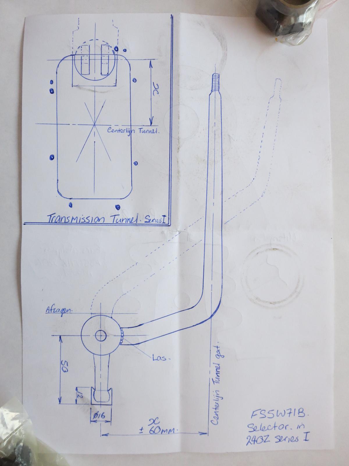

An alternative is to use the B transmission and install a competition S type shifter or cut and weld the existing shifter. There are drawing floating around on how to do this, but the main idea is to get the shifter about 60mm back from anchor point so it clears the tunnel in 1st and 3rd.

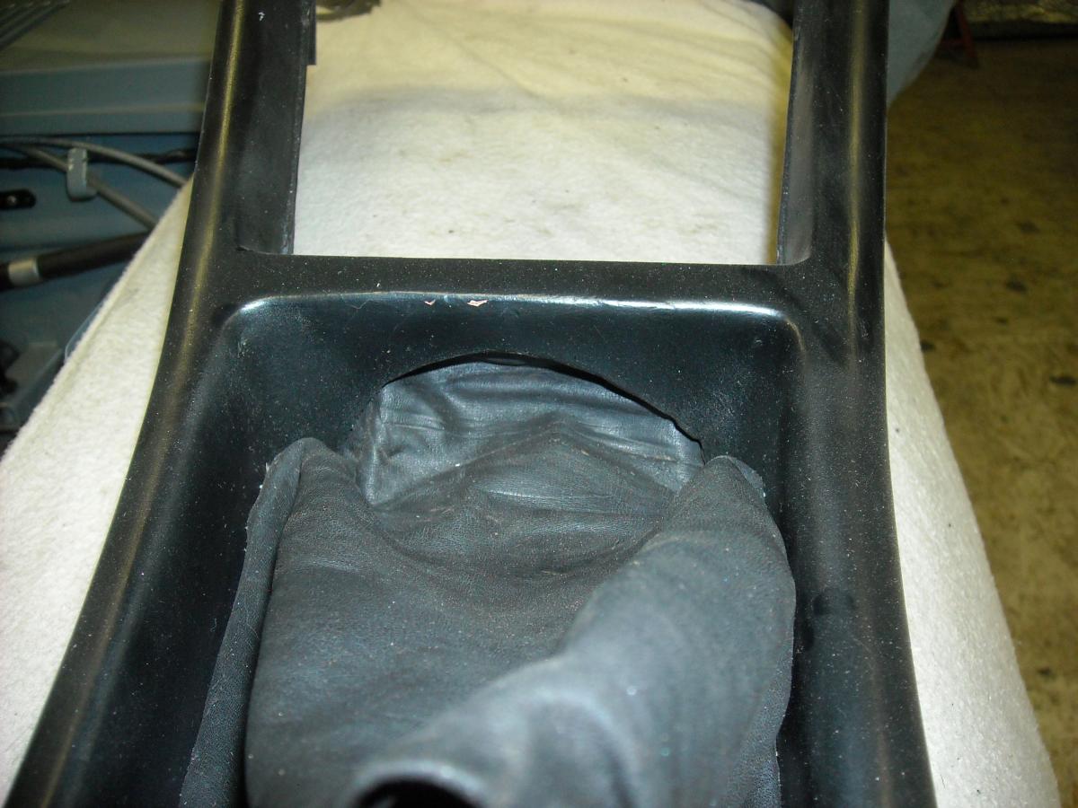

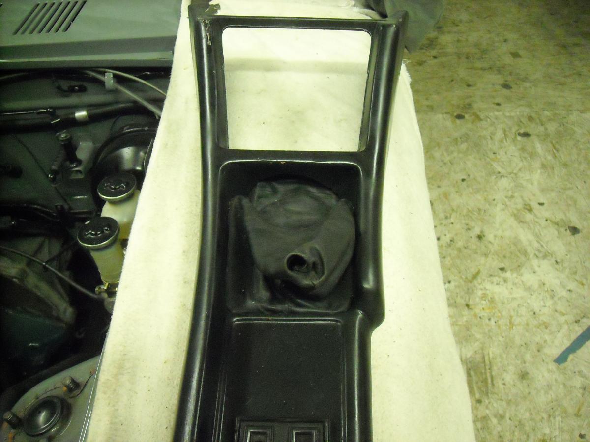

Richard, when I replaced the original 4spd with a F4W71B 5spd in my early 240z I found I only had to remove about 5/8" on trans tunnel sheet metal on the forward most edge of the shifter hole for the the 5spd tranny to clear it. Then I added 5/8" on to the back of the shifter hole so I could re-use the stock shifter seal boot.
This is one of the most popular mods that are done to these cars so there should be lots of documentaion in the archives.
On the shifter console I found I only had to remover a semi circle notch to keep the shifter from hitting it in
1st, 3rd and 5th.
Chris

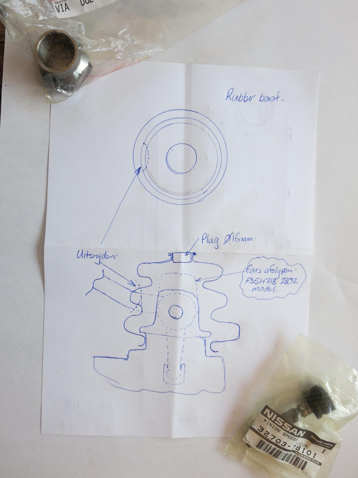

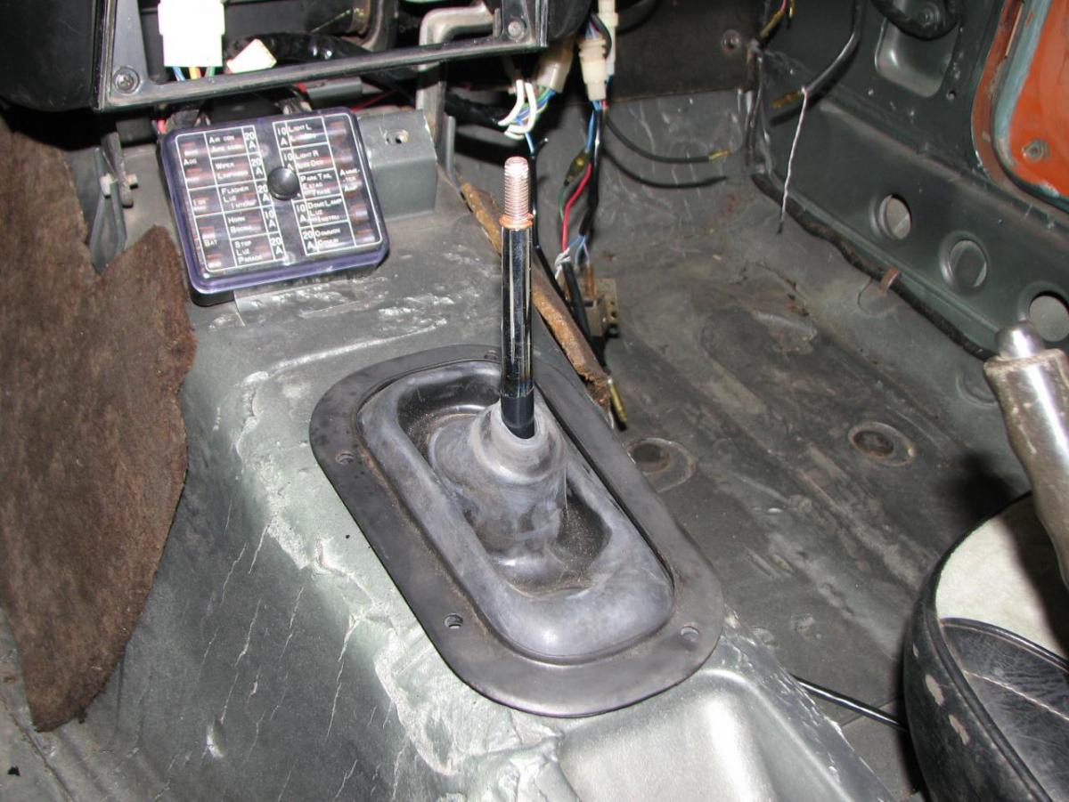

Chris' method would be the simplist and quickest way to fit the 71B, but if you don't want to cut the console you can consider this method.

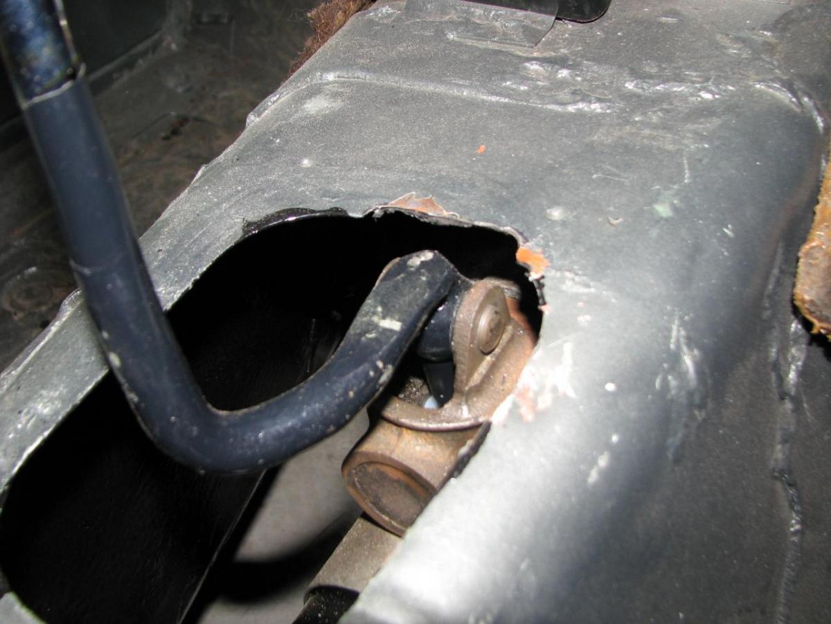

I found some photos on the web some time ago. You can see how he cut and rewelded the shifter rod.
A friend did this to his, but we welded it on the back position to make sure it had enough room above the shifter rod. You can see what I mean in the photos and the sketch we made.
A word of advice if you choose to do this: Cut the shifter rod off. Mount the bottom section back in the selector mechanism with the transmision in 2nd or 4th. Tack weld the shifter in place so it clears the striking rod guide. Then remove it and weld it fully..
We found out the hard way. Its was hitting guide and wouldn't let it go all the way into 2nd and 4th. After cutting it off and rewelding it again at a slightly higher position on the ball the problem was solved.
This also makes the shifter shorter and the through is shorter.

post-25317-0-99604700-1427301249_thumb.j
post-25317-0-48561500-1427301263_thumb.j
post-25317-0-03304400-1427301291_thumb.j
post-25317-0-62479200-1427301310_thumb.j

Not entirely sure which way I'll go, but I think I'll take a copy of the drawing Chas provided, along with a shift lever to my friendly local machinist and see if he can doe something like that.

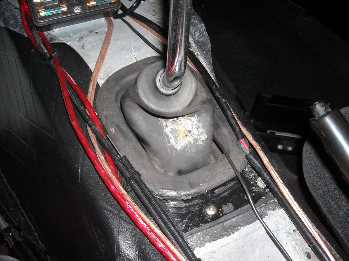

The shifter in post #4 has not been cut and rewelded. I used an oxy/acetylene torch to heat it and bend it. Once I got it close I heated it up again and flattened it out on the top. I probably didn't need to trim the couple mm's of sheet metal and I did not modify the console at all. This method takes a little bit of patience. Heat it then bend it and test it the do it again and again. While your bending it, keep a bolt in the pin hole so it doesn't get distorted. I have put plenty of miles on it and never had a problem. It's not hard to do. You just need patience and a hot torch. Good luck.
Brian
Hi Brian, I can't remember where I found the photos, but I like the way it was done so I saved them. Nice to know it possible to modify without welding.
We opted to cut and weld to get the extra clearance. It had a new transmission mount which pushed is very close to the tunnel. He also had the guide with the extra long ears, which needed grinding down for clearance and described in the second sketch.
With some modification we managed to fit the rubber boot. It needed a cable tye to hold it on the guide flange, but it seals it well.
It worked well until he sold the car and the new owner rolled it into a ditch
Did you fit the rubber boot when you finished the modification?
Chas
Because the leather wouldn't stretch anymore, also I have the leather boot pulled way back to get the pic,
normally you can't even see that semi-circle cutout.
I had 3 consoles to choose from so cut up the worst one then spent far too much time making it look good again.
Chris
Chris.....Just wondering......why not put a couple clips in the new cut out area to finish off your cut out more? I like both of your solutions......just find it hard to cut the console of a Series 1.
Chas, I was unable to get the original style boot to fit. I had to use the boot from a 73. The clearance is tight but in that picture the transmission is in 1st or 3rd. I didn't want to worry about my weld breaking if I did it that way. Good welders wouldn't have a problem though.
