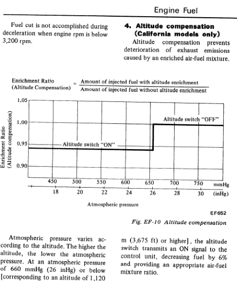

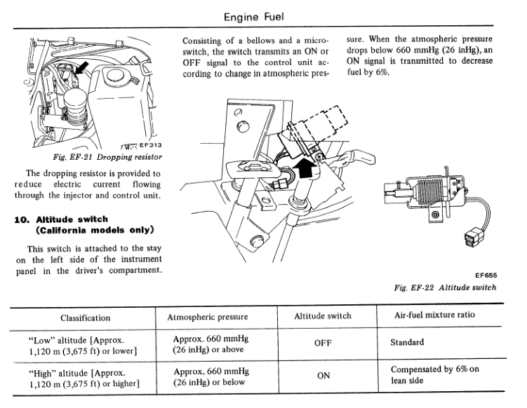

Just a thought.  You might also consider what Fast Woman suggested on mjr45's thread about poor gas mileage, if you have the altitude switch ECU (California model).  I've looked at it myself.  Shorting pins 9 and 12, or the switch itself if you have it, should drop fuel usage by ~6%.  You might even be able to just stick a pencil or stick of wood in to the switch and make it activate.  All stock parts!
If I was in your shoes, I'd try the altitude switch first.

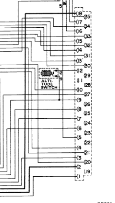

Edit - actually, and I think that Fast Woman suggested this (sorry, I didn't read the details of all of the posts in that thread), you might be able to fake out the ECU by adding a parallel resistance on circuit 9, as show in the diagram.  It would be nice to know where Pin 12 goes, if it's just a low resistance path to ground or if it is actually part of an important circuit.  Anybody got a CA ECU they could check (maybe I do and just didn't know it - anyone know the serial numbers?),
Regardless, if you have the CA ECU, you're set.  Easy to try.

Actually, the altitude switch should be super-easy.  First, unplug the switch.  Then measure resistance across the switch terminals while sucking on whatever ports/holes are on the switch.  I'll bet you get OL or open circuit normally, and zero or very tiny resistance while sucking on the port.  If the switch is already very low resistance though, there's not much you can do, it's already activated.
After confirming very tiny resistance when sucking on the port, just run a jumper, or short circuit across the two pins in the wiring harness.  This will trick the ECU in to thinking it's at high altitude and cut fuel 6%.  Or, figure out how to manually actuate the switch, plug it back in and do that.
The key is that the switch be just a switch.  Full open or full closed, open or closed circuit.  If it is, you can't hurt the ECU by shorting the pins in the harness.
Either way, it would be good to know if the switch is just a switch or if it has some designed in resistance.  If you could measure that, I'll find a way to short my own ECU's just to see what happens.  I have spares.
Yeah, while you're there.
If you could measure resistance across the wire harness pins, the connector, that would tell something about the ECU also.  Basically, I could tell if I have an "altitude switch" ECU.  I measured three of mine and got differences based on part number but have no idea what the differences mean.  Also learned that the ground pins in the ECU are not also grounded to the body of the ECU.  They come through different paths.
