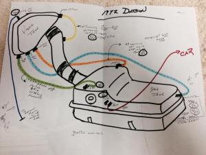

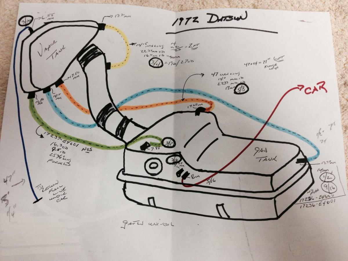

Somebody tell me how I screwed this up, but the car ran perfectly (until I pulled the motor) and I had no fuel smell.  Using this diagram graciously made by Travel'n Man:
  • removed the vapor tank completely
  • discarded green hose, capped vent on tank
  • discarded blue hose, capped vent on tank
  • discarded yellow hose
  • connected orange vent on tank to yellow vent on fuel filler
By "discarded" i mean "allowed to disintegrate after touching".  I kept the vapor tank just in case but i cant say I've missed it.  This is how the fuel venting works on dirt bikes and the few classic vehicles I have worked on that existed before emissions regulation existed.
How is your tank vented if you capped the vents?  I am trying to do the same.
This guy's vents through the filler neck it looks like, http://www.classiczcars.com/topic/17542-treating-insideoutside-of-gas-tank-with-por15-products-and-removing-evaporation-tank/
EDIT:  It's the same as KurbyCar after I looked.   :blink:
