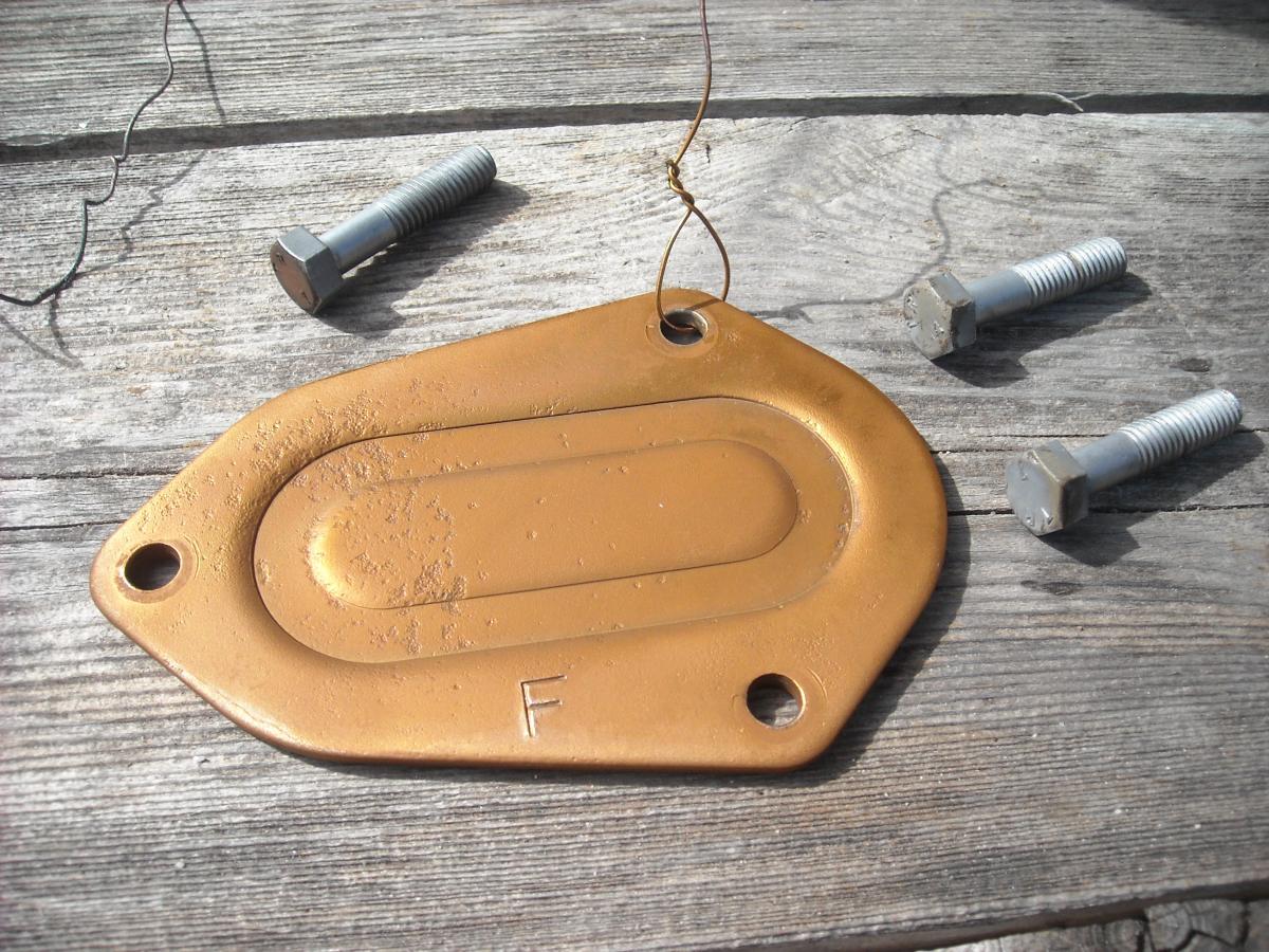

Vinegar and Epsom salts are the electrolyte, the plating solution.
Muriatic acid as a prep solution. Amount of time in the yellow chromate is something you have to watch carefully, it is sort of dunking for a few seconds then pull out to see if the colour is right yet.
It's easy to go too far,(see pic) and when you do you have to start again at the muriatic acid stage and move to plating again.
