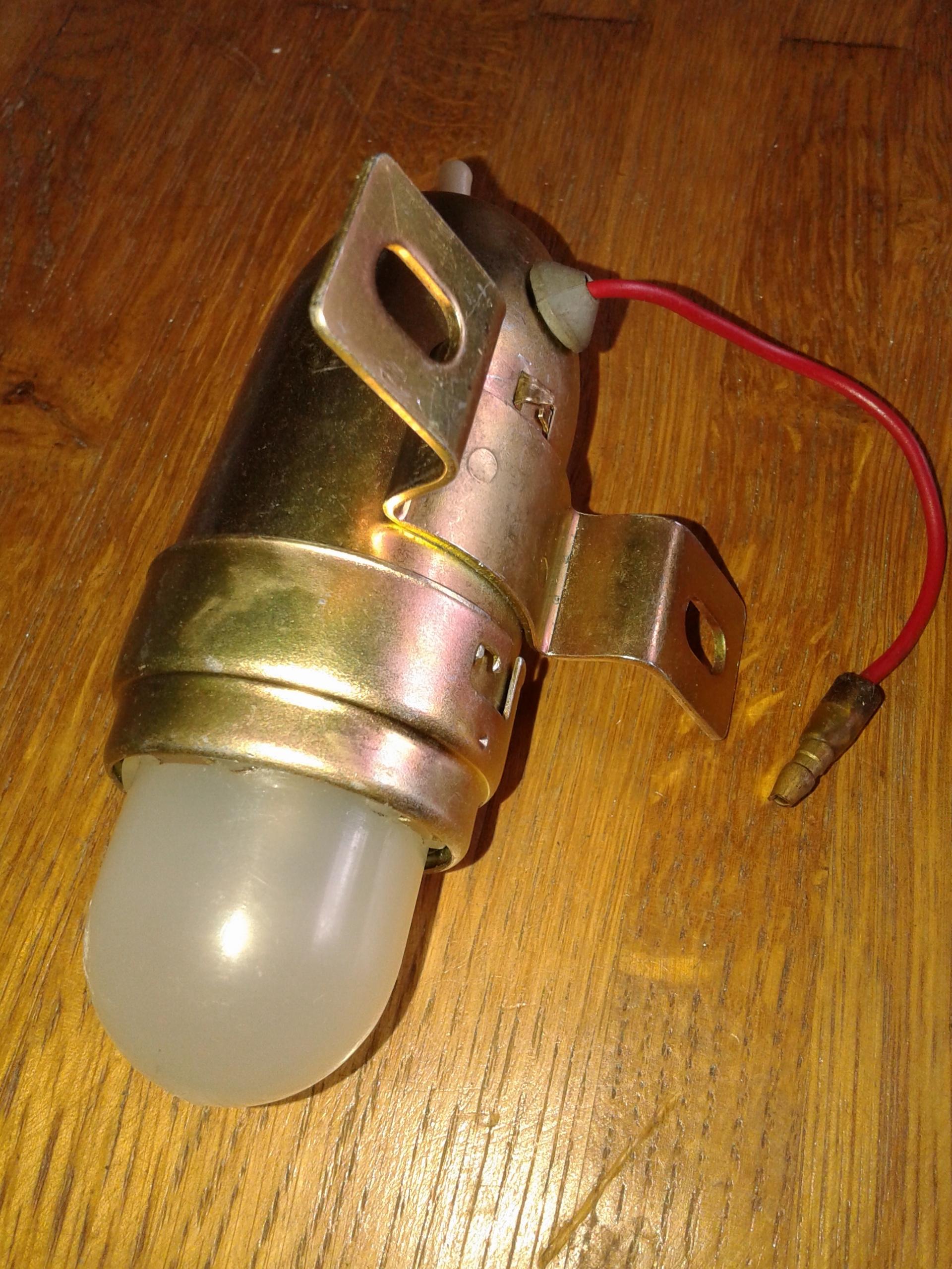

May 21, 20168 yr comment_495462 Also, after the plating tank, I spray with DI water to clean off plating solution, then dip in Blue Chromate for 30 seconds before the yellow chromate. Â Blue chromate helps with the rainbow effect and and also helps the yellow chromate to stick better. Â After yellow chromate I rinse in bucket of warm water then dry with my wife's blow dryer on high heat for about a minute. Link to comment https://www.classiczcars.com/forums/topic/51280-caswell-plating/?&page=4#findComment-495462 Share on other sites More sharing options...

May 21, 20168 yr comment_495464 The voltage usually sits pretty low.....close to 1 volt. Â current to average size part like an engine bay lamp is 3 Amps. Link to comment https://www.classiczcars.com/forums/topic/51280-caswell-plating/?&page=4#findComment-495464 Share on other sites More sharing options...

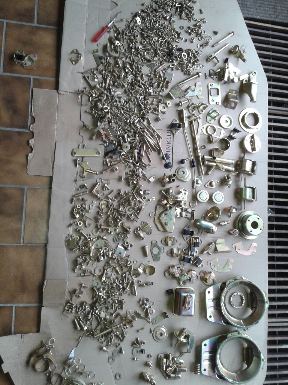

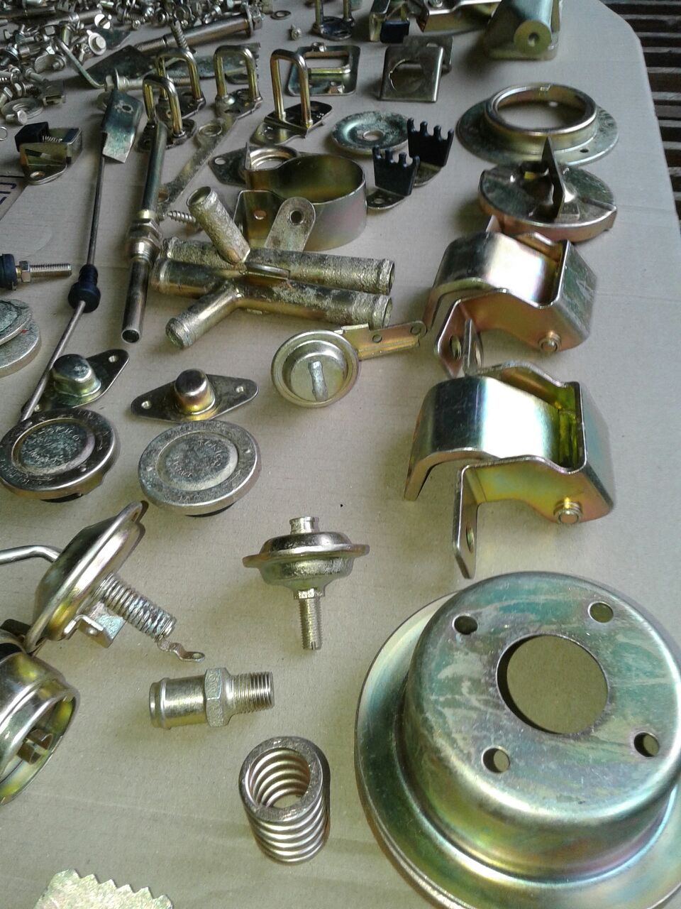

May 22, 20168 yr comment_495487 I parted out a 240z and some 280zx's and took about 25 kg to a firm who plates about anything.. i thought its not worth the hassle to do it myself.. Link to comment https://www.classiczcars.com/forums/topic/51280-caswell-plating/?&page=4#findComment-495487 Share on other sites More sharing options...
