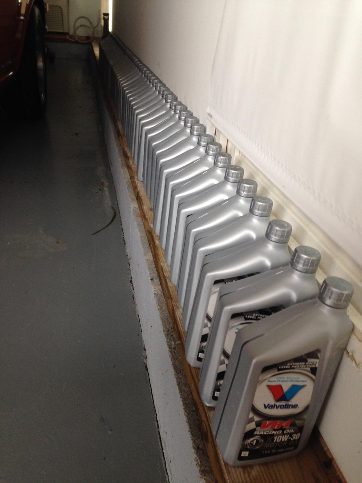

Baxters had the whole selection of racing oils, except for Brad Penn and Pennzoil.  The VR-1 was $6.29 per quart, the others ranged up to $12.  Redline's synthetic oil said right on the label - not for break-in, only after 3000 miles.  Kind of implying that you need that ZDDP in there for a few thousand miles, at least.  So maybe the whole deal is to get any roughness at all smoothed away before the ZDDP isn't necessary.  Which would make sense since roughness would have extreme pressure and ZDDP is also defined as an extreme pressure additive.  Although I think it was originally added for oxidative stability.  If I remember right.
