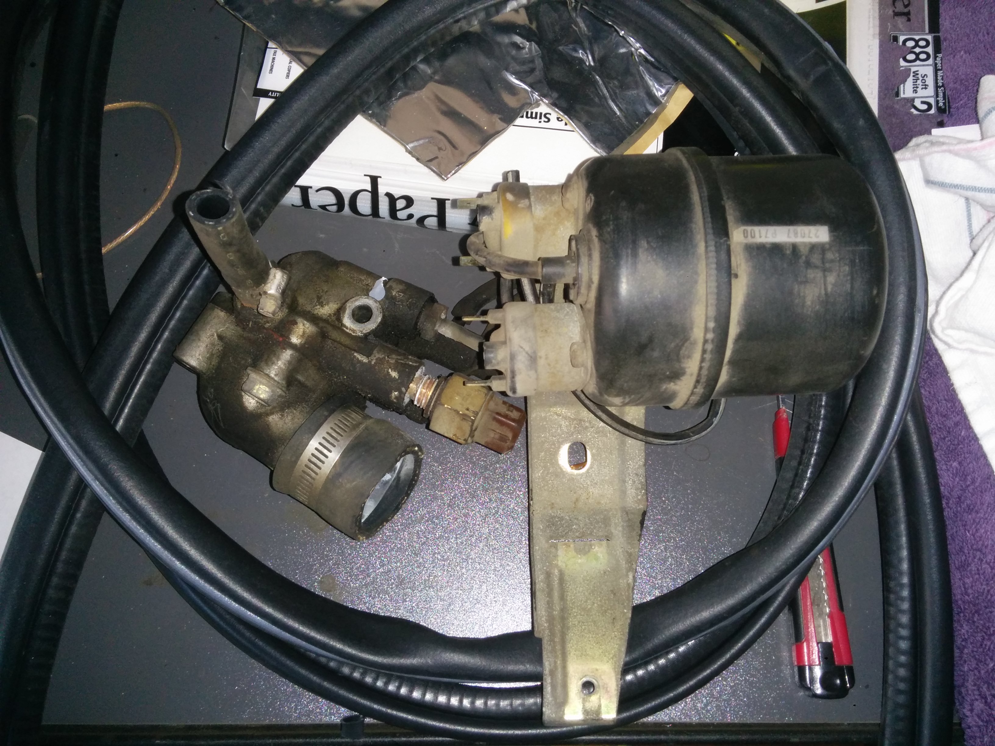

Productive morning!  I periodically check the inventory of the local Pick a Part yard hoping a 280Z will show up (hasn't yet!), but they got an 82 280ZX the other day and had a 2000 Kia Sportage, so I made an early morning trip.  Scored a thermostat housing (a PO cracked mine and glued it together with epoxy putty), a vacuum tank (I'm gonna try swapping out the big, ugly, yellow one) and some weatherstripping for the hatch (not in as good of shape as the ones I found a few months ago, but better than what's on there now).  All for $27.63.  Not bad!

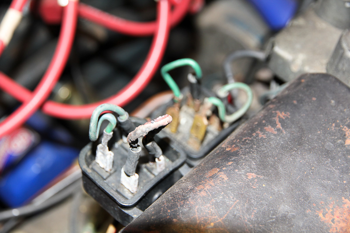

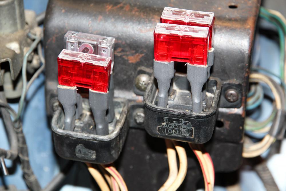

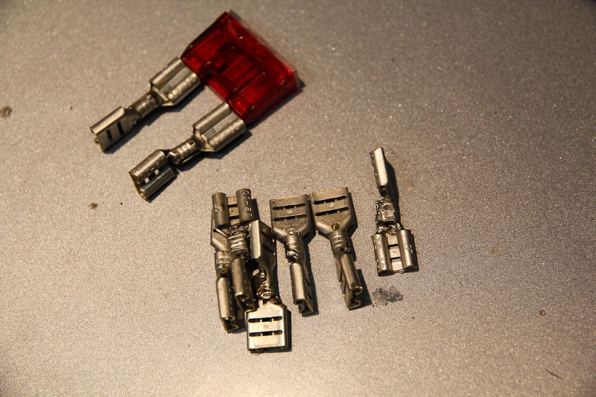

Aside from apparently being the wrong ones, at least one of my fusible links was also on its very last legs.  One day I'll probably switch to a fused distribution block, but until then I came up with this alternative.  The toughest part was sourcing the quick disconnects, since the fuses and the car wiring are both 5/16" instead of the common 1/4".

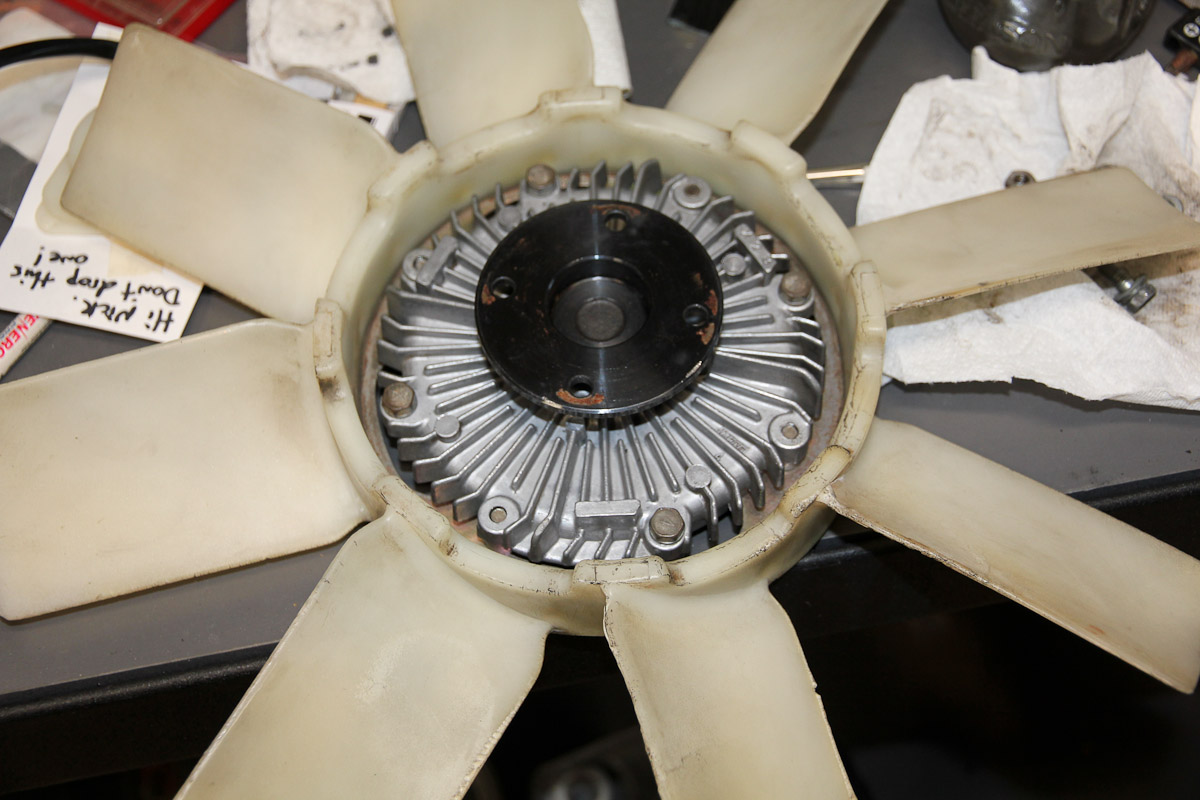

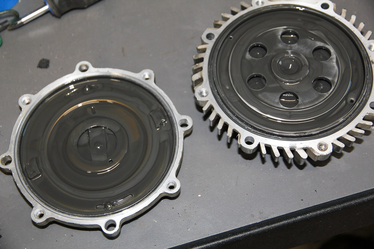

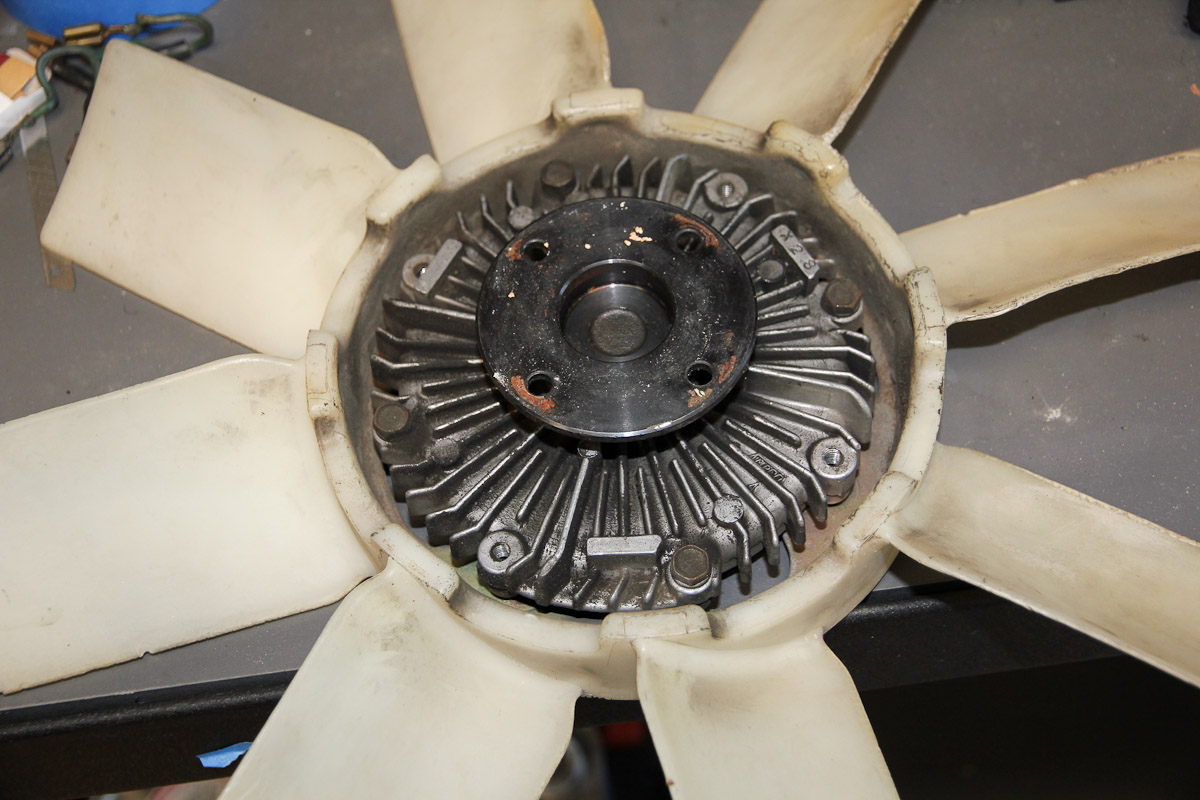

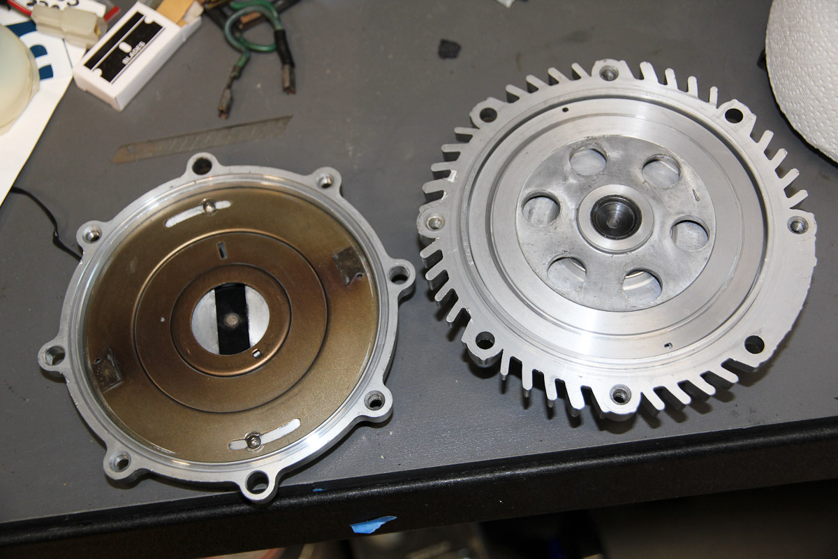

The fan always seemed to spin a lot (not siezed, but a lot of wind noise), so I pulled out and cleaned up the fan clutch as well.  There's a hobby store down the street that seels silicone oil for RC cars, so I got a bottle of the 6000 weight stuff and kind of guesstimated on the amount to use.  About half of the 60ml bottle seemed like a good starting point.  So far so good.

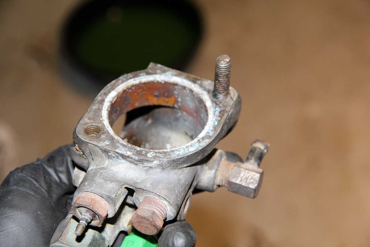

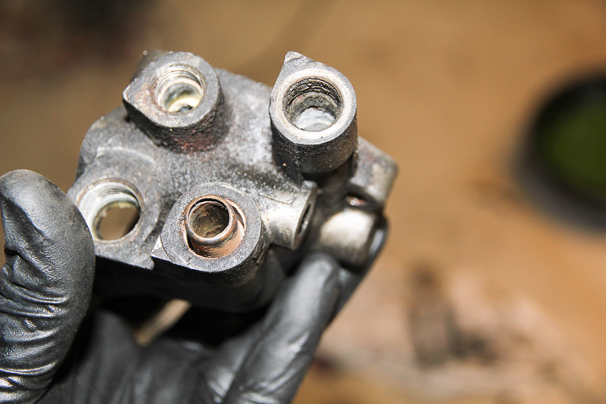

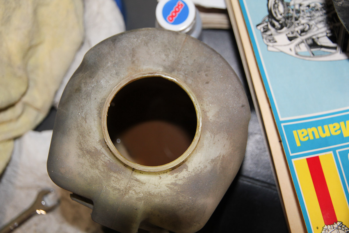

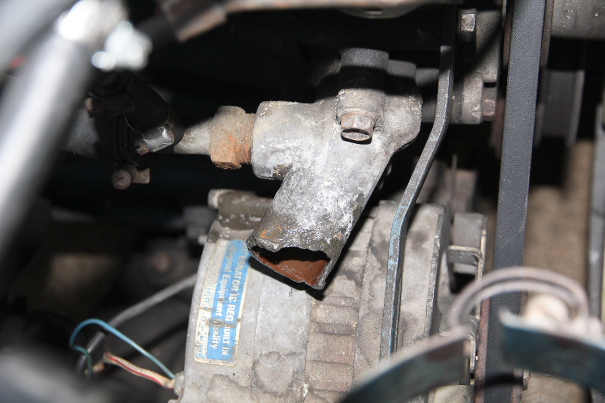

Having found that thermostat housing last weekend, and not having done a flush or other work on the cooling system since owneing the car, it seemed like as good a time as any to give it a bit of attention.  The coolant came out green, but I still flushed out a lot of brown gunk, and the overflow tank was pretty sad, but so far so good.
Then things went a bit sideways...I got all the sensors out of the new housing except for the temp gauge, which is quite-nicely stuck.  I hope I can drill it out.  The old housing is in rough shape, and other than the coolant temp sensor, there may not much much I can salvage out of it.  And then I pulled off the radiator hose and saw what the water pump inlet looks like, so I guess I have to source one of those, too.

Great job overall and very smart alternative to the fusible links. Totally agree with Grannyknot that they look better than OEM. But please: Where did you source the 5/16" disconnects and what rating fuses did you use?
Edited by dmoralesbello
Glad you guys like them! I actually ended up using 3/8" disconnects, which are not easy to find either; I bought mine from www.repairconnector.com. Mouser or one of the other big parts suppliers was the only place I found with 3/16, but minimum orders were 1000 pieces or something ridiculous. I used 3 50 amp fuses and one 80 amp. That was the most common arrangement I found with other people that switched to fuses.
So those are female: female 3/8" disconnects, correct? Did you get the fuses from repairconnector.com as well?
