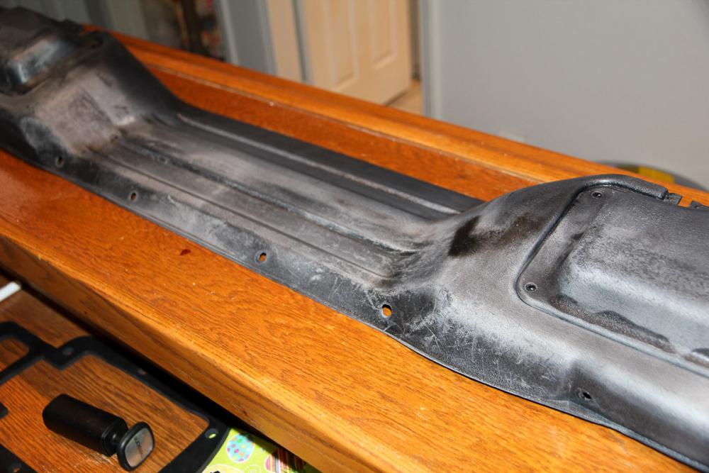

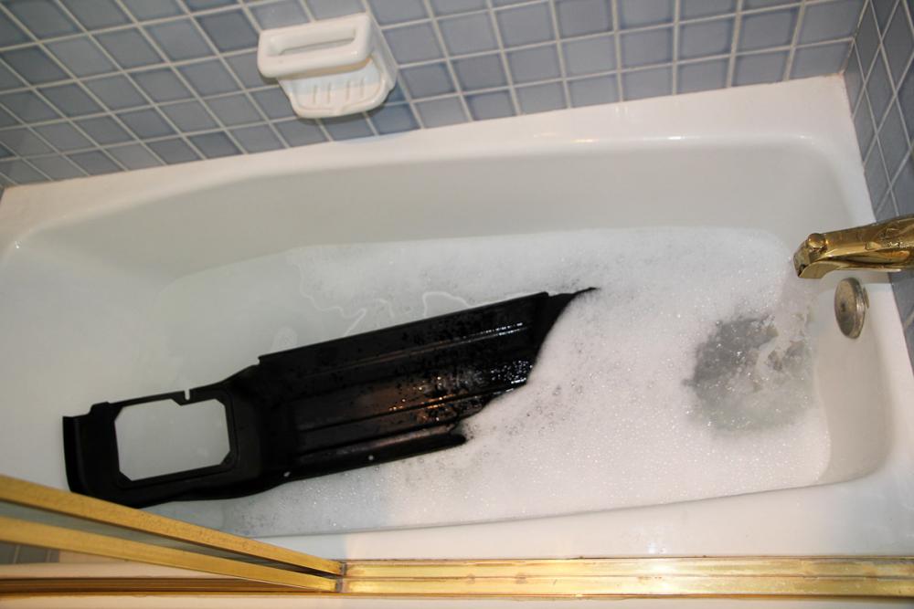

No more putting it off...finally dealing with the interior panels.  I found a leather-textured vinyl made by Hexis that looked promising and ordered two yards of it, which should be enough to do all the interior panels in the rear hatch.  Thinking it would be an easy one (oops...) I started by doing the tail light piece this afternoon.
Step 1: clean.  I gave it a bath with Oxy-Clean and scrubbed with a green scuff pad; followed that with D101 all purpose cleaner, rinsed with water and then wiped with isopropyl alcohol.

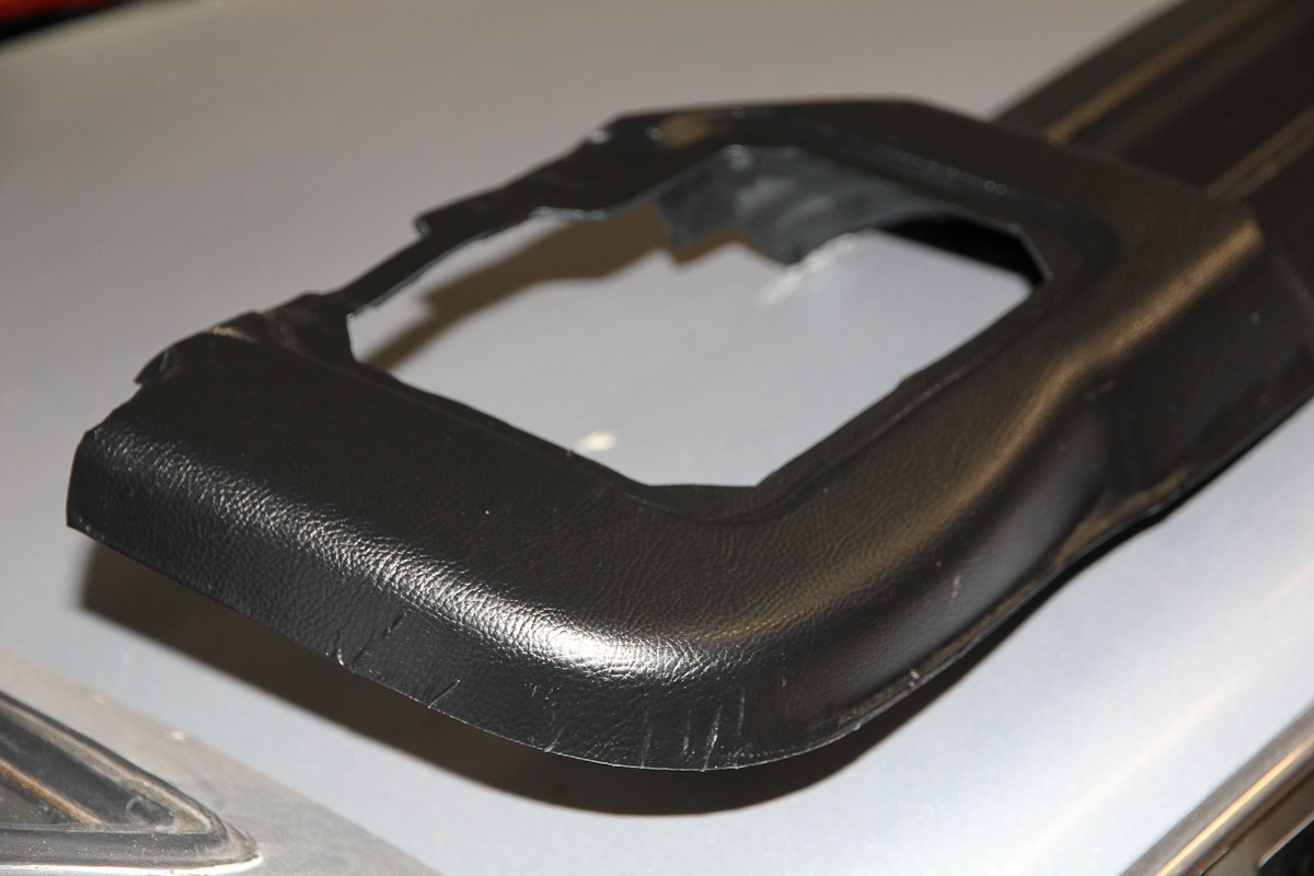

Step 4: admire your ...umm...handiwork?  A few pictures before getting in to some details.
Some takeaways from today's efforts:
Curves are tougher than they look and it does take some time to get a feel for working with the vinyl, but you do get more comfortable with it as you go.   I've wrapped some small interior bits before, but a long time ago and not enough to consider myself experienced.  I picked the tail light panel thinking it would be easy but inadvertently ended up picking probably one of the worst panels to start with.  The curves are deceptively tricky to deal with, and it's also large and awkward.
The convex curves on the outside edges gave me a ton of trouble and I never got them looking especially great.  Unfortunately, the repeated lifting/stretching/heating that I did to get those to look the way they do now seems to also have reduced the effectiveness of the adhesive on sections that were overly-futzed with.  So visible section like this are lifting, because I spent too much time trying to make sections that I now realize can't be seen look good.  Whoops!
That said, the areas where I managed to apply it well came out really well!  I wasn't sure how much I'd like the look or feel, but both are very good and, IMO, appropriate for the car.  Will definitely continue on with the rest of the panels, which hopefully should be a bit easier to deal with.

Summed up, I'd say the results are a 10 of 10.  The look and feel is exactly what I was hoping for.  I'd describe it as a slightly cheaper version of the G37 interior.  The vinyl didn't distort the panel at all, and actually give it more structure so it isn't so flimsy anymore.
My application was more like a 4 out of 10, though.  This part here:
I probably lifted, stretched and repositioned it 20+ times, which is tough on the adhesive.  Most of that was just to clean up the far outside curves, which can't even be seen.  The way to wrap complex curves is (somewhat counter-intuitively) to stretch the vinyl around them.  The Hexis material can stretch about 30% before it will lift, so even if I had hit this on the first shot, it probably wouldn't stick.  I should have trimmed along that green line instead.  Depending on how the rest of the panels go and how much I'm bothered by it, I may re-do this panel later.

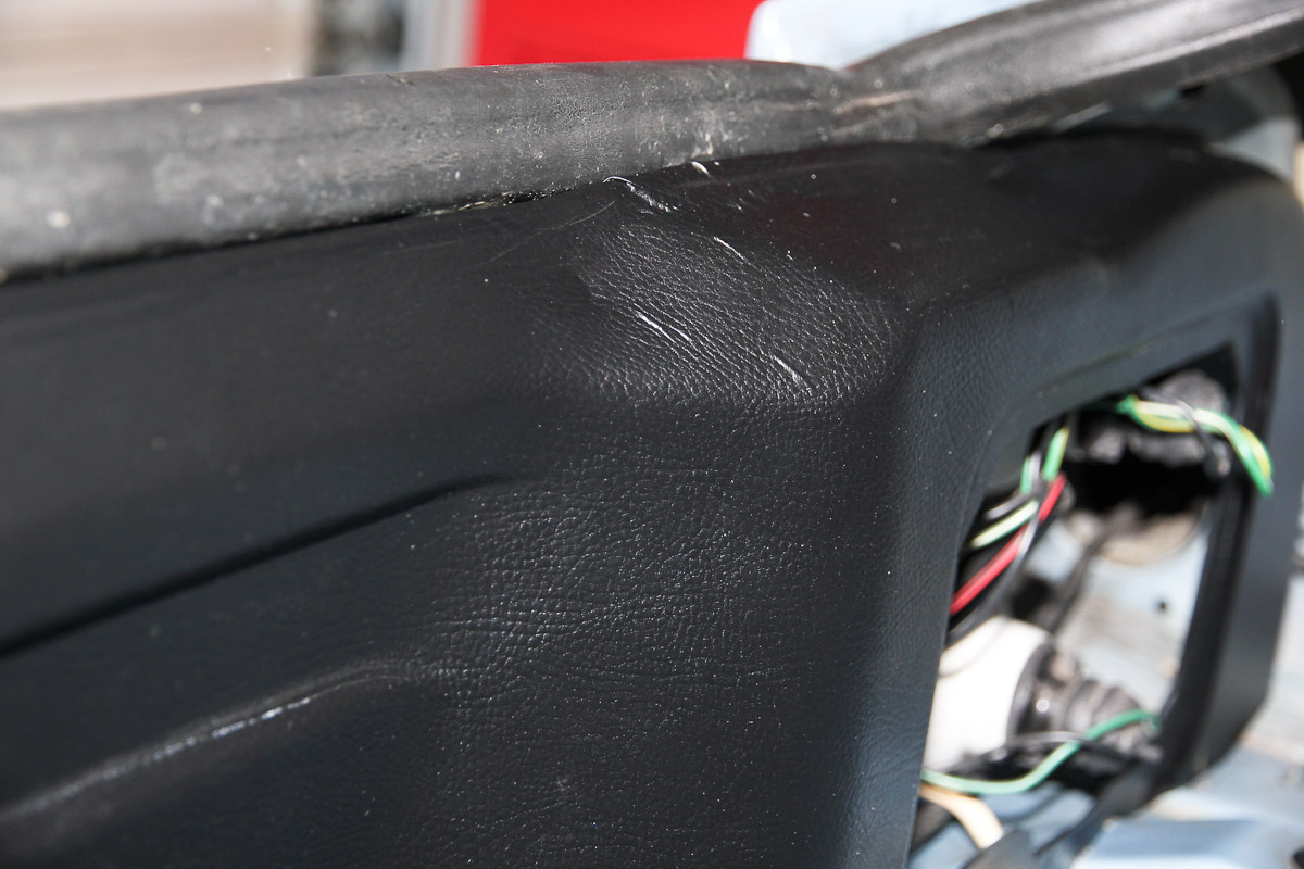

Better results today doing the panel I should have started with yesterday.  The rear panel on the driver's side is curved, but only in one direction, so it's basically a flat piece.  30 minutes for this one, and it came out quite nice.  The toughest part is getting the sheet down flat so it doesn't wrinkle, but it's workable if you go slowly.
Did a little practice with some scraps on the tougher shapes, because I'm out of easy bits to wrap now! :)
Panel looks good installed, except for the part that got nicked up on the hatch support.  Another entry in the What Did You Think Was Gonna Happen!? file.
