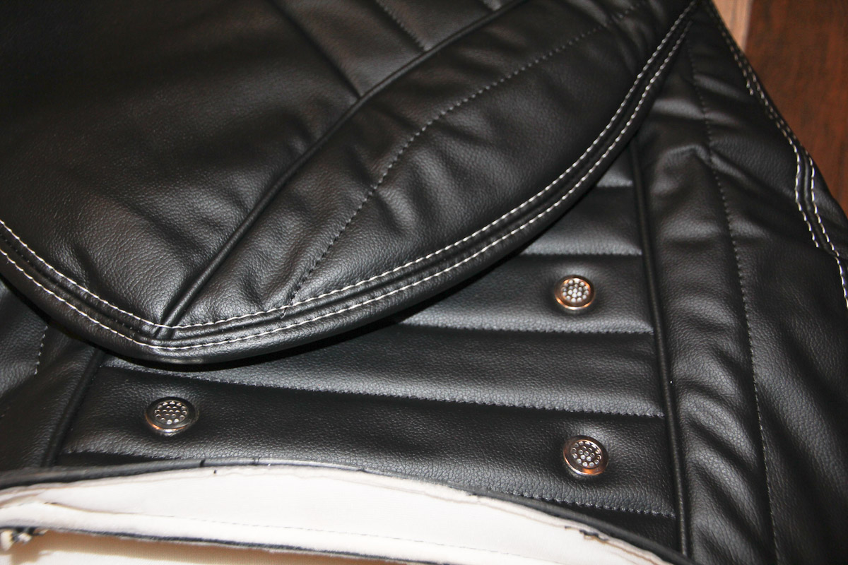

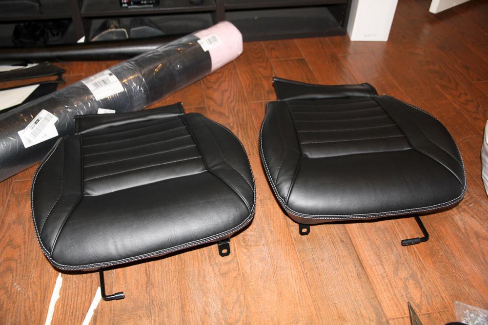

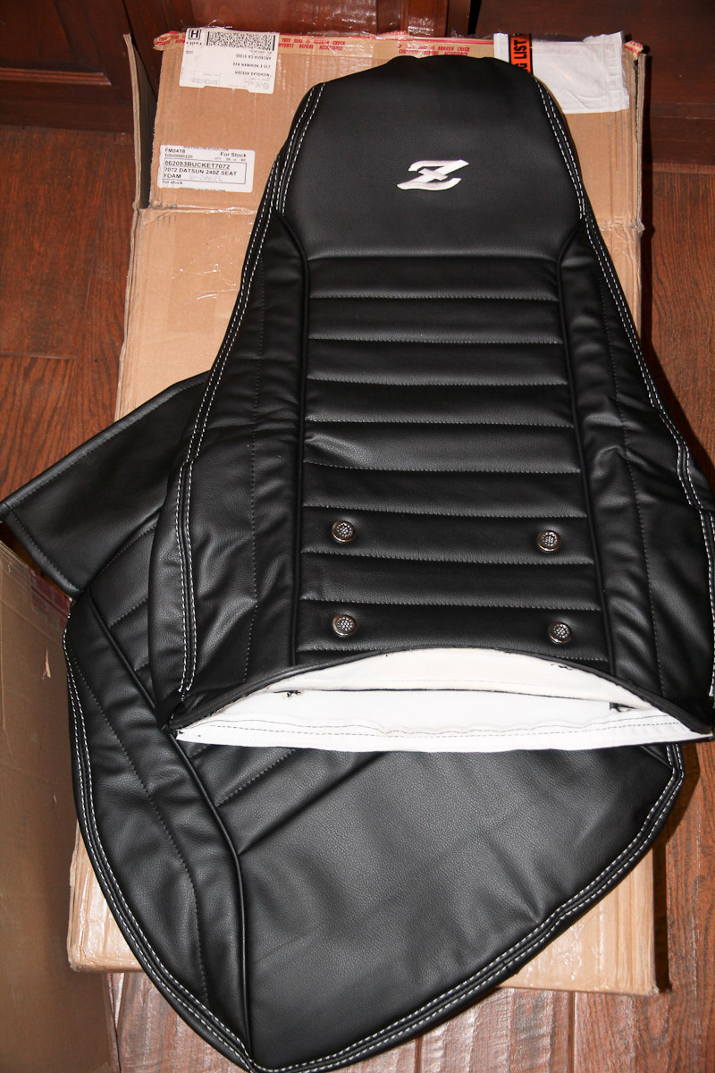

A nice B-day present from my dad came in a few days ago!  Like many others, I went with Interior Innovations.  First impressions are really good: the vinyl feels like it's high quality, the covers are nicely padded, and the stitching looks to be well done.  I have the seat foam as well, and as soon as some more materials from Your Auto Trim get here, I'll be able to tackle that job.  I'm excited to get it done.

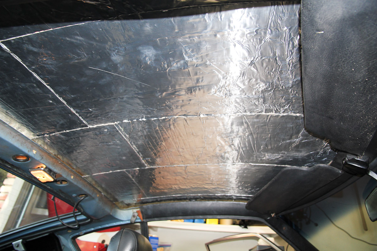

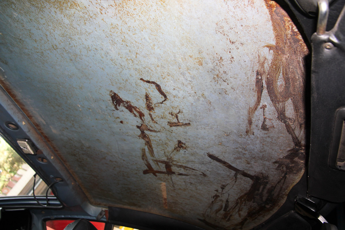

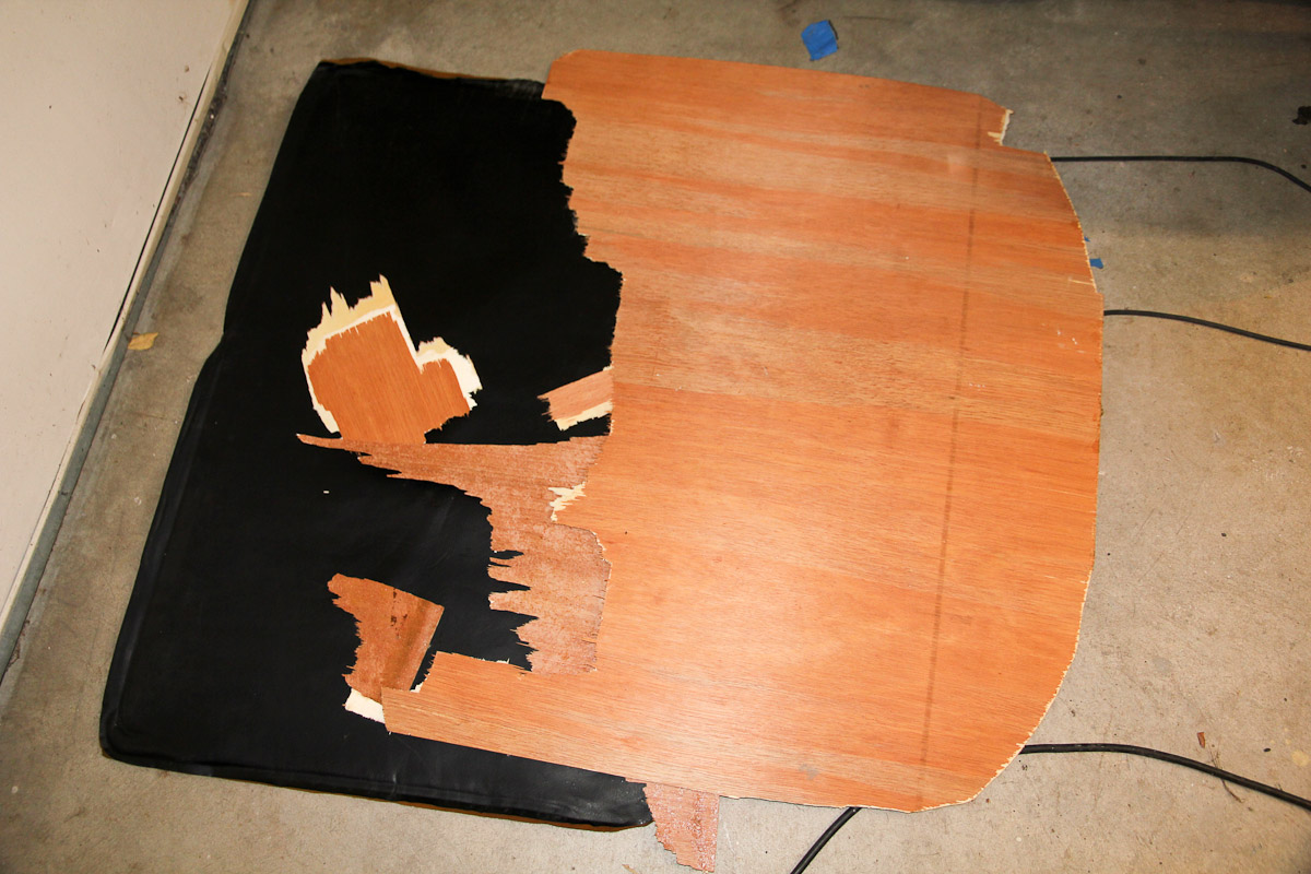

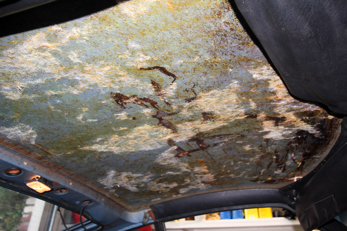

And since the seats are coming out and the interior panels are already out, may as well deal with the headliner while I'm at it.  I pulled the old one out and uncovered another little surprise.  Apparently one of the POs thought that sticking a piece of plywood up there would help it stay in place?  I dunno.  Glad I bought the gallon size of Goof Off last month -- I used a lot of it to clear the crud off the roof.  The whole roof was then covered with Raammat.  I usually don't do full coverage, but to avoid any problems with the headliner drooping or the edges of the deadener showing through the foam, this felt like the best route.  Headliner is in the same order from Your Auto Trim.

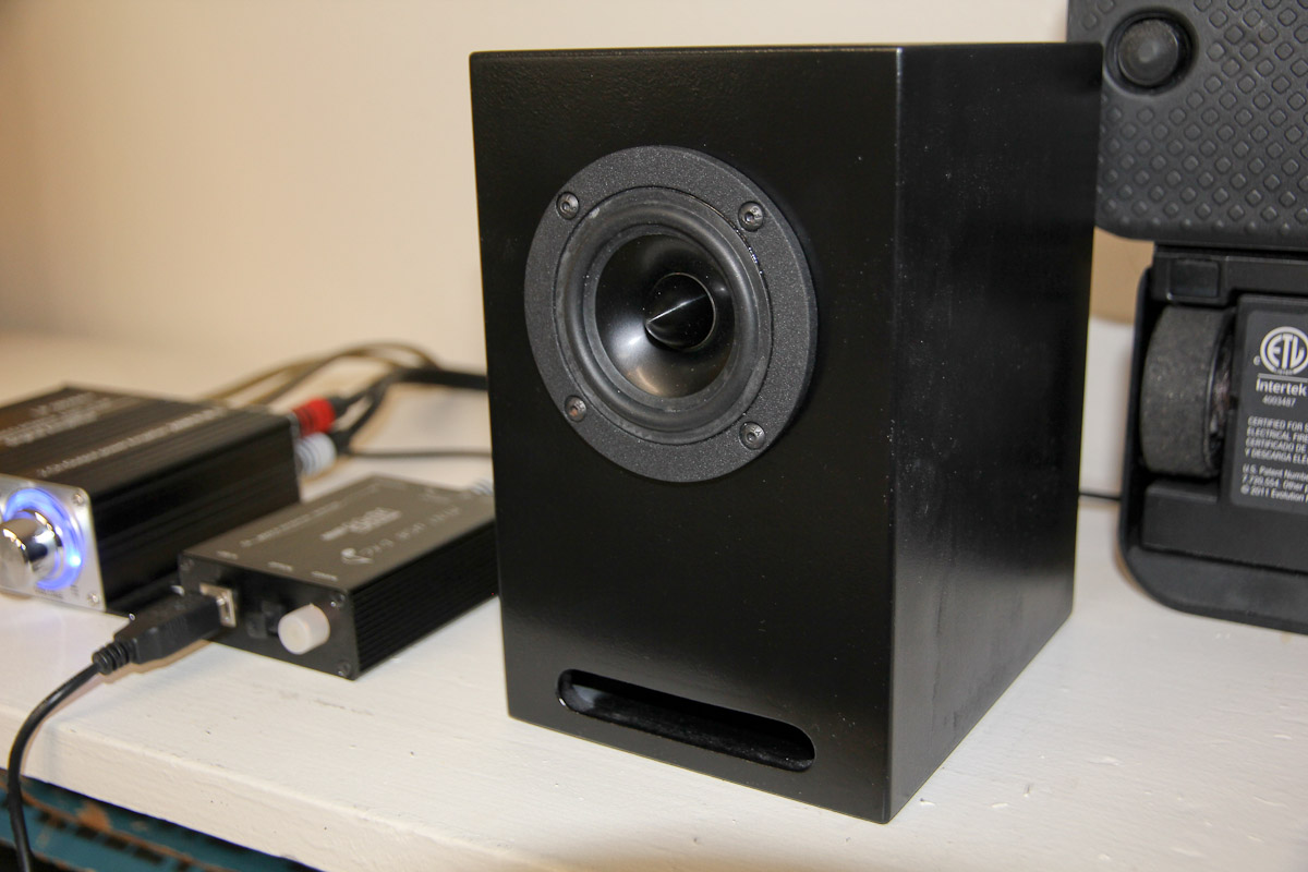

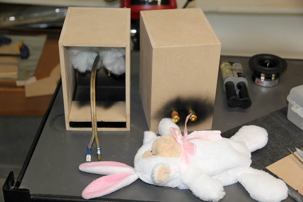

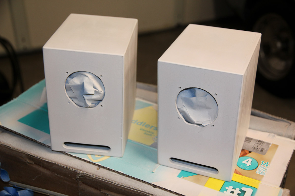

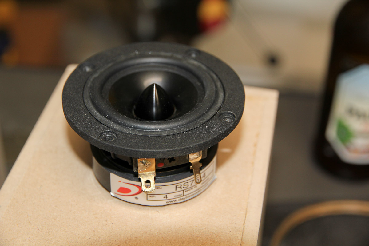

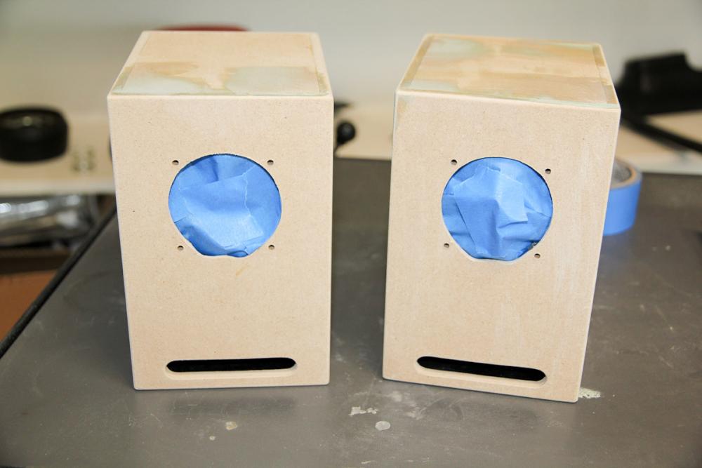

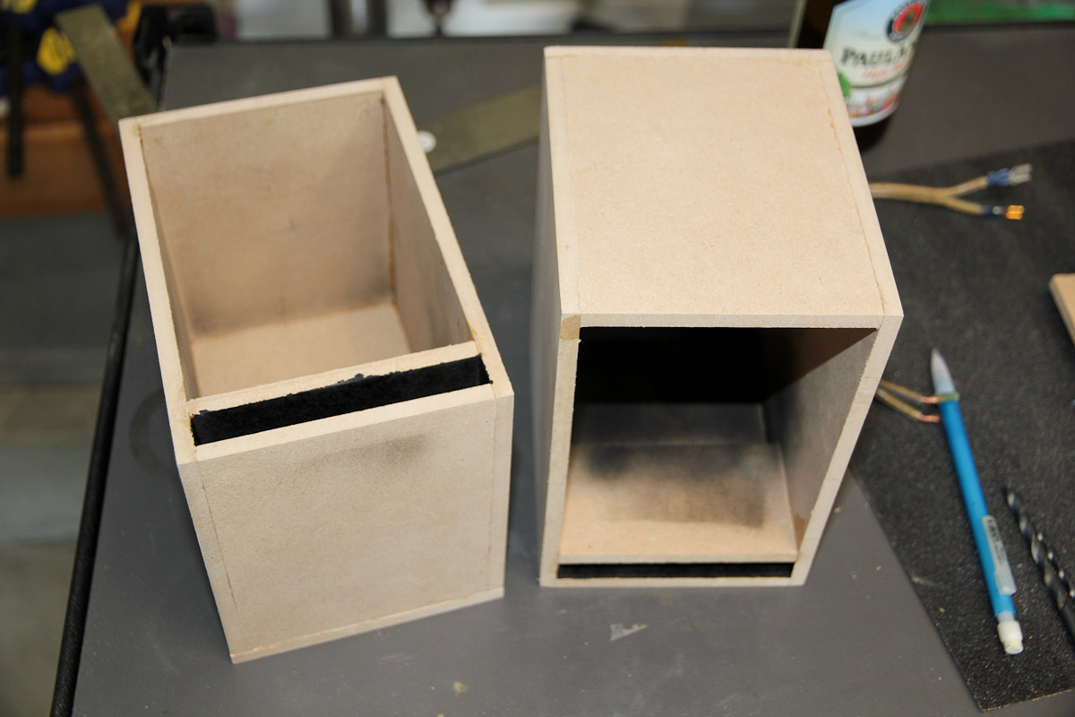

Finally, an unrelated project I took on after finishing the deck.  I had some MDF scraps left over, and a couple small drivers and other miscellaneous audio bits I'd used in the G and other projects, so I made a little upgrade to my audio system in the garage.  It doesn't have a lot of bass, but considering I was previously using only my laptop's built-in speakers, it's a solid improvement.  Makes working upside down on the inside of the roof a bit easier :)
RIP, my daughter's old bunny, who heroically sacrificed her polyfill for a greater cause.

looking at your headliner pics reminds me of when i did that job - a real pita working upside down in that tiny cockpit.
some tips: do a complete dry-fit test before spraying glue, then hold it in place, pull and spray 1 side then when it's all tucked in pull and spray the other. once the foam touches the cement it's a done deal so think before you stick. oh, and wear a beanie that you can toss when done - or be ready to go to the barber afterwards 'cause that glue don't come out!

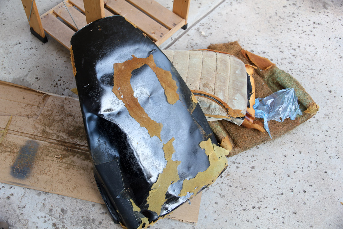

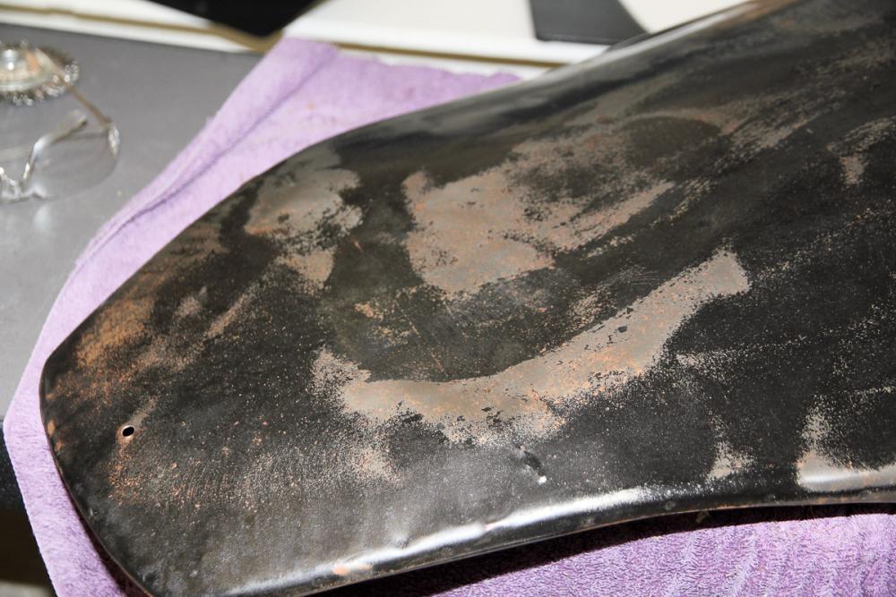

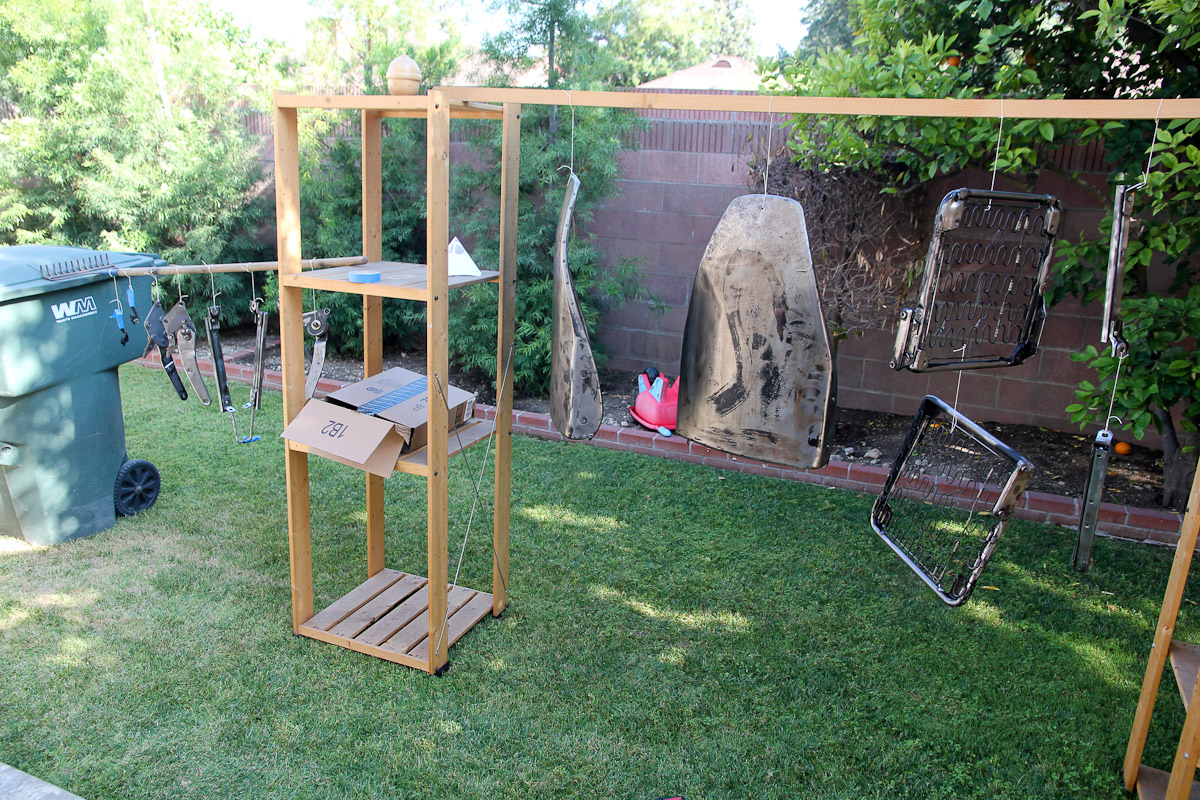

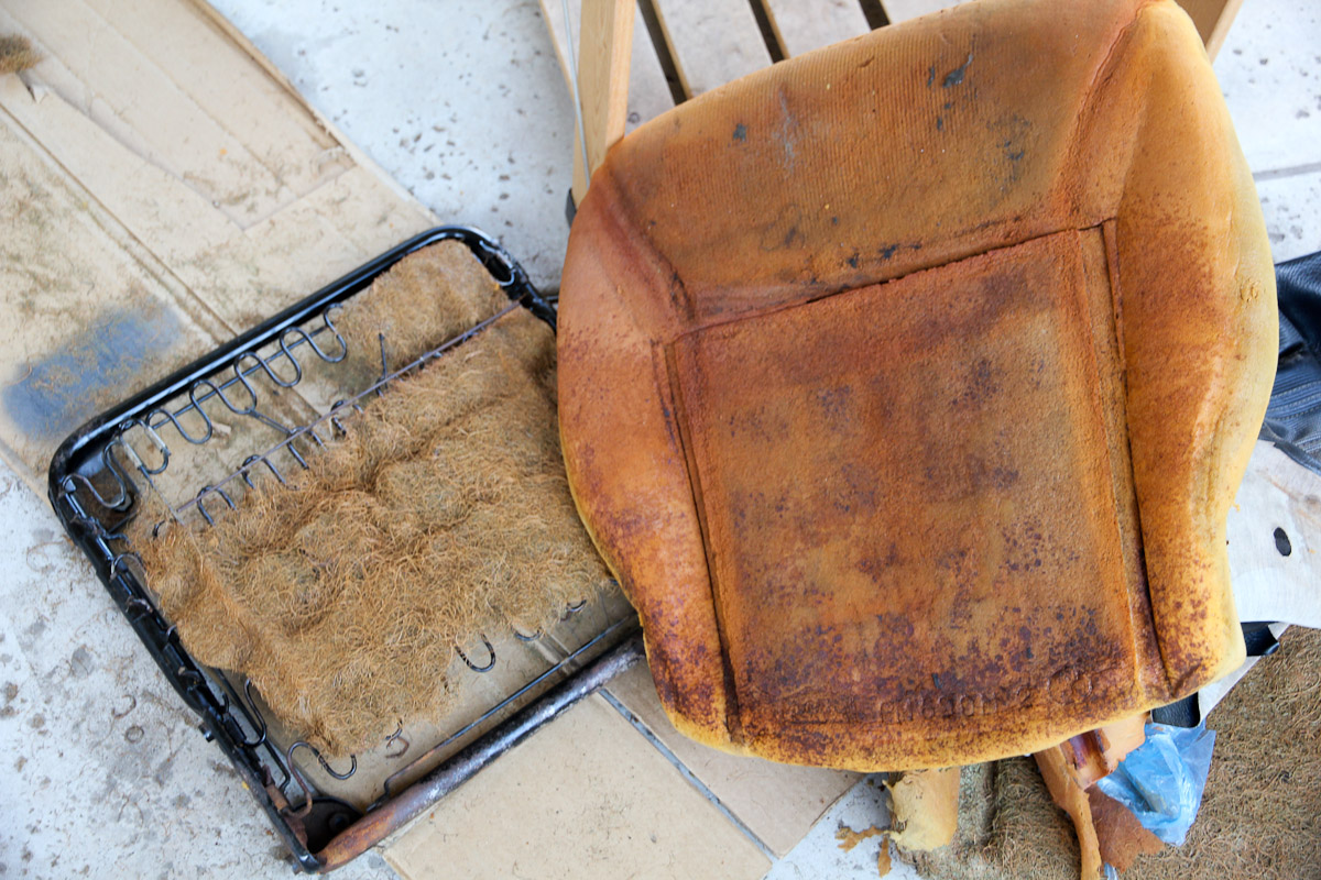

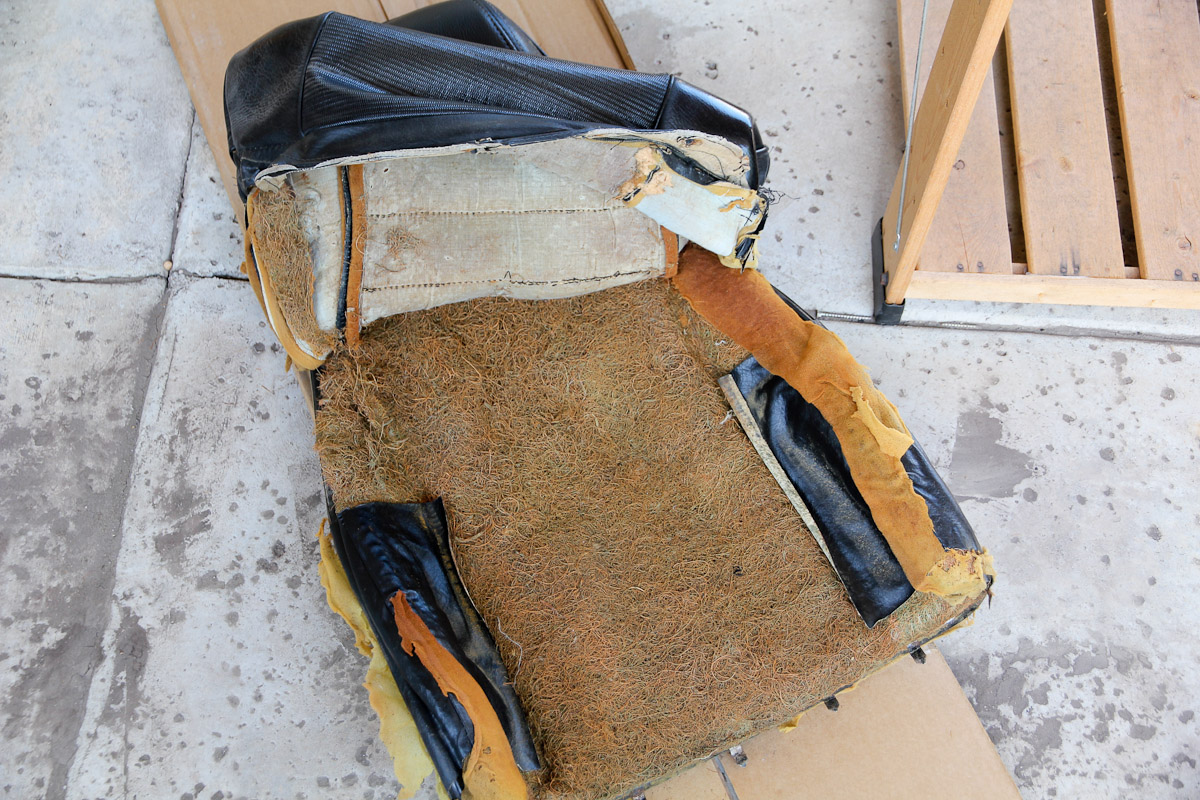

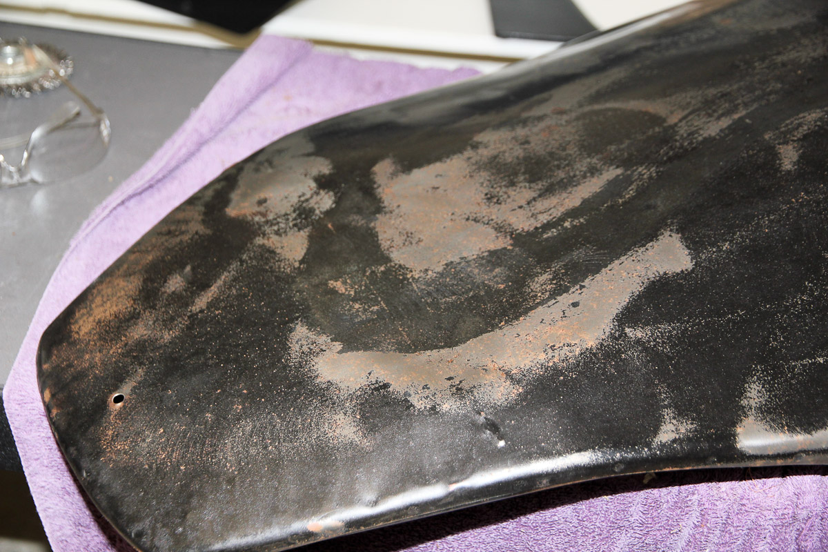

Work on the seats is going well.  Stripping off the old covers was, well, gross.  (Probably should look at getting a tetanus booster...)  I did my best to knock the seat backs into something resembling a proper shape, then hit everything with the wire wheel to knock off any rust and loose paint and finally shot it all with a couple coats of semi-gloss Rustoleum so everything looks nice.

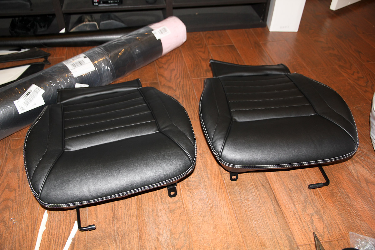

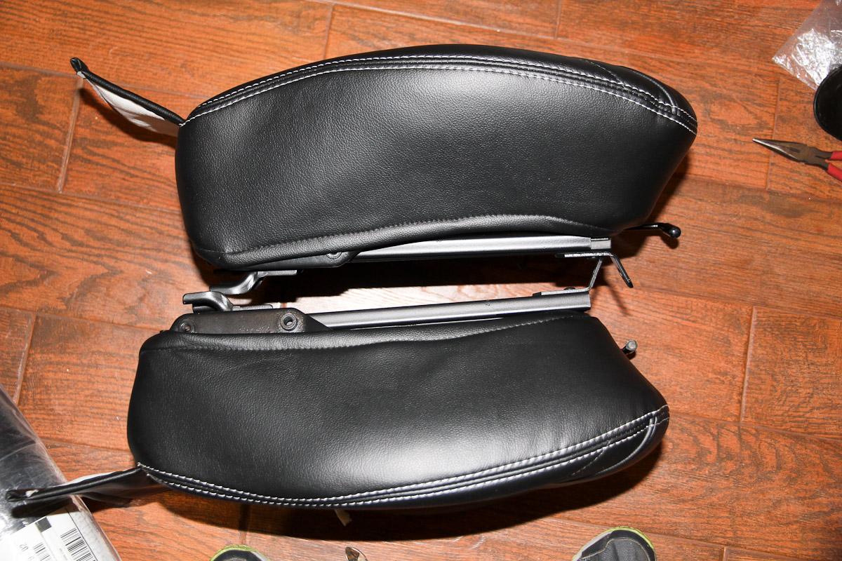

I was planning on taking some photos during the seat re-covering, but yikes did I underestimate just how much work that is!  Getting the cord around the seat frame and tied off with just one set of hands is no joke!  They're looking nice and pretty, though.
The probably-inconsequential-but-that-I'm-nonetheless-agonizing-over decision I'm currently trying to make: do I pull the seat cover down over the bolt holes for the recliner mechanism (top seat) or not (bottom)?
