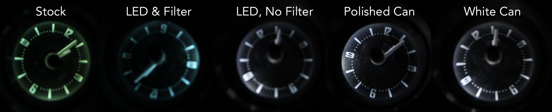

And have been playing around with some gauge lighting options.  I picked up a pack of 20 4W drop-in LED bulbs on eBay for $7.  Tried different combinations of the green lens, scuffing inside of the enclosure to increase reflectivity and painting them white (interestingly, the various forums dedicated to growing pot have a veritably monopoly on Google searches for surface treatments best for reflecting light!).  The LEDs have a much cooler color temperature than the old incandescents.  Popping out the green lens and painting the cans white was the combination I liked best.

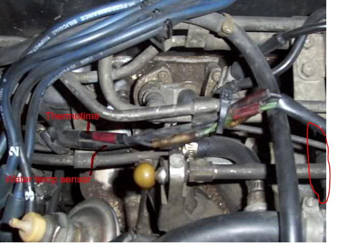

Replaced the hose to the aux air regulator
What's up with the "$51" from your other post?  Is that the hose from the cylinder head to the heater core?  I couldn't eke out the complete story from your cryptic post.
Why'd you replace the AAR hose?  Not connected to coolant.  Not getting the picture.
$51 was the cost of the tow to get home :)
I replaced the hose that connects to the rear-most outlet on the thermostat housing.  I'll admit to having to do some Googling to figure out what it was and may have my parts wrong.  The hose I replaced is what's on the other end of the circled one here:hose.png
