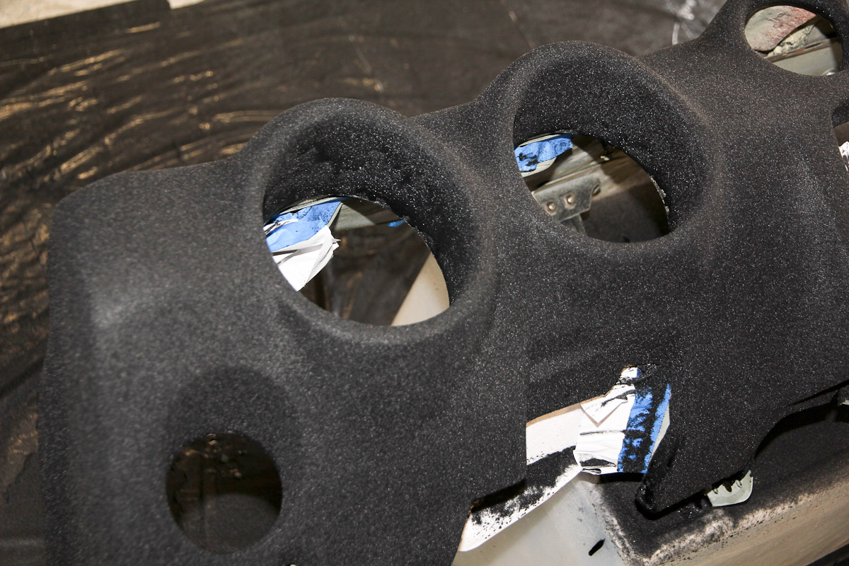

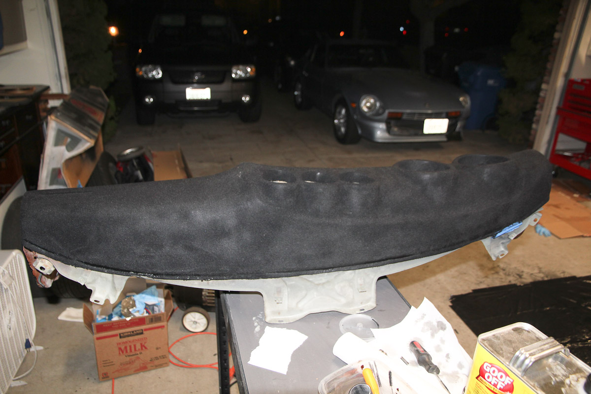

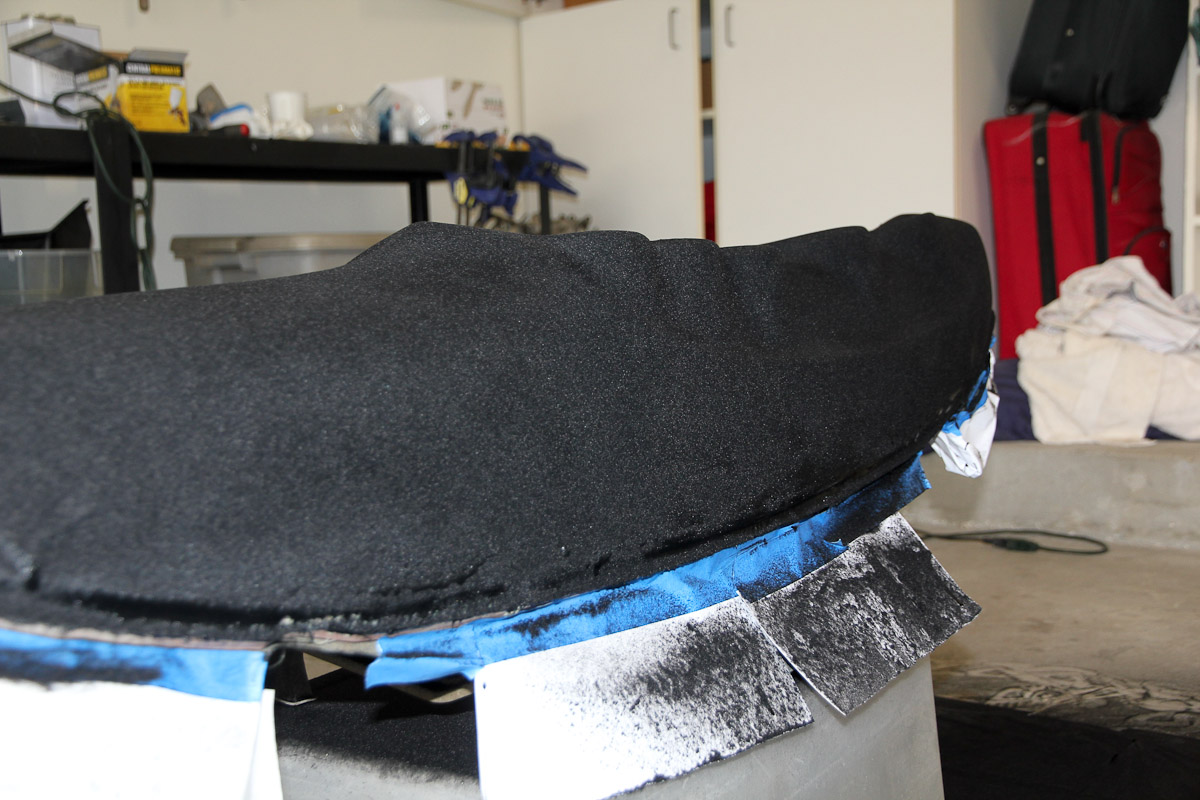

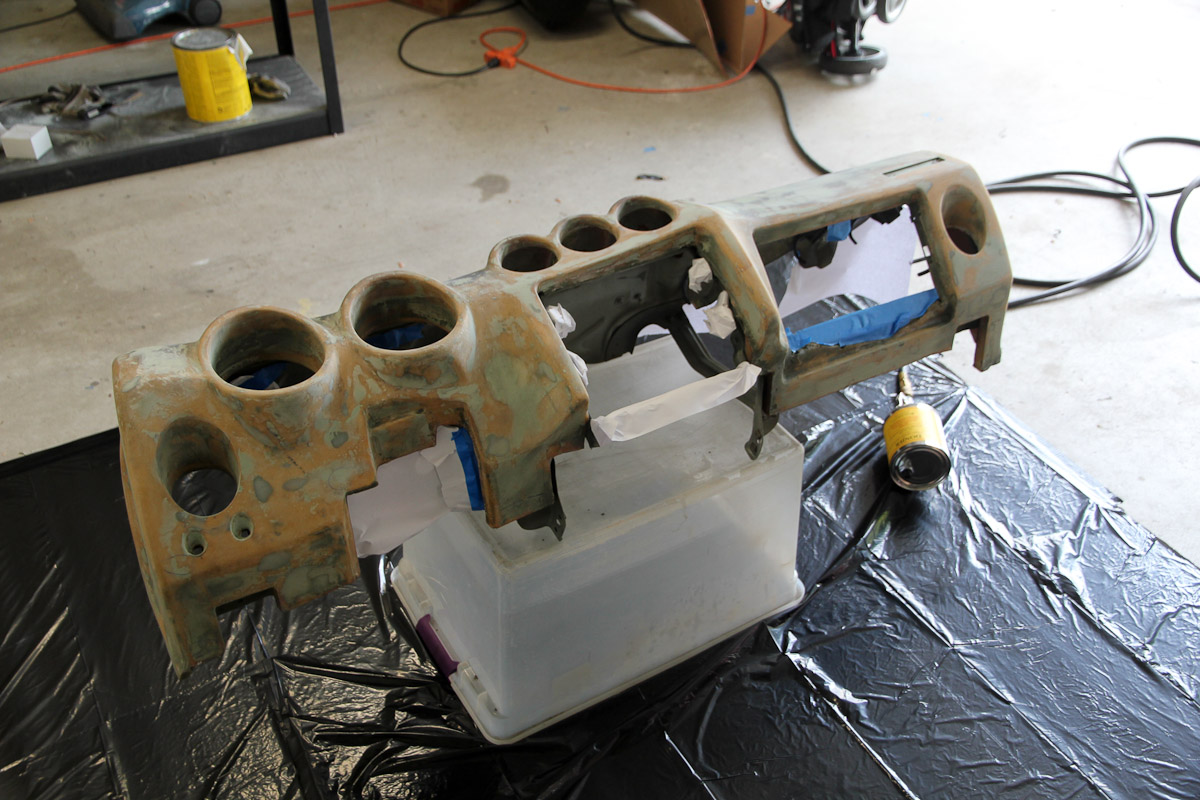

Today was the big day: flocking day!
It went ...sub-optimally.  Step 1 is to apply the undercoat/adhesive.  This stuff is supposedly sprayable, but even with a big tip, nothing much would come out.  The spec sheet says to thin with mineral spirits, but those aren't available in SoCal anymore, and after putting the gun down for just a couple minutes, it was starting to clog up.  Called an audible and used brushes instead, which is where things went sideways.
I watched some Youtube videos and one thing that kept coming up was that you need to work fast. So I recruited my wife and we laid the stuff down as quickly as possible, and also put it on thick.  Too thick.  The top of the dash in particular ended up getting some nasty-looking runs in it.  I have to wait until tomorrow to knock off the excess, but I'm 90% certain that all the flock I just put on will have to be stripped off and reapplied.  Bummer.
The good:
  • I bought plenty of extra materials.  And it's cheap.
  • The compressed air applicator was super effective, and I saved like $60 by just making my own instead of buying it.

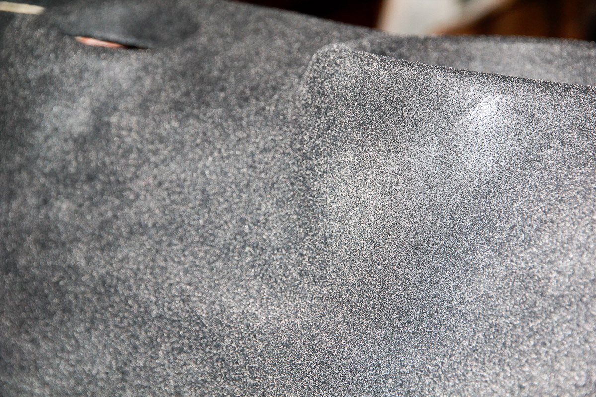

  • The parts where the flocking was done well ended up looking quite nice.  The camera makes it look kind of sparkly, but it's much closer to flat black.  It's better than I thought it would be.  Not sure about the feel/texture since I can't touch it yet.
The bad:
  • I kinda screwed it up.  It's not hard to apply, but I should have practiced on a small piece first.  If you want to flock something, do a test run.
  • Doing a job again sucks.  Not a good way of doing your test run.
The flocking is nylon fibers.  It's supposed to have a suede texture. It looks a lot like suede, but I can't touch it for 24 hours until the glue dries.

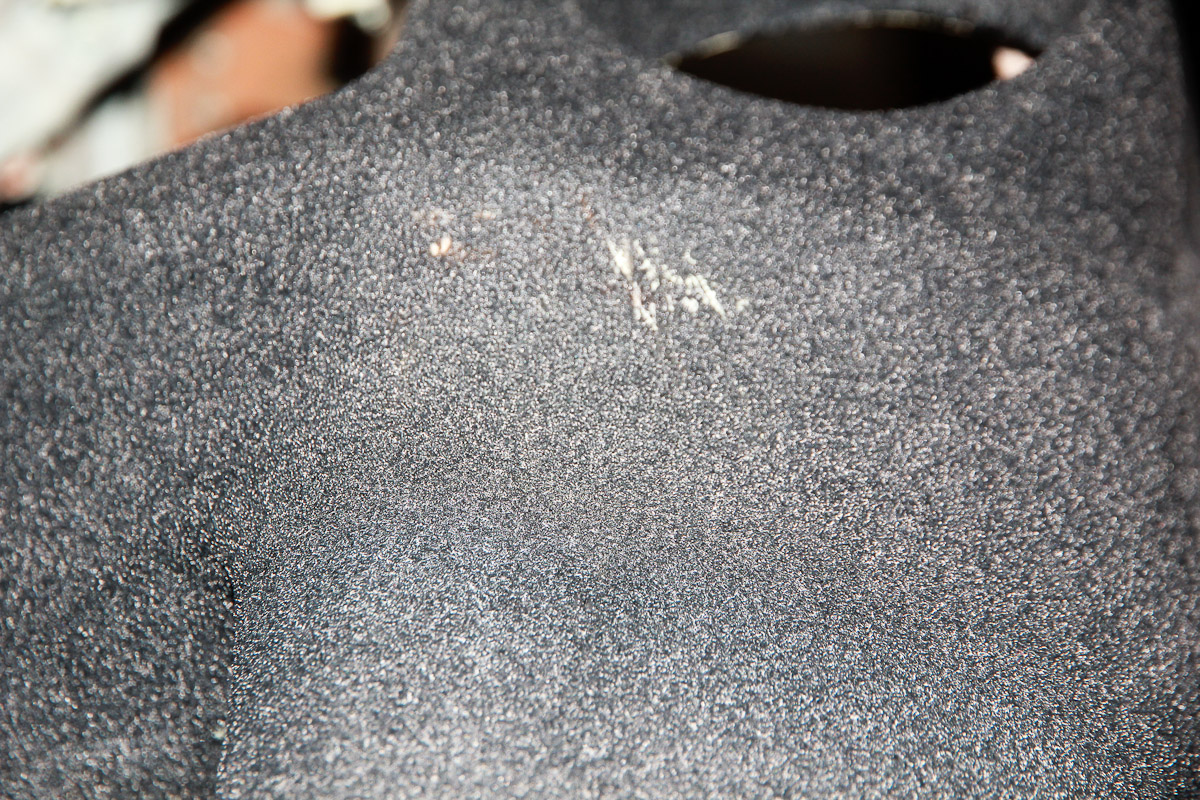

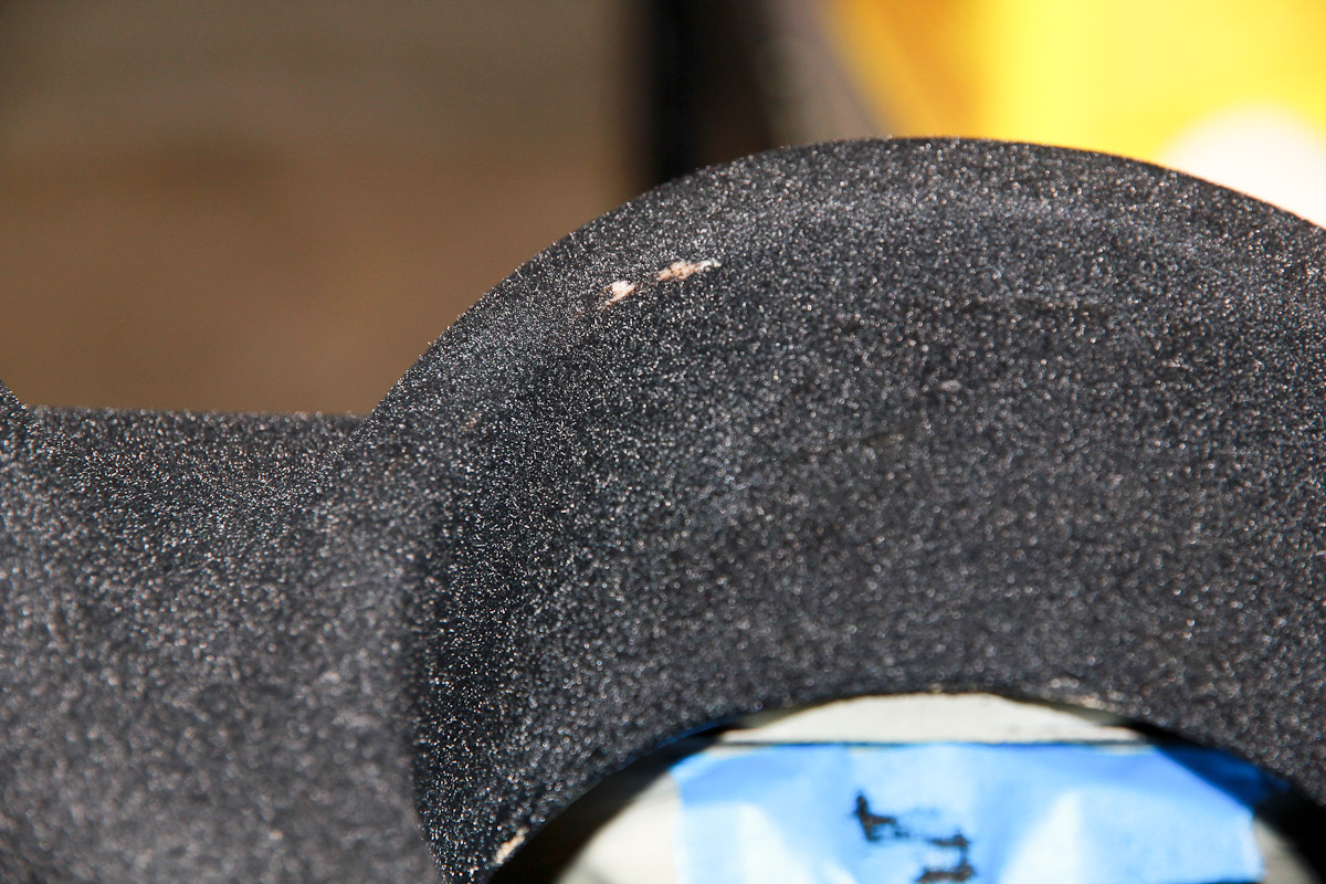

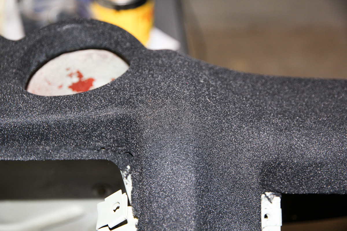

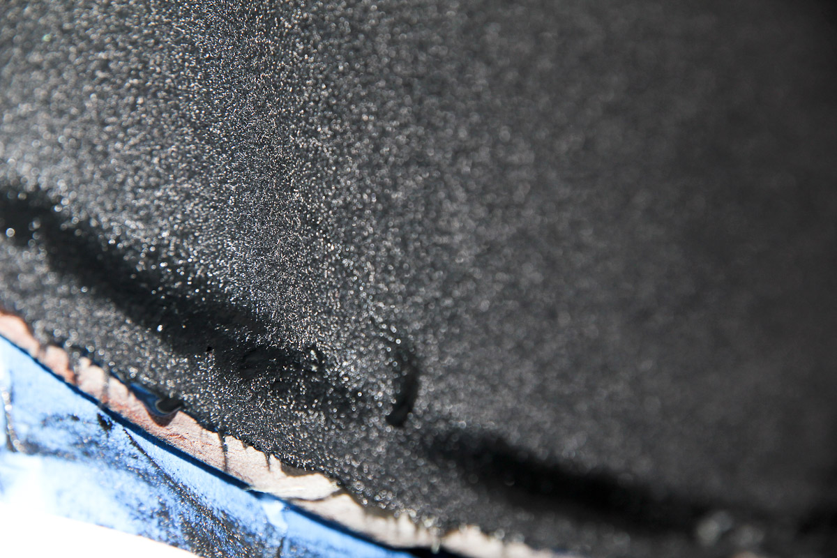

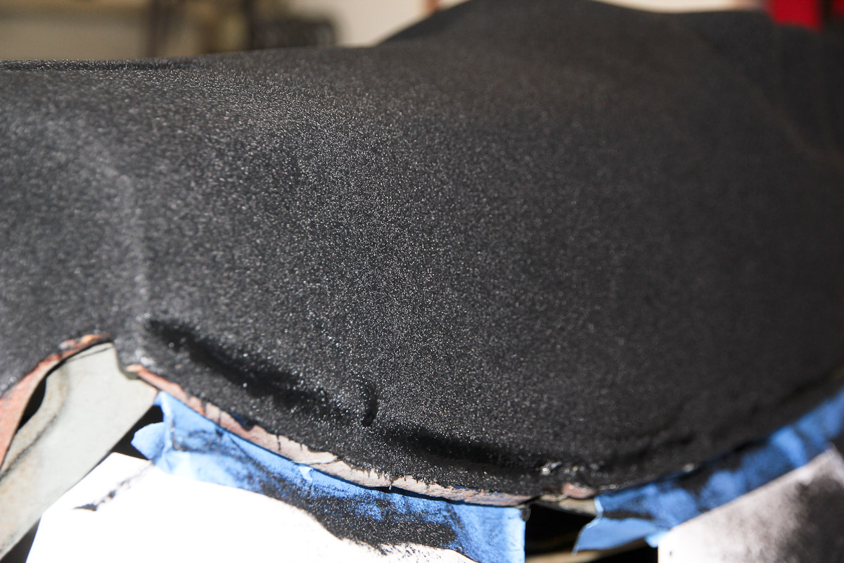

Happy with the look so far, just not happy with the application I did.  It's tough to photograph the runs, but you can see the worst of it in the 3rd picture on the left side at the bottom of the dash.  I might still end up looking okay or good enough for me to leave it, but I'm not optimistic.  I spent a lot of time and effort trying to get the dash as close to perfect as I could manage, so if I have to spend an extra day stripping and re-flocking, it wouldn't be the end of the world.
Blew off the excess flock to see how it came out, and it needs a do-over, for sure.  The glue that ran down isn't quite as noticeable as I thought it might be, but I ended up with some thin and bald spots that I can't live with.
