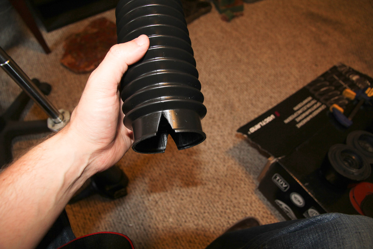

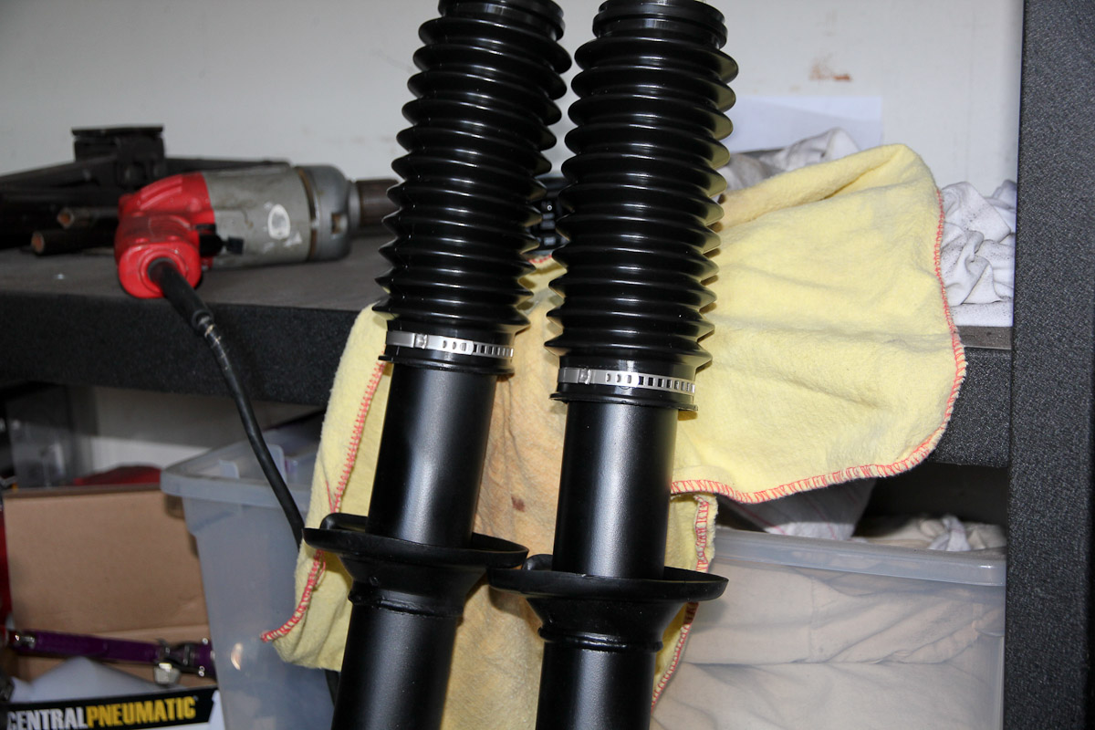

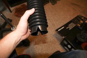

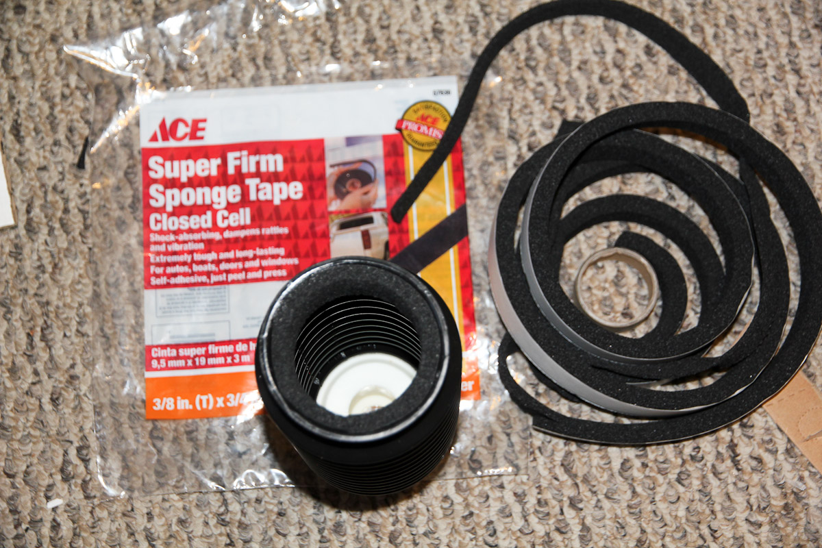

So that strut boot problem...first attempt was to cut notches out of the collar.  That was enough to get the clips around, but it still moved too much, so I went to my local hardware store for inspiration and found this stuff, which I trimmed down and lined the inside with.  Then tied with CV boot clamps.  Fits great.

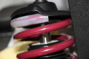

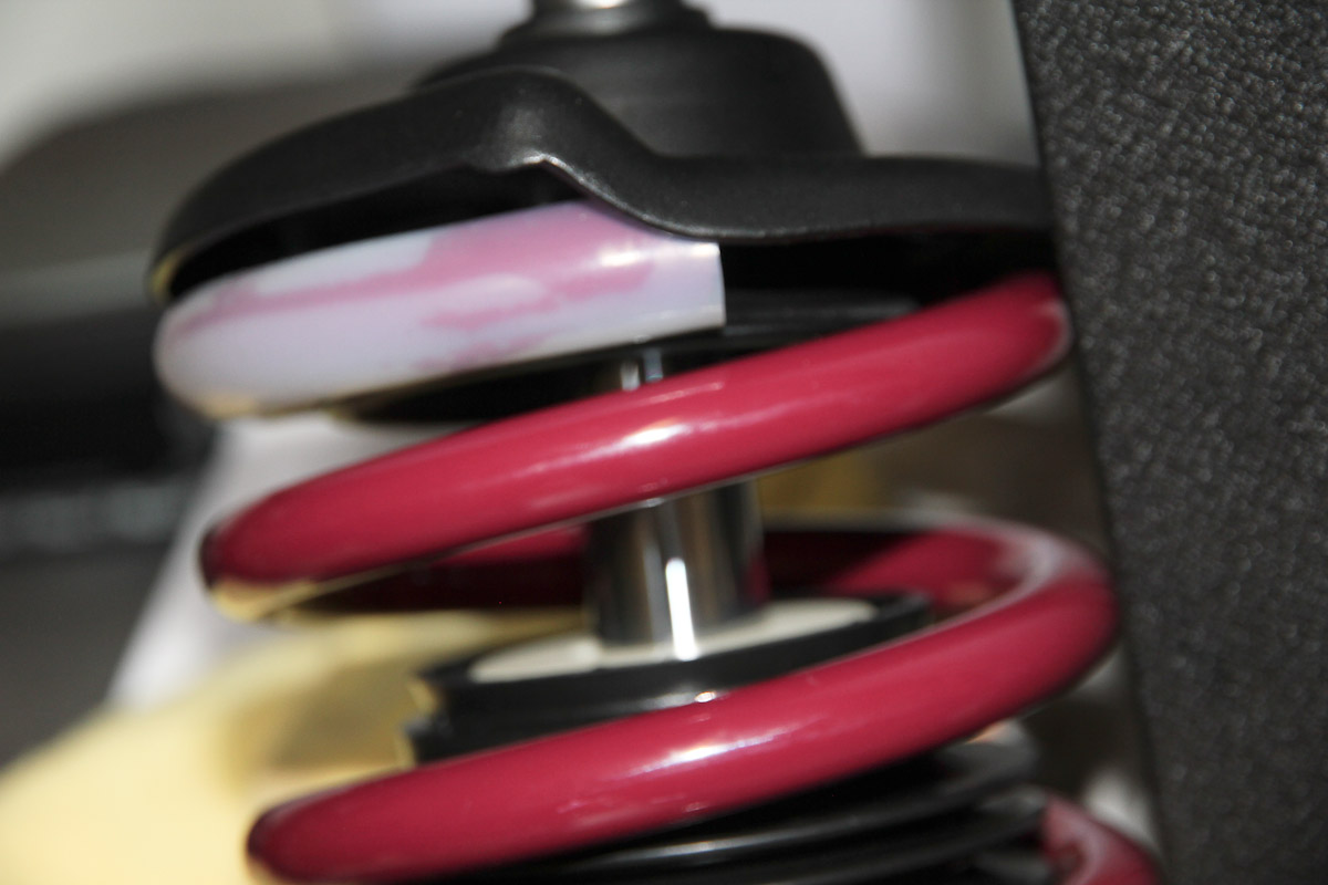

The bump stops I'm still not sure about...the instructions have the tapered end pointing down, but that leaves the piston exposed when it expands, which seemed wrong.  I left them turned around so the taper fits into the top of the perch.

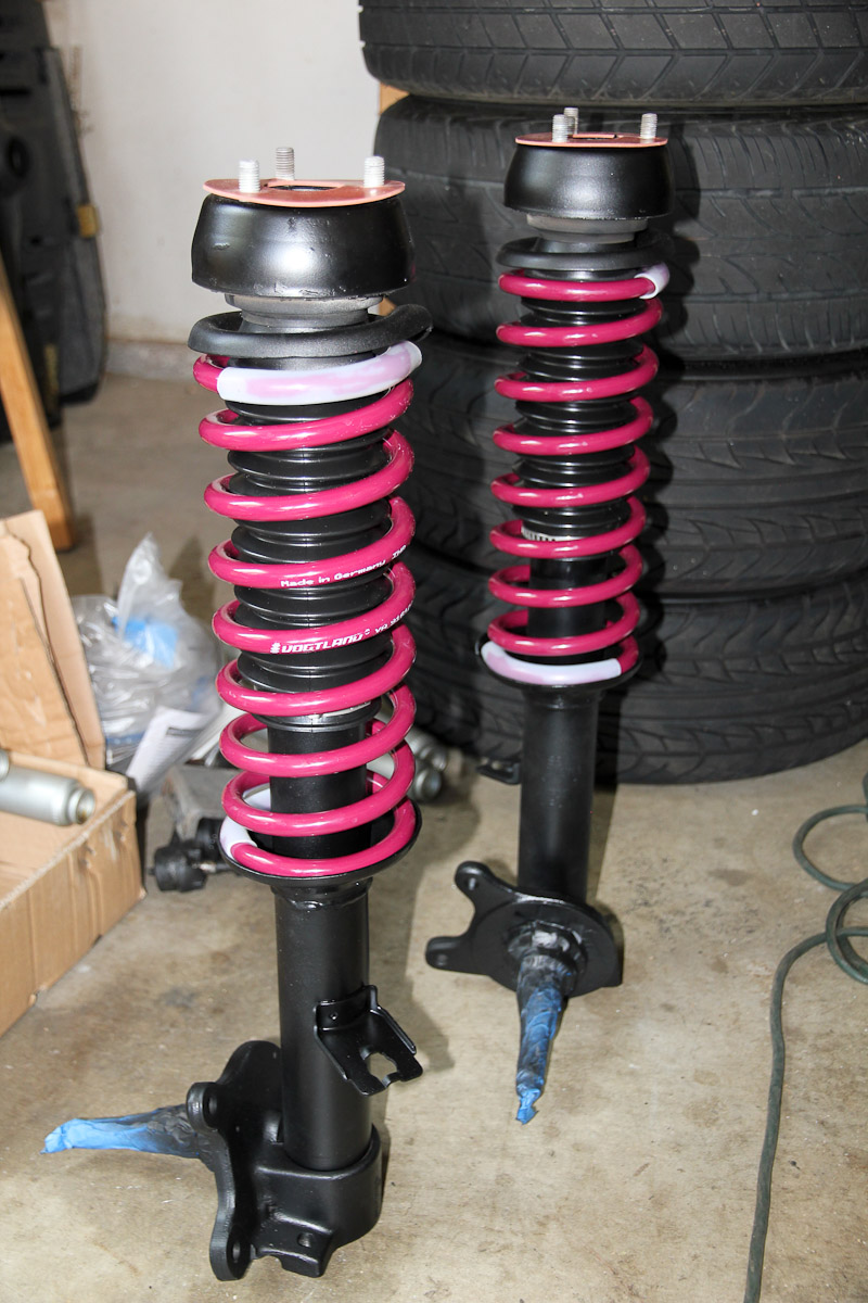

The outer rubber layer on the insulators was long gone, so I got some 1/16" rubber sheet and cut some "washers" to stick on the top.  The fronts, ready to be installed, and in the car.  Suspension Techniques sway bars went in too.  Progress!

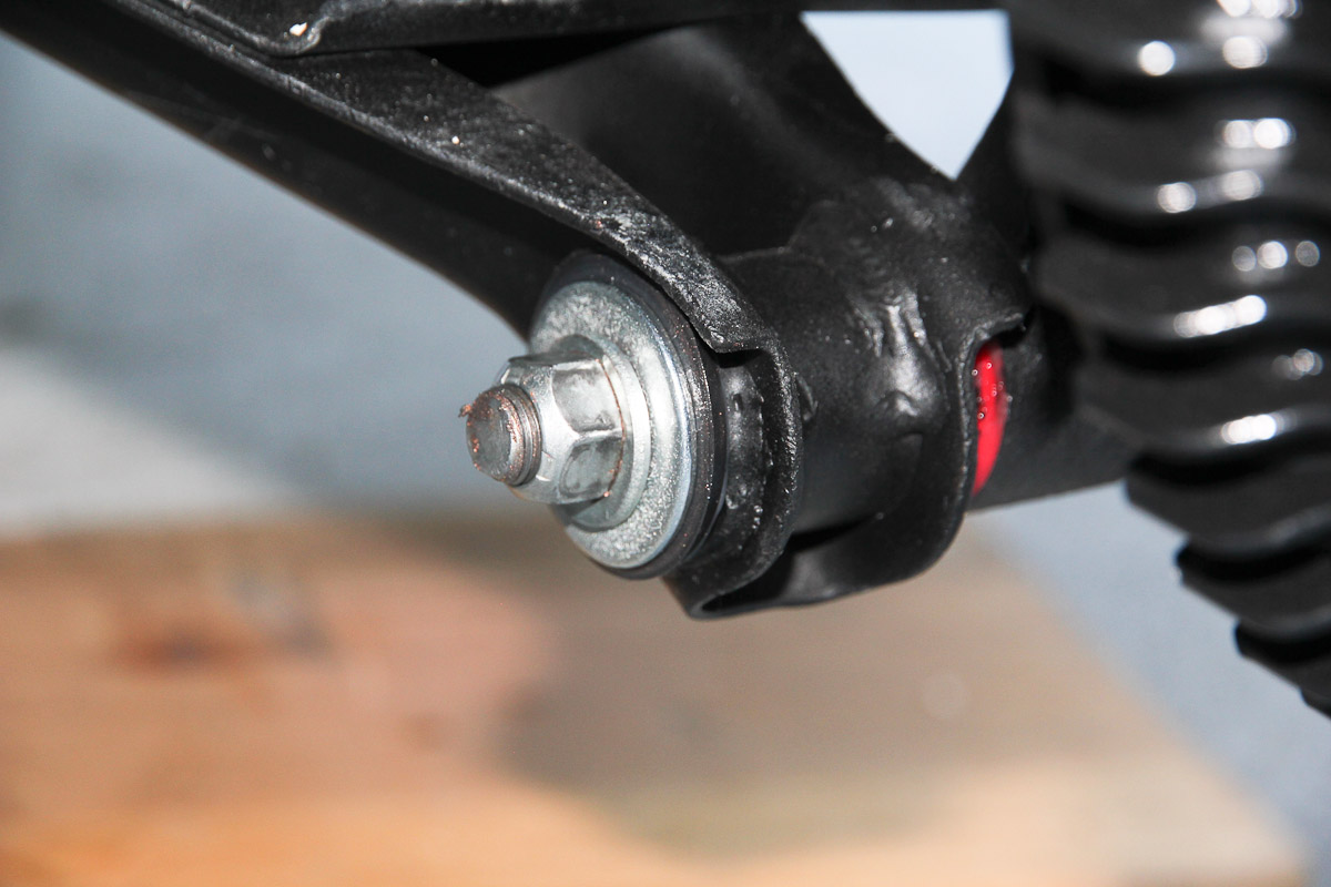

The troubles with the rear end I don't need to revisit, but it's back together as well.  The driver's side, complete with 2 black bushings, just to be matchy.

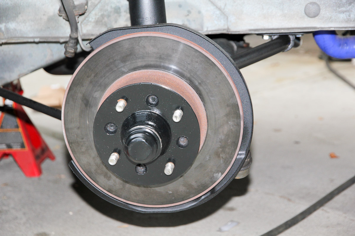

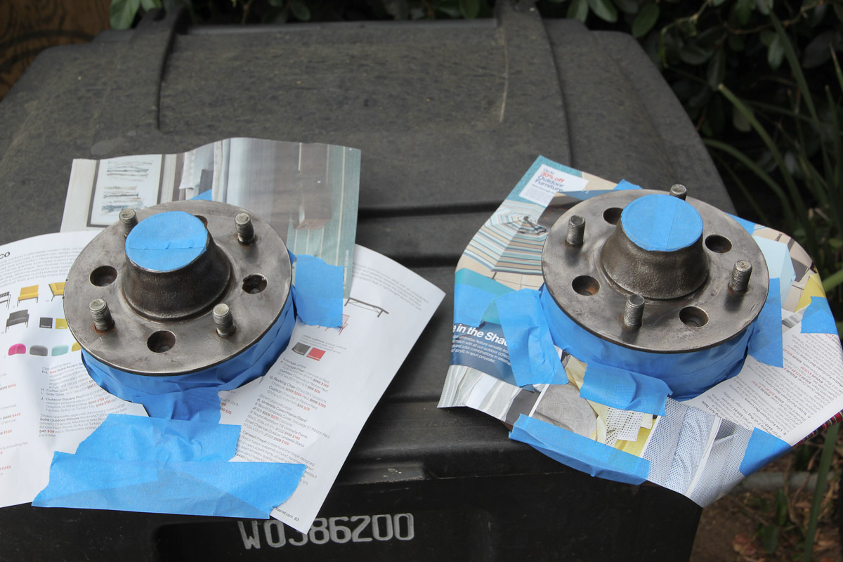

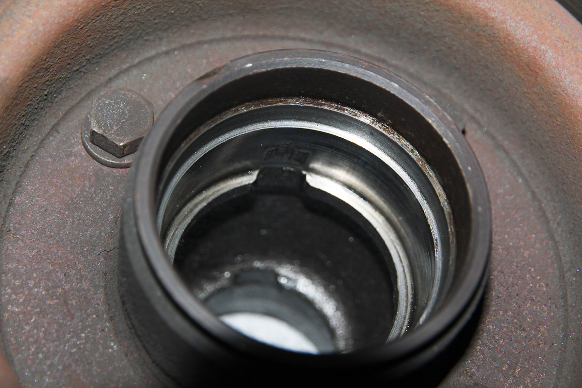

This weekend I moved on to the hubs.  They were kinda rough looking and a bit rusty, so I hit them with a wire wheel and some high-temp paint I had left.  The bearings looked decent-enough when I pulled them out, but one of the POs did -- big surprise -- a lousy job greasing the hubs, and a complete set of Timkens was something like $30, so I figured replacing them now is cheap insurance.  Not too many pictures here...cleaning and packing a hub with grease is messy business, but here's what someone before me managed to do when knocking out a race.
post-30129-0-21348000-1437352438_thumb.j post-30129-0-06142100-1437352439_thumb.j post-30129-0-12684300-1437352446_thumb.j

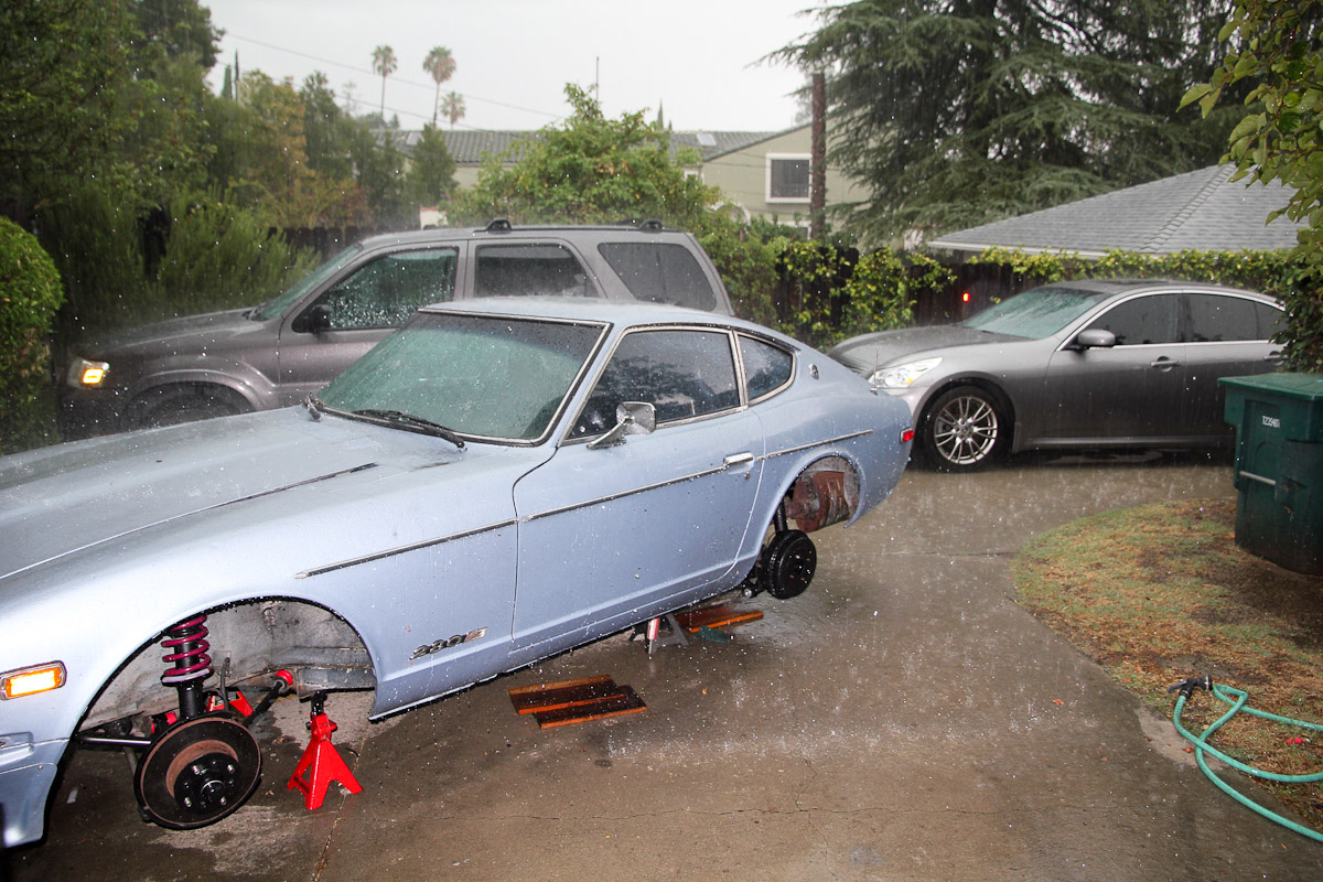

Both sides are finished and my parts piles are getting smaller!  Then nature intervenes.  Despite being in the middle of an historic drought, it still manages to rain whenever I want to work on a car.  There's always next weekend.

That is some good work Charlie!  Yeah, mother nature seems and Murphy's Law seem to sync up when we work on our cars.  I like your idea of using the self adhesive foam to take up the room in the strut boot.  On the bump stops, when I installed my poly bumps stops in my '72 240z, the tapered end was facing down.  I did not install a boot around them but at the end of the day no matter what direction they are facing I think they will accomplish the same thing.  Maybe someone who has had experience with them installed both ways will post up.

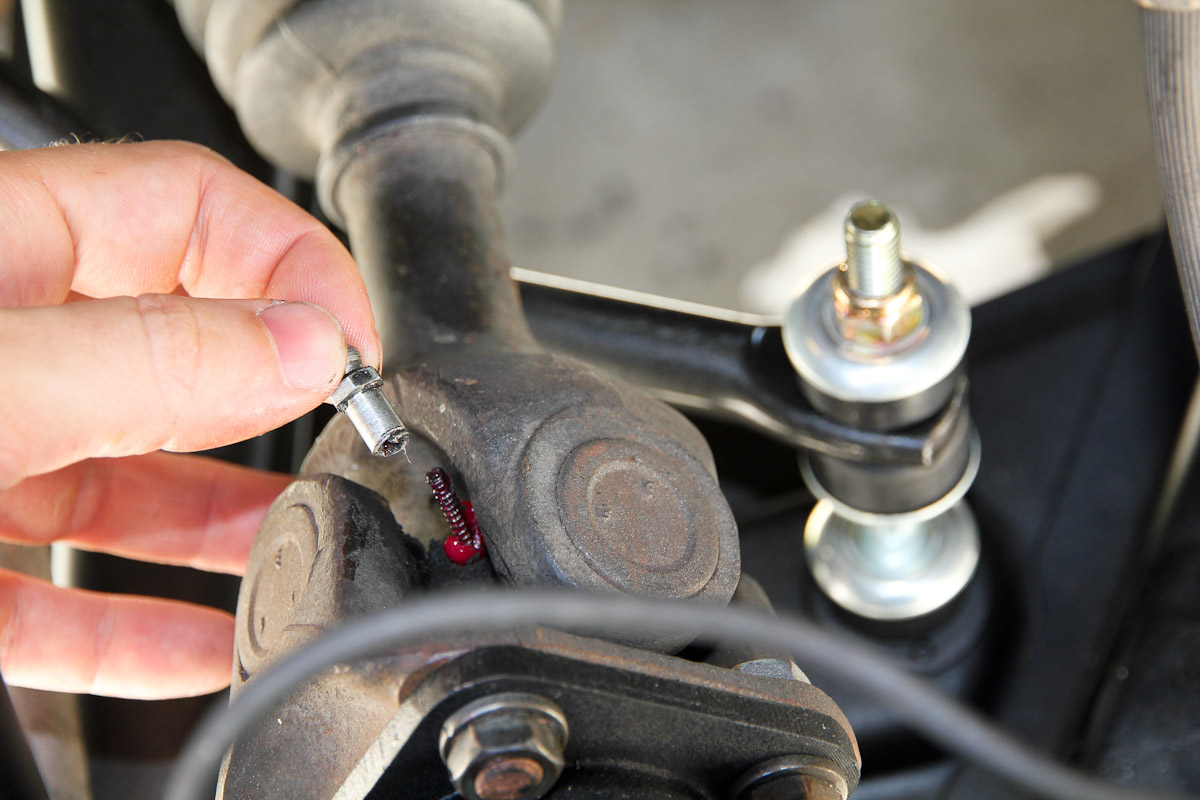

This morning, I went to Harbor Freight and bought a grease gun for the ball joints and tie rod ends.  First time I've greased anything with a zerk fitting in probably 20 years!  But naturally, nothing goes without problems.  One of the half shafts has a fitting, so I figured I should grease that one too.  Can't hurt anything, right?

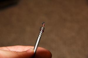

Not right.  Snapped clean off.
post-30129-0-18830400-1437868715_thumb.jpost-30129-0-06483200-1437868714_thumb.j

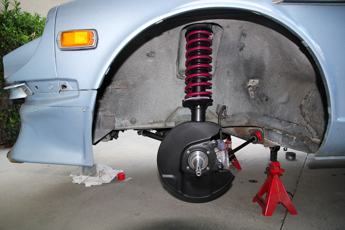

Back to the hardware store to get a screw extractor.  For once, at least, the gods smiled upon me: it came out easily.  Back to the same hardware store to get a screw to plug the hole.  Local hardware store has everything except 1/4" - 28 machine screws.  Special trip to OSH, then, and back to work.

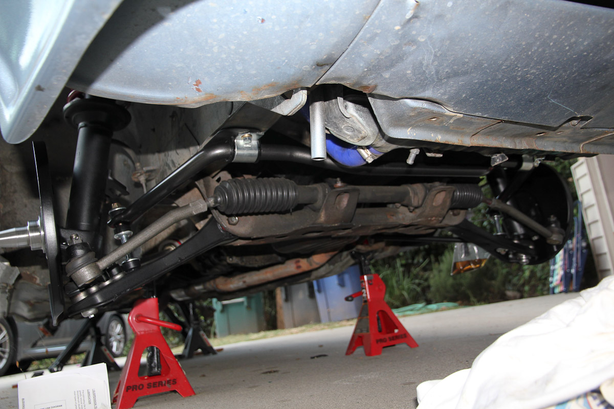

Bled the brakes, everything else goes back together without incident and the car is finally sitting on its own wheels!
post-30129-0-28796600-1437868712_thumb.jpost-30129-0-24845900-1437868711_thumb.jpost-30129-0-26481600-1437868716_thumb.jpost-30129-0-17901600-1437868713_thumb.j

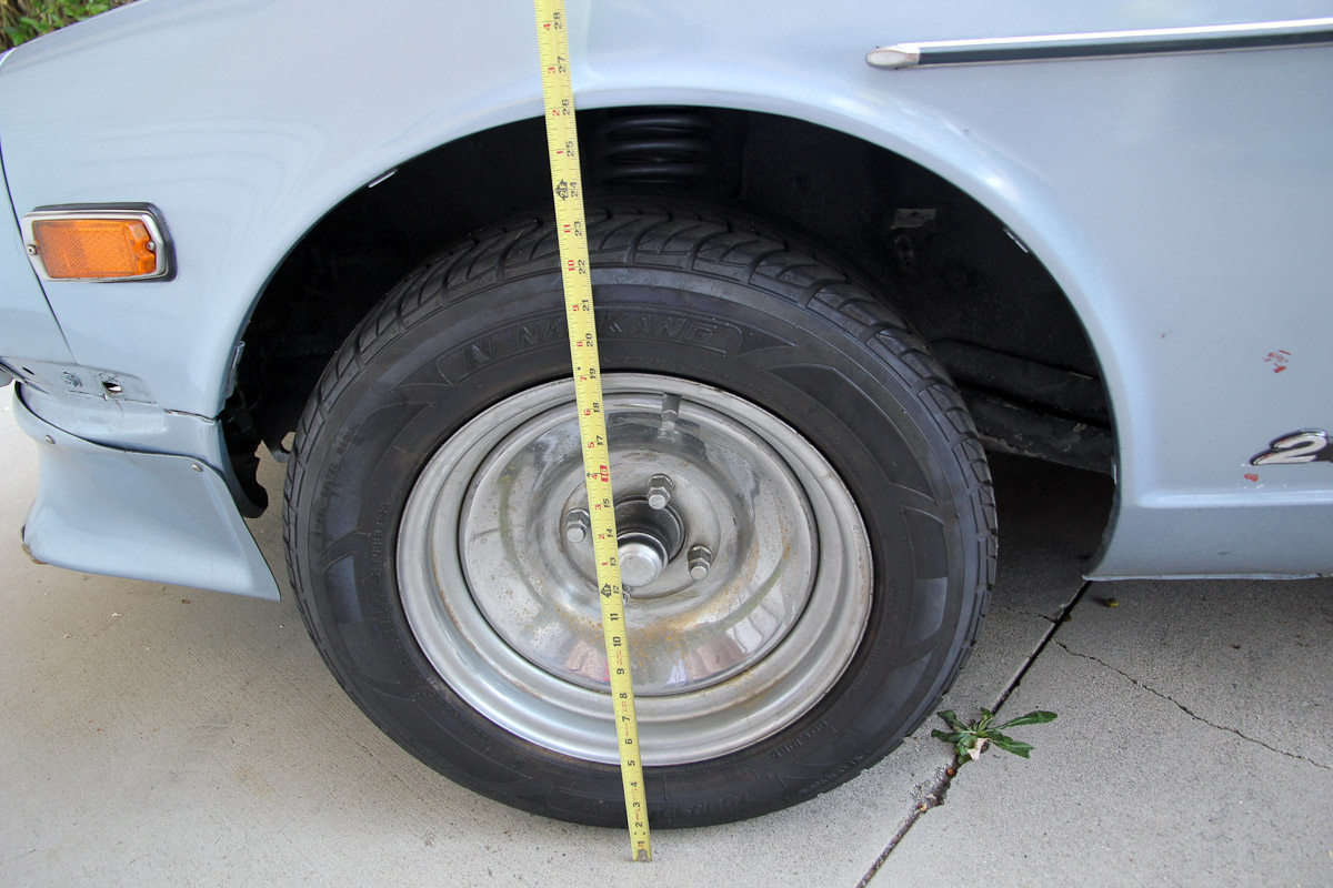

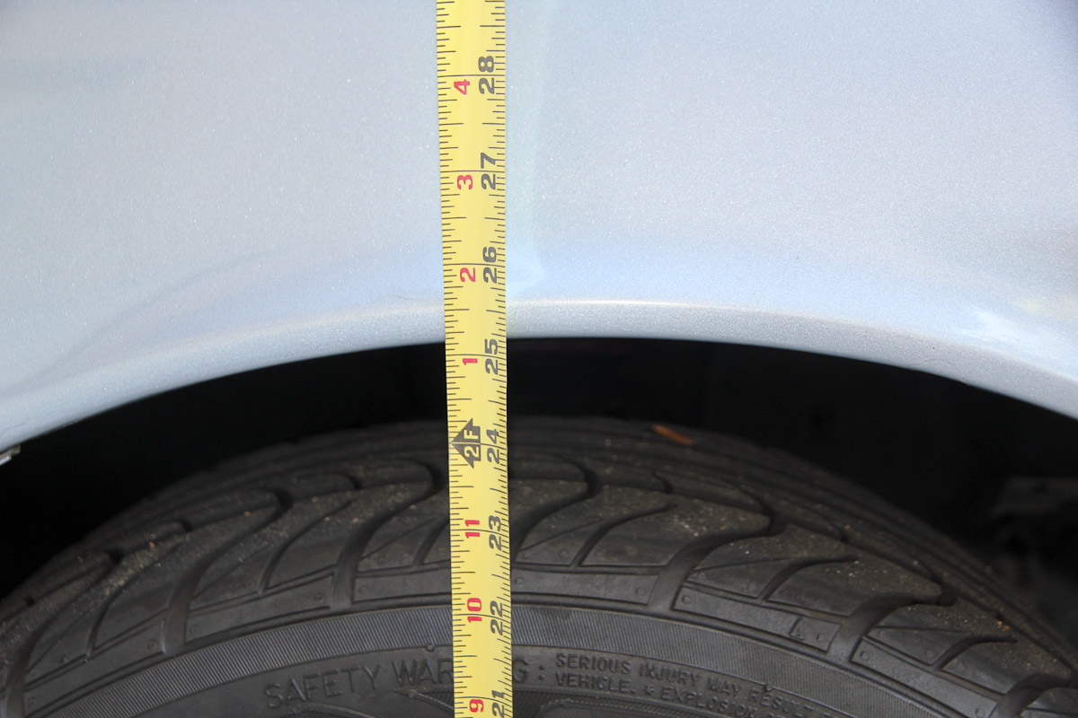

Overall drop ended up being about an inch all around, but it'll probably settle a bit more.  I'm actually pretty happy with way it's sitting.  The wheels are kind of a bummer.  Just another item for the shopping list!

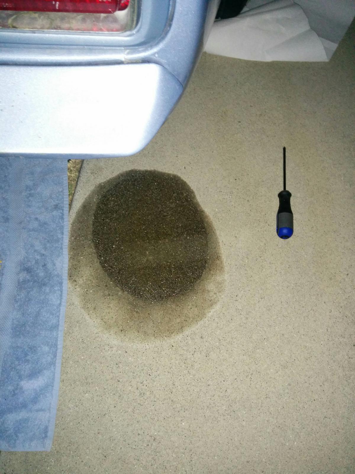

Filled the car with gas and took it out to run a few errands last night.  Walking down the driveway I thought to myself "Huh.  Smells like gas out here.  That's weird."  On the way back up, one of the outdoor lights comes on and I see a puddle.
post-30129-0-10071600-1439480971_thumb.j
Something is leaking around the filler, but it was too dark and late for me to be able to pinpoint what or where.  I drained enough to get below the leak, so at least I won't have the fire department knocking on my door.  The damage, however, is done: the gas sitting on the tank lifted the paint, so in addition to finding and fixing the leak, I also have to re-drop, re-strip and re-paint the tank.  Wasn't exactly part of the plan.  Of course this happens two days before we move.
