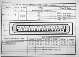

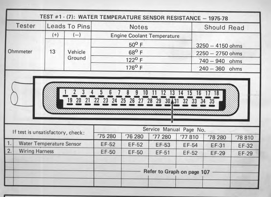

The Fuel Injection Guidebook makes it easy to check much of the EFI system right from the ECU connector, where it matters.  A meter, the guidebook, pen and paper, and you can confirm that most of the system is either right or wrong.  Worth doing at least once just so you know.
The 1975 book will have almost everything you need, but the 1980 book covers all years and will be exact.
http://www.xenons130.com/reference.html
Stuff like this.  So comforting...
post-19298-0-61189200-1430161609_thumb.p

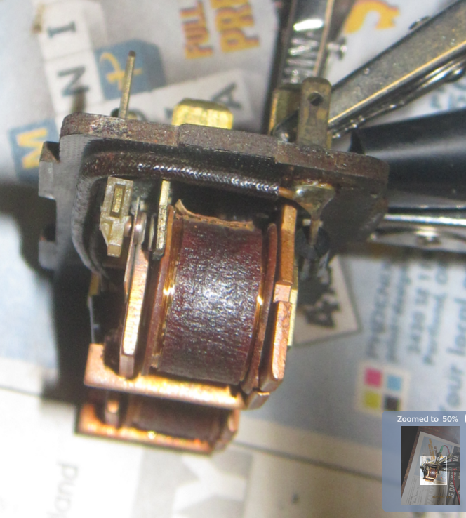

Just spent a couple of hours replacing my EFI - Pump relay because it seemed to be sticking,  Then found that it was probably just a corroded connection.  But I re-remembered a bunch of stuff and diagrammed the EFI pins.  And cleaned up the old one so it would look shiny on my desk.

Zed Head, that EFI relay looks all crispy like. I'm surprised the coil winding is still intact.

On my relay picture - I think you're right and it wasn't corroded connections.  I dinked around with it some more after I posted that, with a 9 volt battery and a meter, and the EFI coil opened up to super high resistance and quit working.  Out of nowhere, just like the problem in the car.  When I had the problem in the car, I removed a spark plug and it was dry, even though I have a second switch to run my pump independently.  No injectors opening.

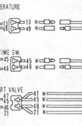

found this picture showing alll the switches/sensors on the thermo housing. The broken one pictured above is shown in the bottom right of this picture. It looks like the temp switch not sensor. Could this be the issue or should i move onto the ecu connector?
