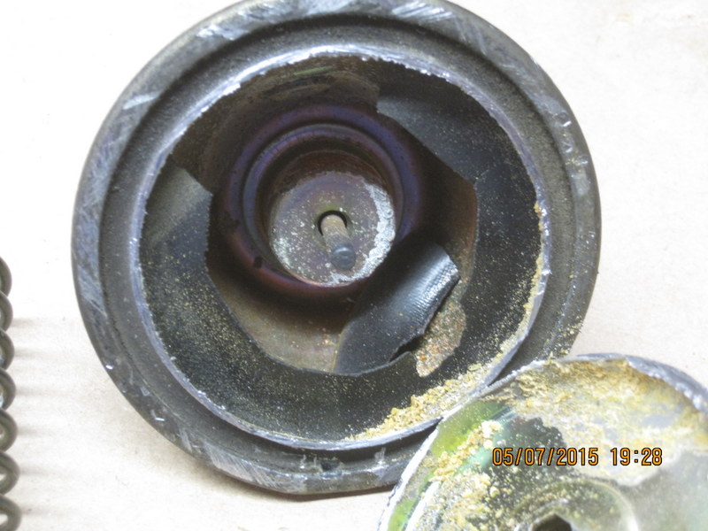

I feel like I should thread this for future problem solvers.  It actually happens.  My engine was running weirdly, with a very light constant on-off surging at highway cruising speeds, and adjusting fuel mix with my coolant circuit potentiometer didn't have any effect.  So I took the distributor out to see if I might have a broken spring letting timing fluctuate.  Also checked the vacuum diaphragm and found it was blown.  Not completely but enough that you could blow some air through it.  The cam, weights, and springs were fine.  I'd guess that the vacuum would pull the diaphragm, advancing timing, then the hole would open and it would lose it.  Or something like that.  Put a another distributor in (I like to test my spare parts when I get a chance) with a good diaphragm and it's super smooth now.
I pressed on the lever to the diaphragm after I pulled it off and must have destroyed the remainder,  It made a crunchy noise and resistance to breath disappeared.
