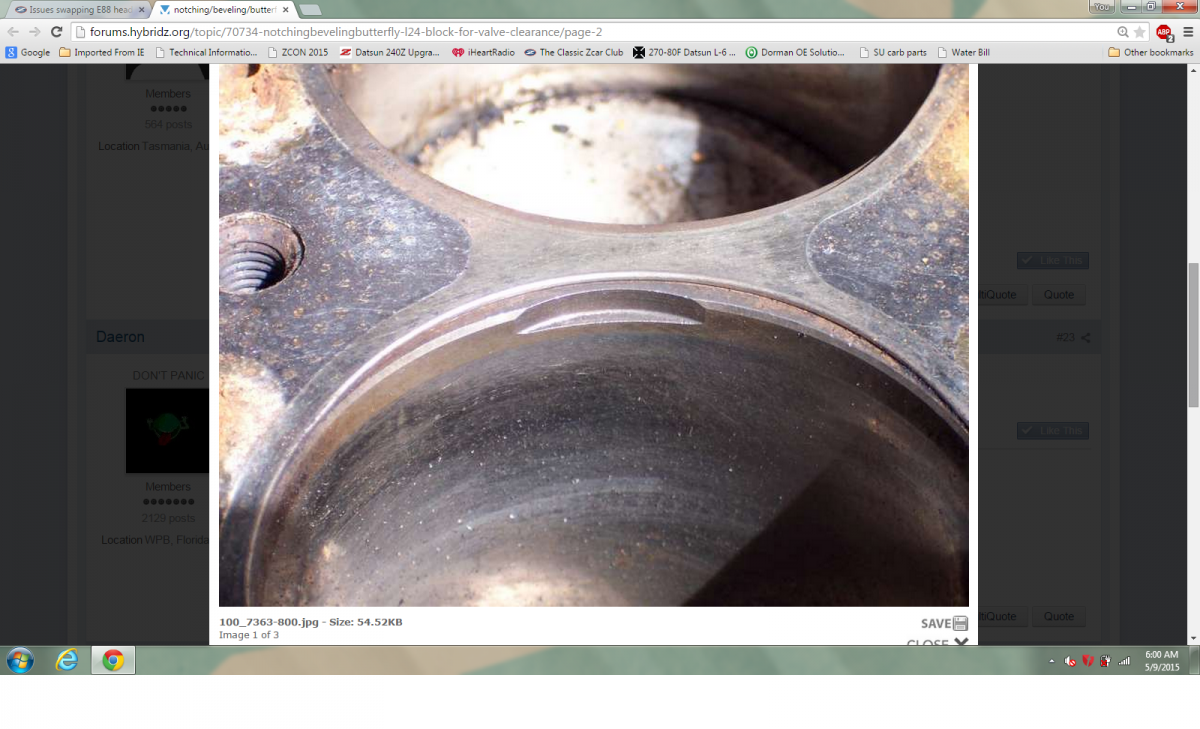

Here's some good pictures of a factory notch from a Skyline.  Post #22 http://forums.hybridz.org/topic/70734-notchingbevelingbutterfly-l24-block-for-valve-clearance/page-2
