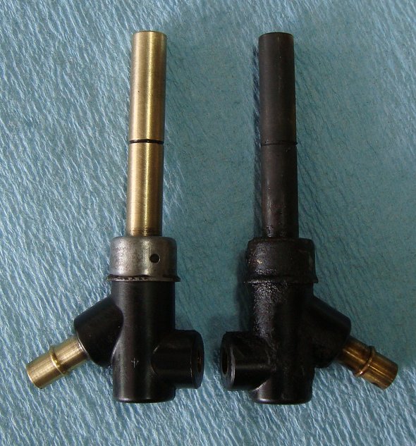

Disconnect the flat linkage attached to the jet nozzle & see if that allows the nozzle to slide up & down smoothly.The linkage occasionally needs a bit of a twist to align perfectly with the bushing & screw. Slide the nozzle up & down with & without the jet needle in place & do the drop test on the piston to ensure the nozzle is aligned with the jet. Lube tho outside of the jet nozzle before reassembly.

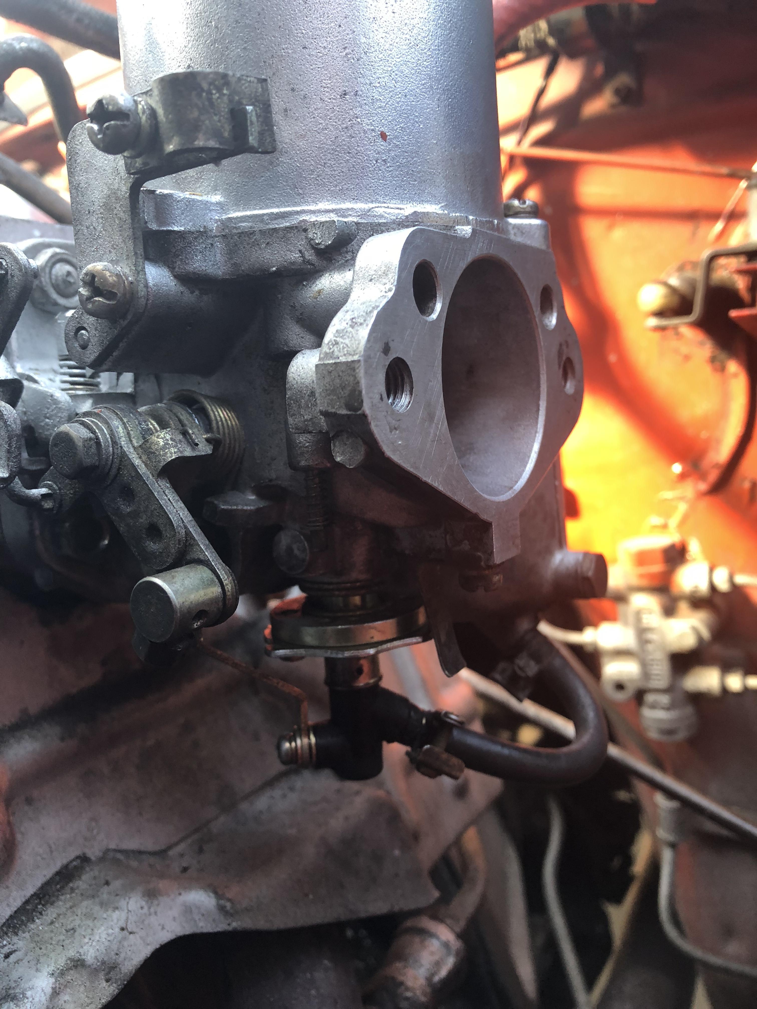

I'm no expert but when it happened to a set I bought I disconnected the hose and twisted the nozzle until it would pull out. It just old gas/ varnish that has it stuck. Pull the hose and slowly turn it until it loosens up.
