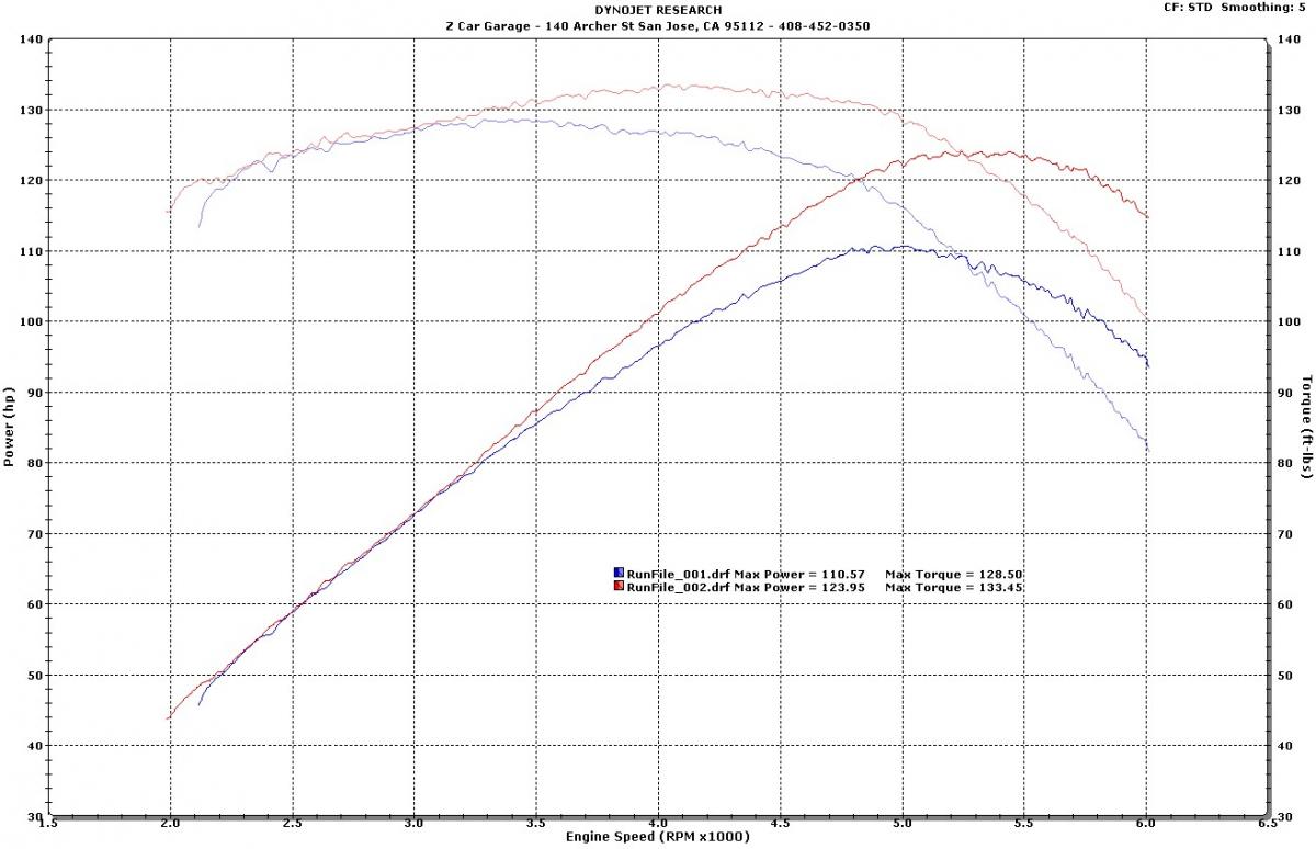

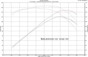

-previous owner rebuilt the engine (don't know specifics but Dyno results attached - post tune and exhaust upgrade)
