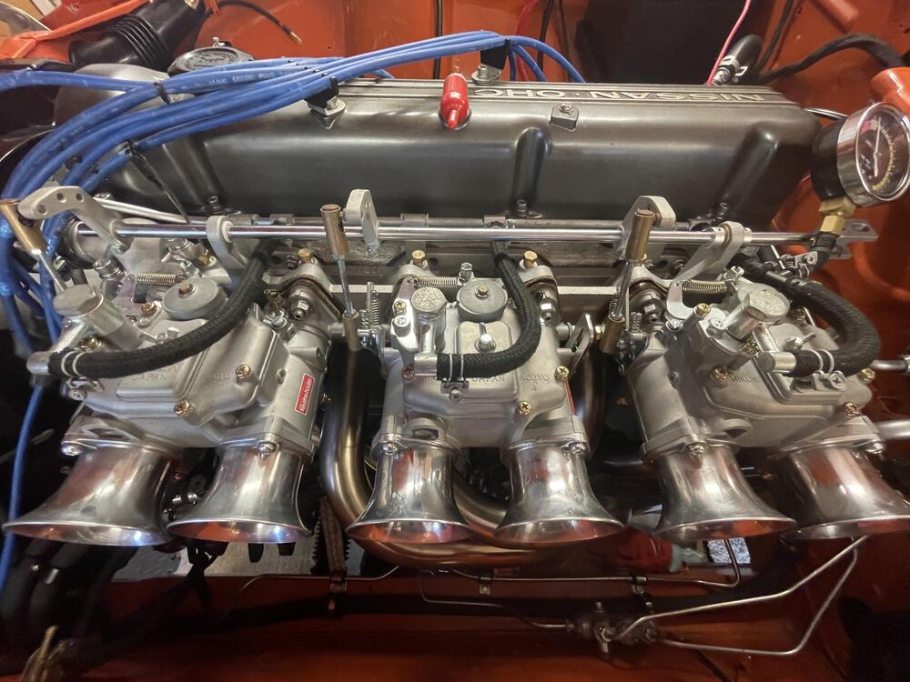

It’s alive… sort of.
I’ve been making little tweaks to try to get base timing dialed in, but there’s a lot out of whack right now and it’s a slow process.
Today I checked the float levels, which were all at 12mm, set the idle speed adjustment screws and idle mixture/pilot screws to 1.5 turns, and primed the float chambers.
After tweaking the throttle screws a bit it is starting pretty easily, but it’s rough as hell and the timing is out of whack (26 to 40° at various points).
The fuel pressure is also too high because I had to pull my return lines off. They were starving the carbs the way I had them, so I’m going to have to rethink how I route that.
I guess I know what I’m doing this week.

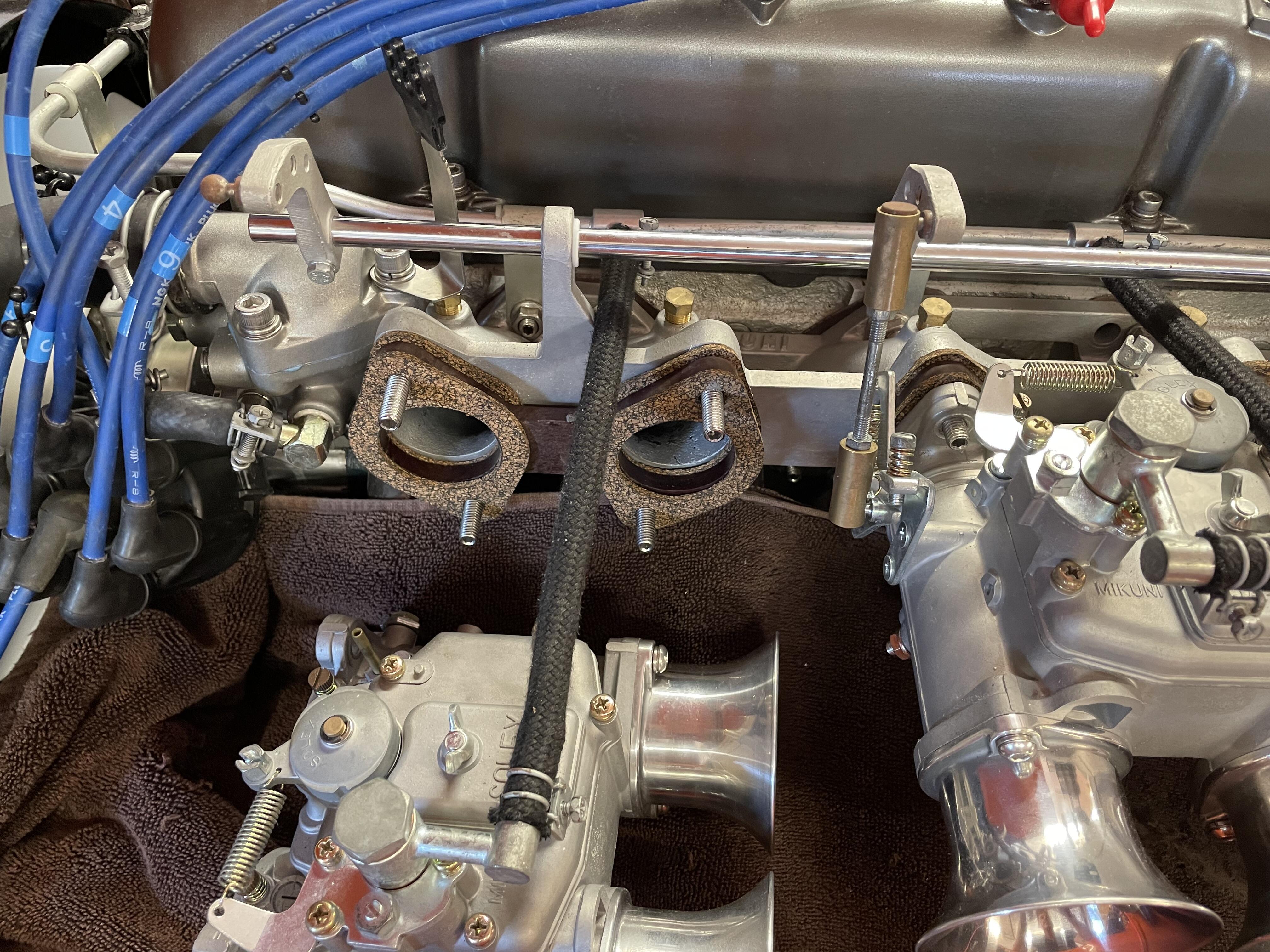

A quick little project while I wait for parts to arrive.

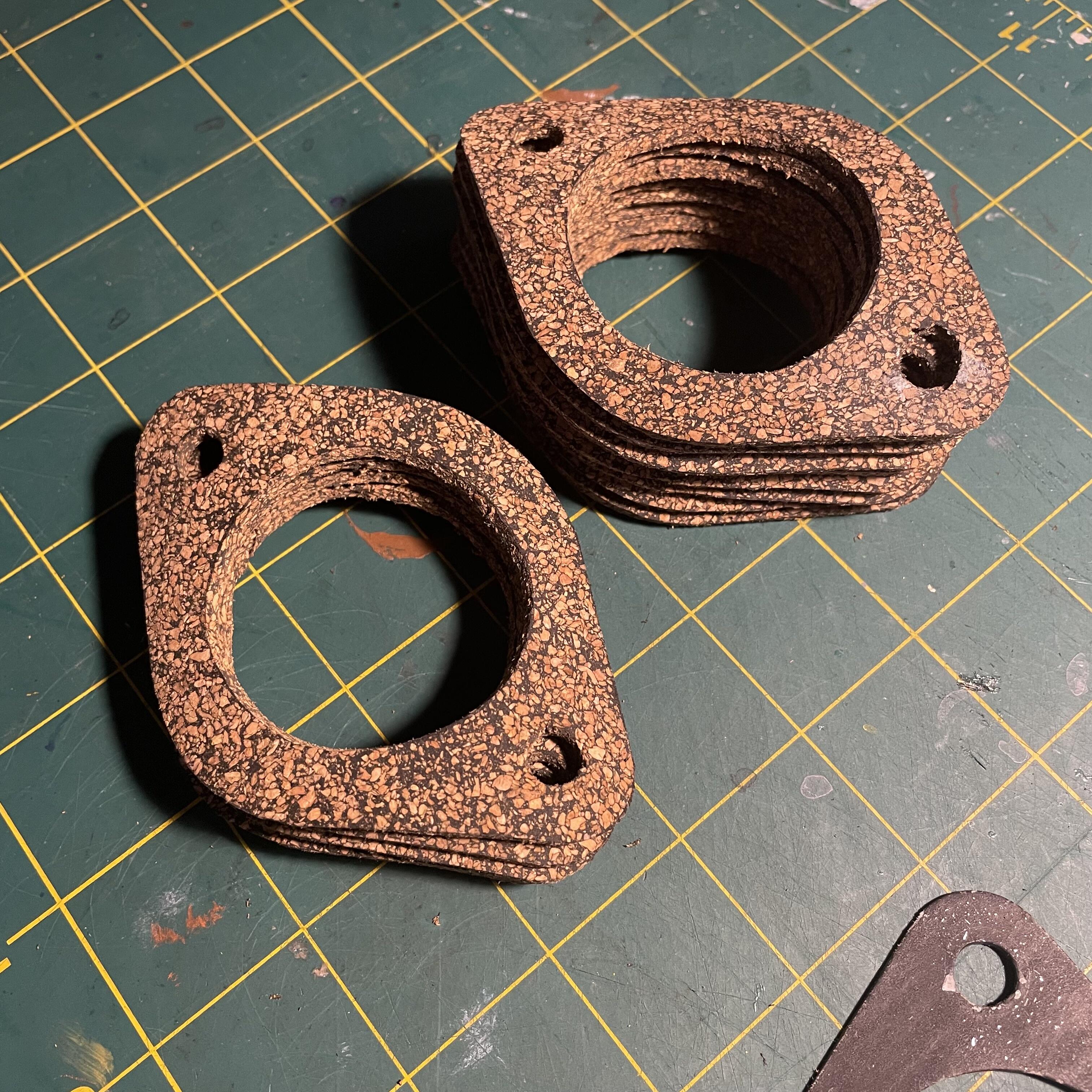

I wasn’t happy with the clearance between my throttle linkage on the no. 1 carb and the thermostat, so I ditched the EMPI paper gaskets in favor of rubberized cork.
Super basic. I used a roll of Mahle Motorsport JV123 gasket material, which is 1/8” thick (3.175mm), a template, and a pile of x-actor blades. The clearance is about double what it was.
Done and done. Looks nicer, too.

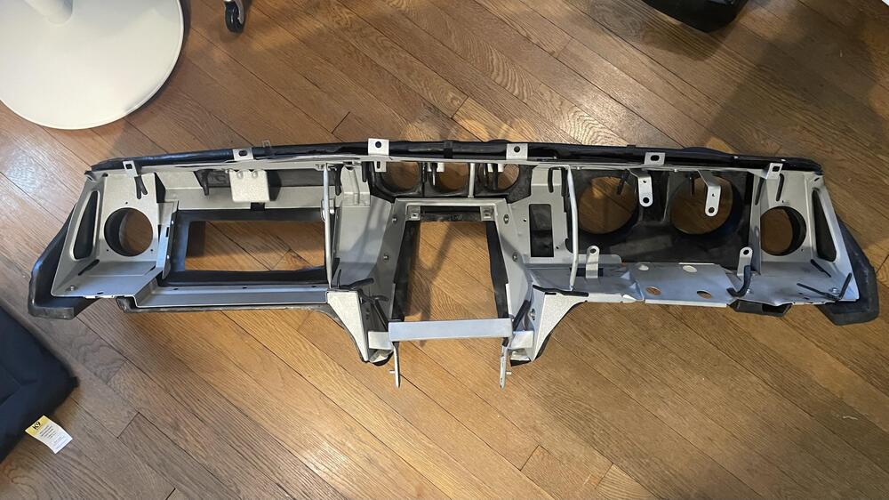

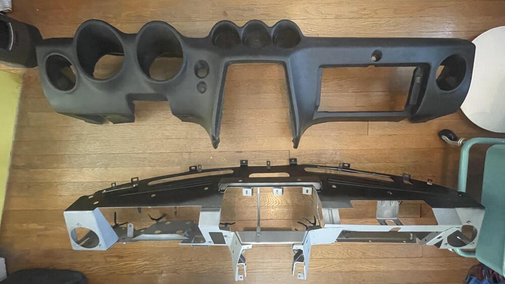

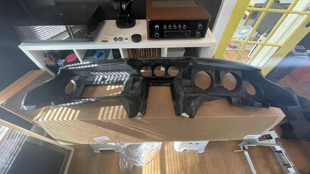

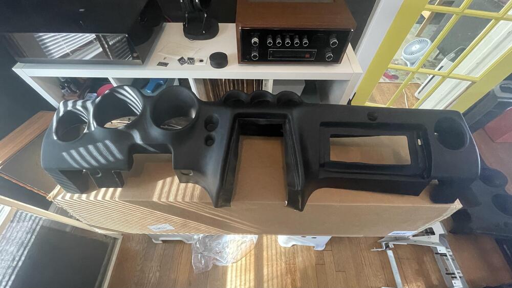

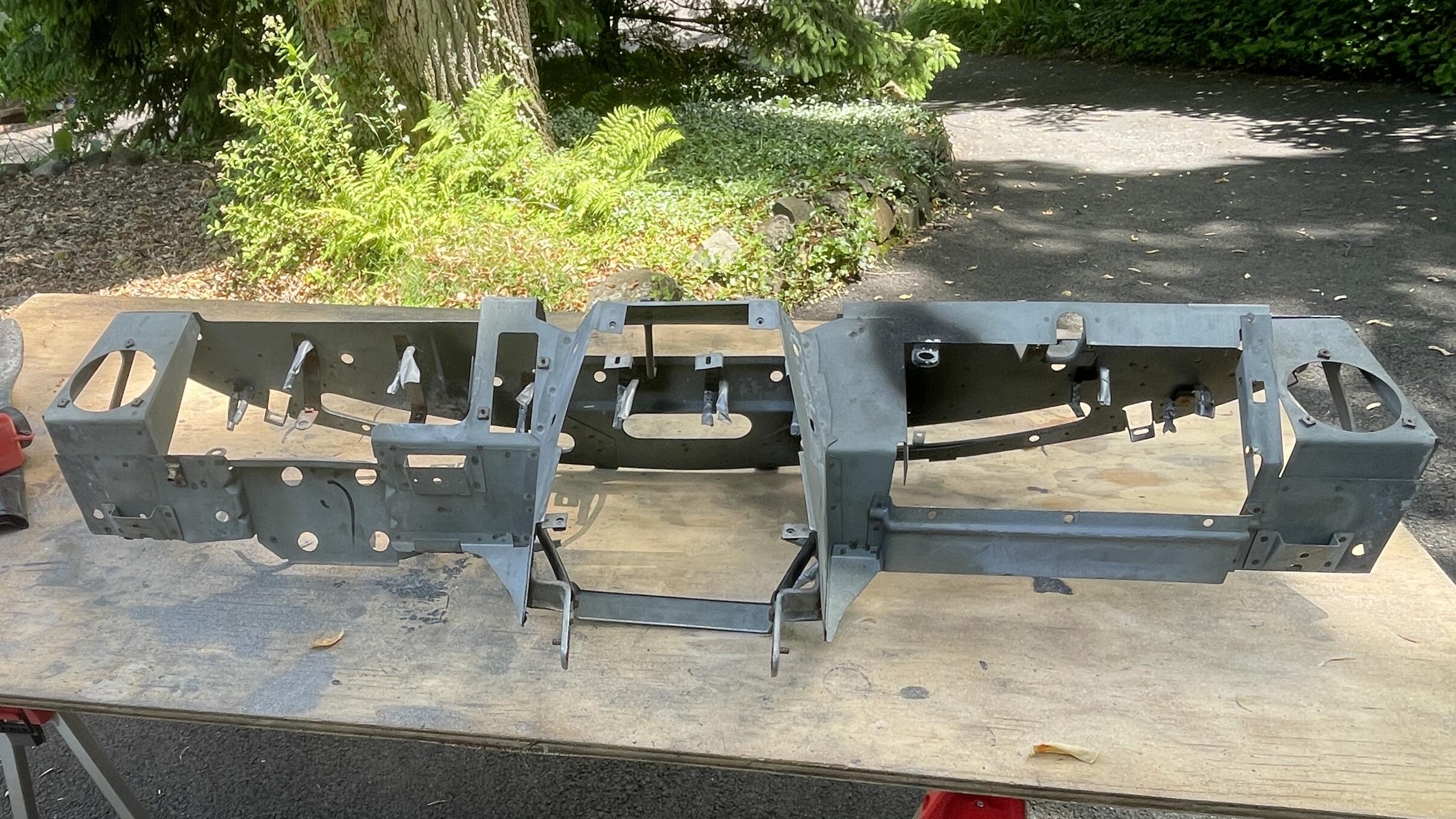

Side quest: I’ve started assembling the dashboard.
Originally I had intended to “restore” the dash I had, but after wasting a ton of time and money trying to replicate the texture (which I did figure out how to do pretty well) I realized that my dash isn’t even original. It’s one of those ABS replicas.
The replicas, while pretty true to the original, have a completely different grain pattern (droplet) than the original vinyl (hair cell). The ABS plastic is really easy to work, but it’s nearly impossible to find a compound that can accept an impression AND adheres to the ABS well. Add time under the sun magnified by the windshield and I had very little confidence of success.
So I broke down and bought a replacement from Vintage Dashes.
What tipped me over was reading that they’ve done a ton of work to match the OEM vinyl and the little details that changed from one year to the next. It’s pretty nice! I do wish the VIN plate fit over it a little better and they had left material to wrap around the bottom edges, but otherwise no complaints on fit or finish.

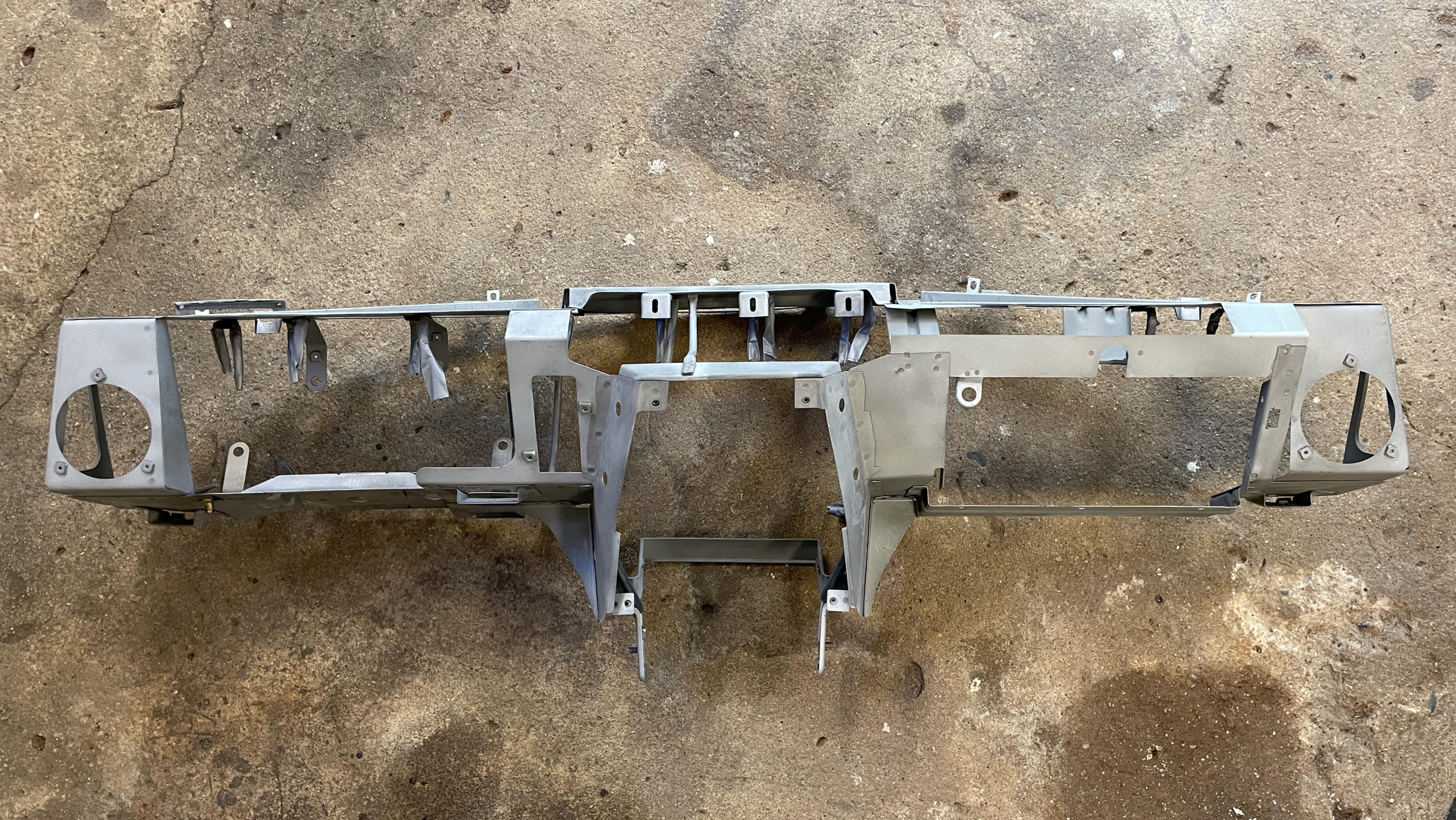

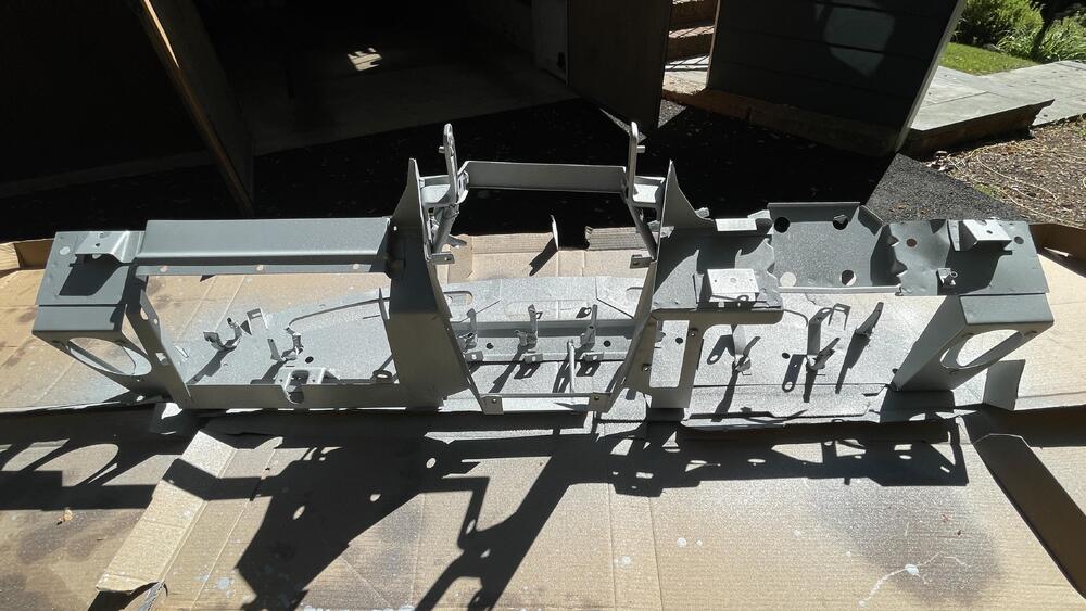

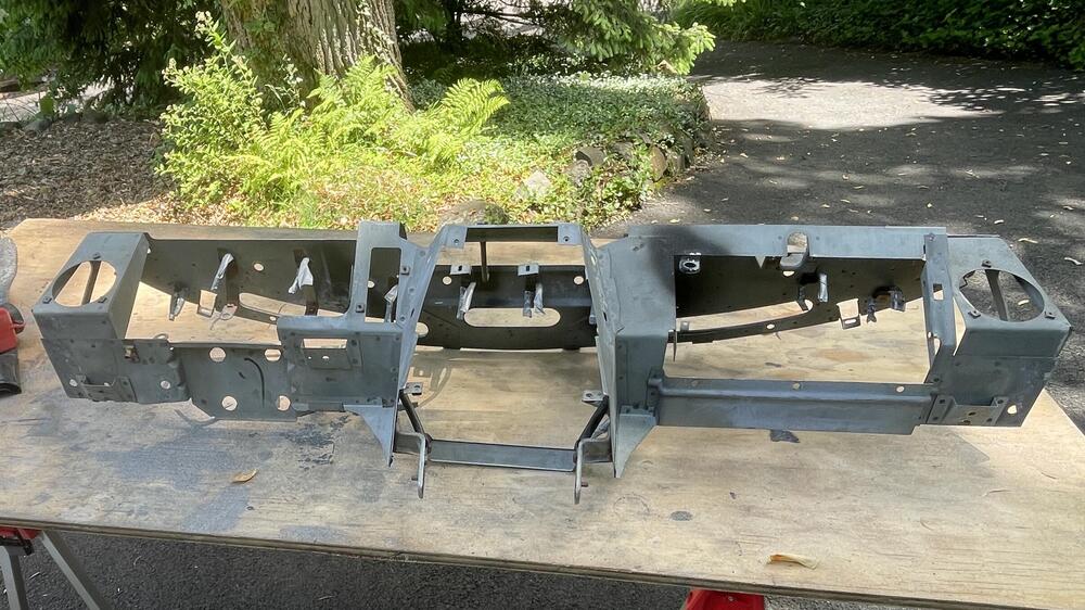

The frame was in pretty nice shape after I ripped it all apart. I sand blasted it in the driveway and gave it a coat of cold galvanizing spray to promote conductivity and keep the rust away.
The top got a coat of satin black like nearly every other part I’ve refinished for this car. The hardware sat in Goo Gone then 409 for a few hours, followed by a polish with some of my wife’s cuticle sticks. Good as (almost) new.
Next comes the instruments and accessories, followed by the glove box, then the wiring.

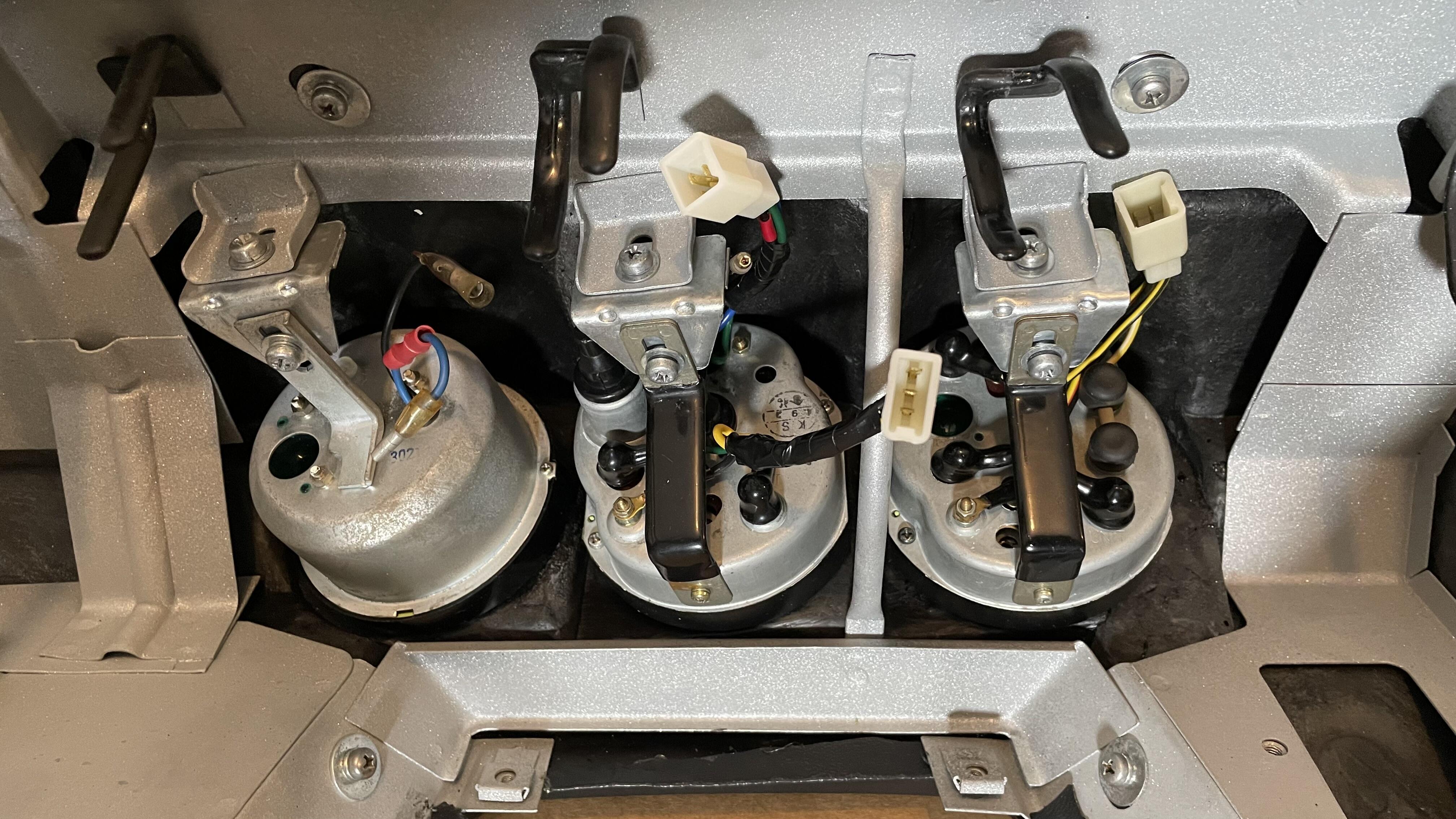

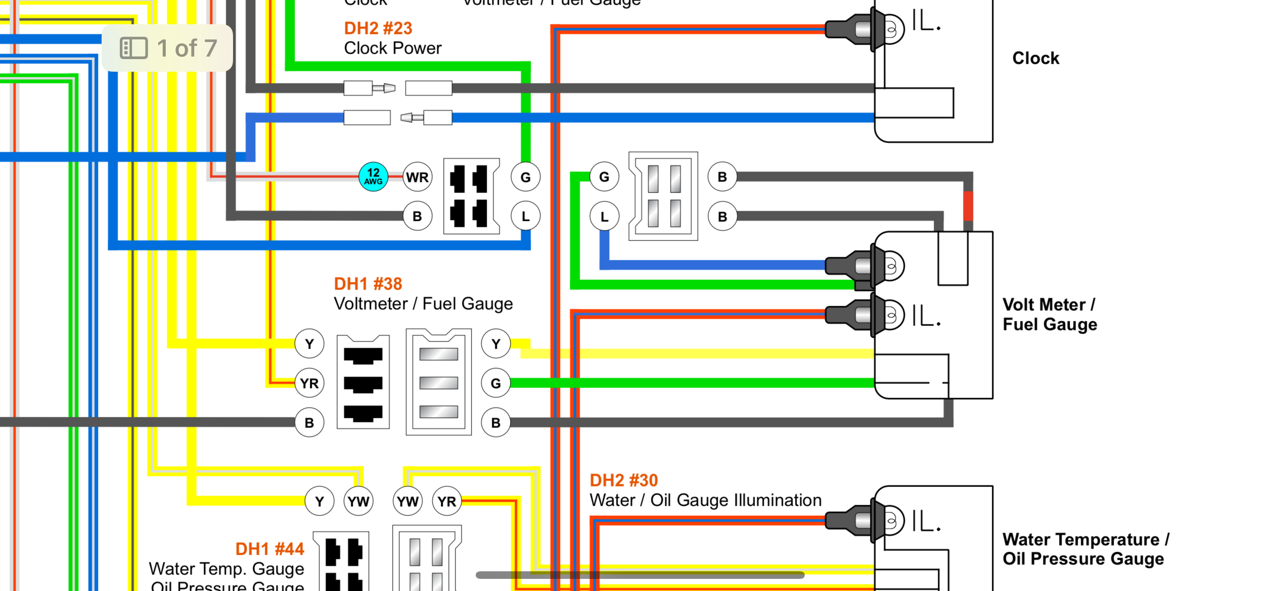

Here’s a shot of the ‘75 voltage/fuel gauge in place for anyone who wants to do this mod:
It’s a pretty tight fit getting the light under the bracket from the ‘73 Amp/Fuel gauge, so I put a bullet connector on the wire for the light in case I ever need to change the bulb. I really hope not because it might mean pulling the gauge out.
This is how I wired it up.
The green wires and black & red wire go to the fuse box. The blue wire goes to the alternator. The yellow wire goes to the fuel tank sending unit. The black wires go to ground. I kept the wires on the harness the same colors as the ‘73 rather than matching them to the ‘75.
I go into this in more detail in my wiring thread.

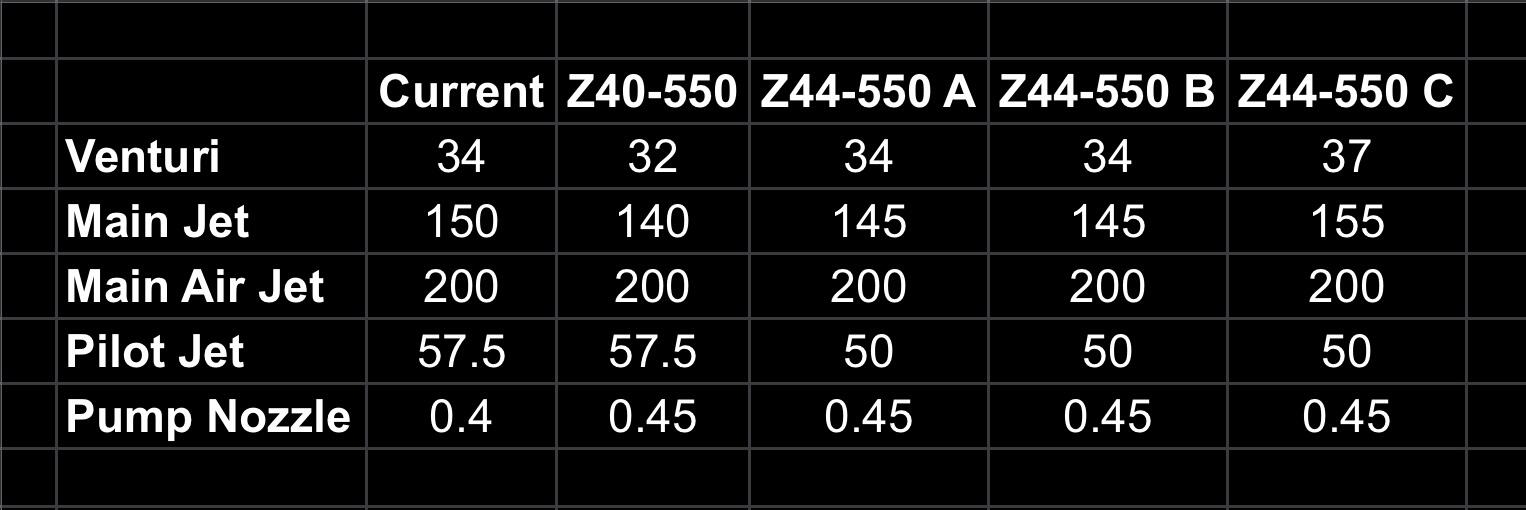

While I fix that I’m looking into changing my jetting:
Im not sure about Mikuni’s recommended pilot jet, but I will definitely bring the nozzle up to 0.45. Depending on what happens with that and adding the regulator I might be fine with 150 main jets. We will see.

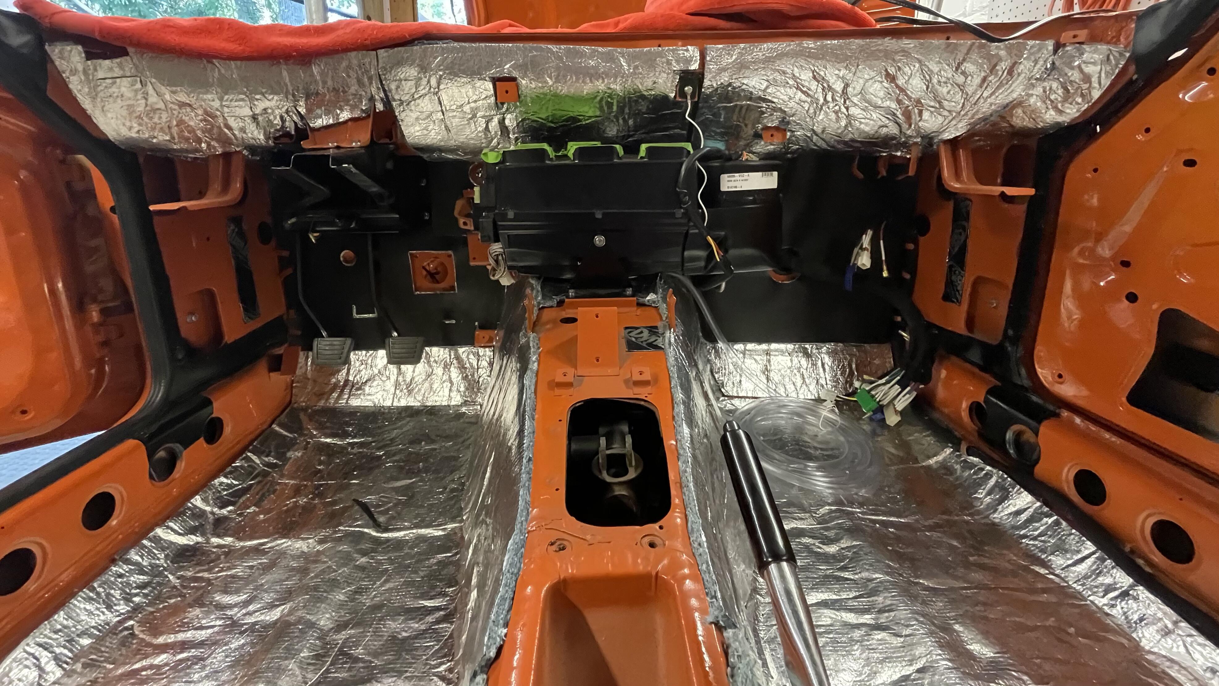

I worked on the firewall a bit yesterday and today. The dash can now go in once it’s ready (unless I forgot something as usual).
I wrapped the -10 ac pipe at the evaporator end, but the insulation isn’t long enough to go all the way to the firewall, so I may need to address that. I also need to figure out where I want the AC drip hose to exit.
There are still a handful of insulation pieces to put on the hump and the kick panels. I’m holding off because I am missing some plugs and I still need to test fit the ventilation and relay stuff. Once those are on I will tape all the joints and put a sheet over it until I order the carpet.
