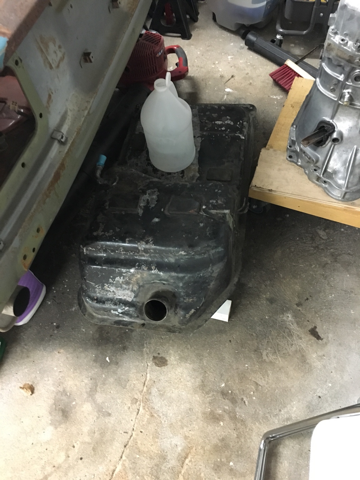

Matthew Abate Posted June 5, 2016 Author Share #175 Posted June 5, 2016 Got it out: It's currently sitting next to my garage dehumidifier with three gallons of white vinegar in it and all the holes plugged. Hopefully I can manage time to work on it every night this week, but it's raining like crazy and the humidity is insane. Thanks for the tips on reconditioning it. Once I have the thing detoxed I'll start working on that. Link to comment https://www.classiczcars.com/topic/51541-1973-rebuild/?page=15#findComment-496339 Share on other sites More sharing options...

siteunseen Posted June 6, 2016 Share #177 Posted June 6, 2016 I don't know what you've read yet but these two helped me get a better understanding of the process. http://atlanticz.ca/zclub/techtips/fuel/gastank/index.htm http://www.damonq.com/techsheets/red-kote.pdf If you'll make a plan of attack beforehand it'll really help, did for me on #2. Get some 5 gallon buckets and go ahead and mix the soda and water, have some empties to pour the dirty acid in, figure out how you want to hang the tank while draining it. The tanks have some holes around the edges, I used bungee cords. A leaf blower or good air gun will help dry it quick so you can coat it quicker. I used an old sending unit with everything cut of for sealing up that big hole and on the filler neck I used a rubber pipe plug, 2" I think. I see your clutch fork boot is torn. I bought one from my local Nissan dealership this past December, $8. They still have them available. That's the right part number in the picture below. Link to comment https://www.classiczcars.com/topic/51541-1973-rebuild/?page=15#findComment-496363 Share on other sites More sharing options...

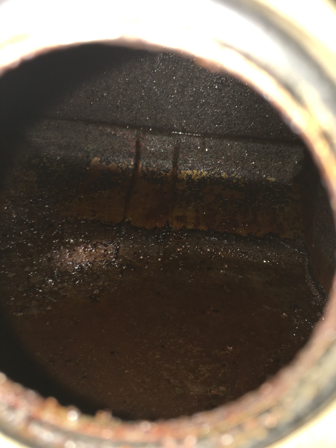

Matthew Abate Posted June 7, 2016 Author Share #178 Posted June 7, 2016 This should give you a sense of what the inside of my tank looks like: Link to comment https://www.classiczcars.com/topic/51541-1973-rebuild/?page=15#findComment-496479 Share on other sites More sharing options...

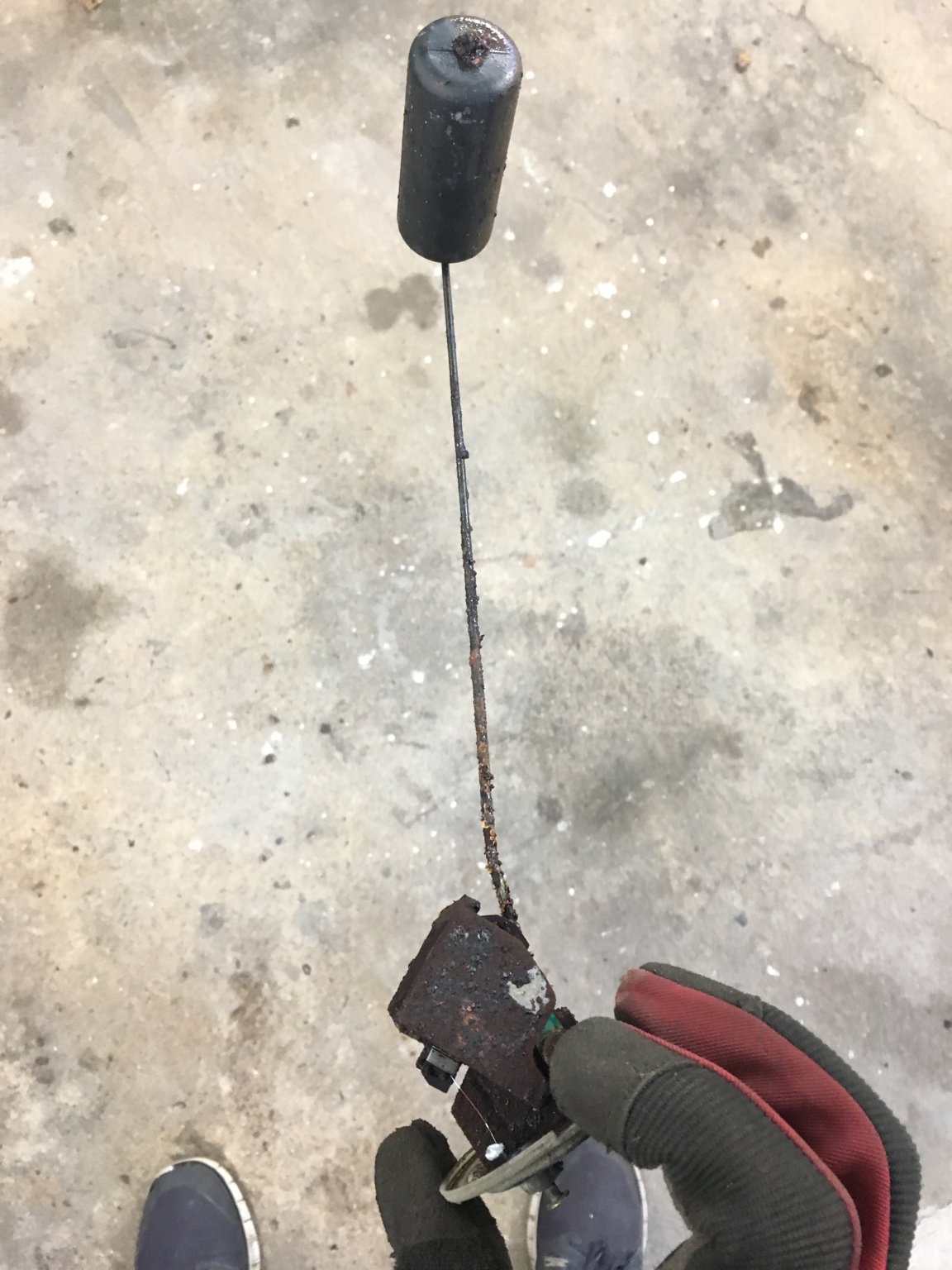

siteunseen Posted June 7, 2016 Share #179 Posted June 7, 2016 I'll post the part number for a new sending unit and oring in the a.m. I think it was less than $50 from my local nissan dealership. If you cut off the arm for sealing the opening while refurbishing your tank take pictures of the old one for comparison. I had to bend the float arm mine to match for accurate fuel gauge. Link to comment https://www.classiczcars.com/topic/51541-1973-rebuild/?page=15#findComment-496482 Share on other sites More sharing options...
Matthew Abate Posted June 8, 2016 Author Share #180 Posted June 8, 2016 Thanks. That will be handy. I got about 50% of the metal clean by tumbling a box of half inch nuts in it for 15 minutes (count them going in and out and have a magnet ready), so it's not as bad as I had thought. I am currently dehumidifying it and will fill it up with white vinegar again once it's dry. That will sit for the rest of the week I think. Then I'll descale it again. 1 Link to comment https://www.classiczcars.com/topic/51541-1973-rebuild/?page=15#findComment-496486 Share on other sites More sharing options...
