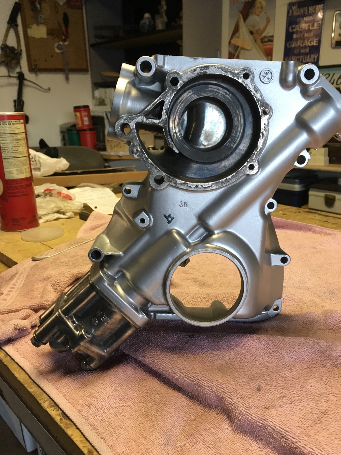

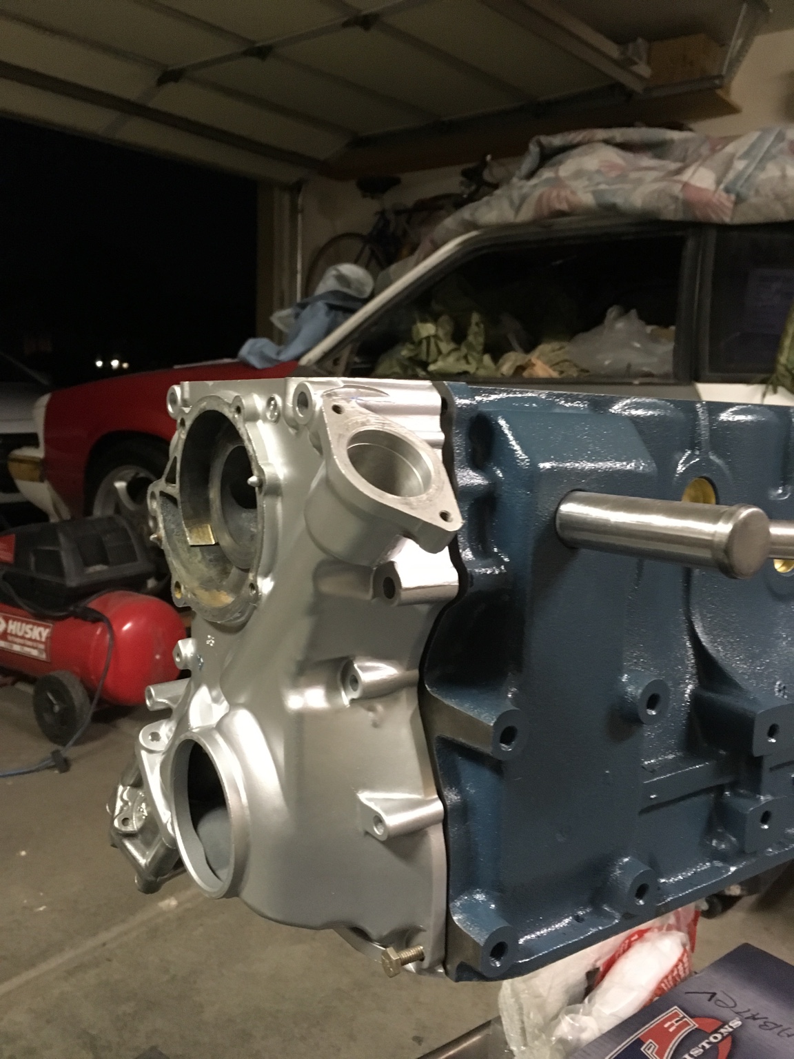

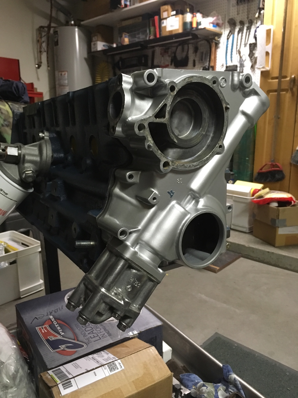

Alright, so I hear you guys on the powder coat, but we went with epoxy top coat. Check it out:
Prep
Primer
Aluminum Finish
that looks good. what kind of epoxy is it?
Eastwood primer, high-temp aluminum engine spray, then clear epoxy coat
4 hours ago, Matthew Abate said:

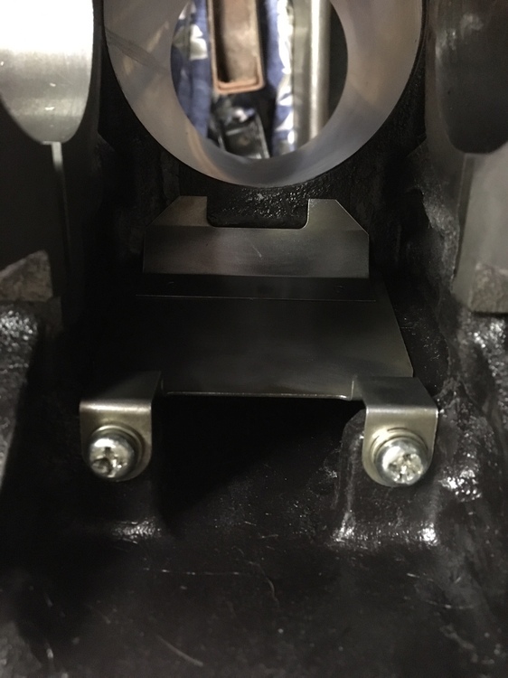

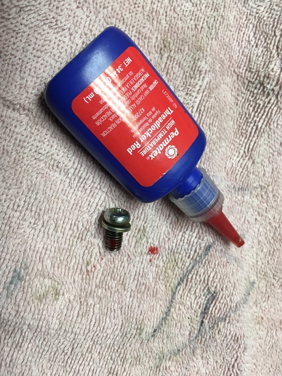

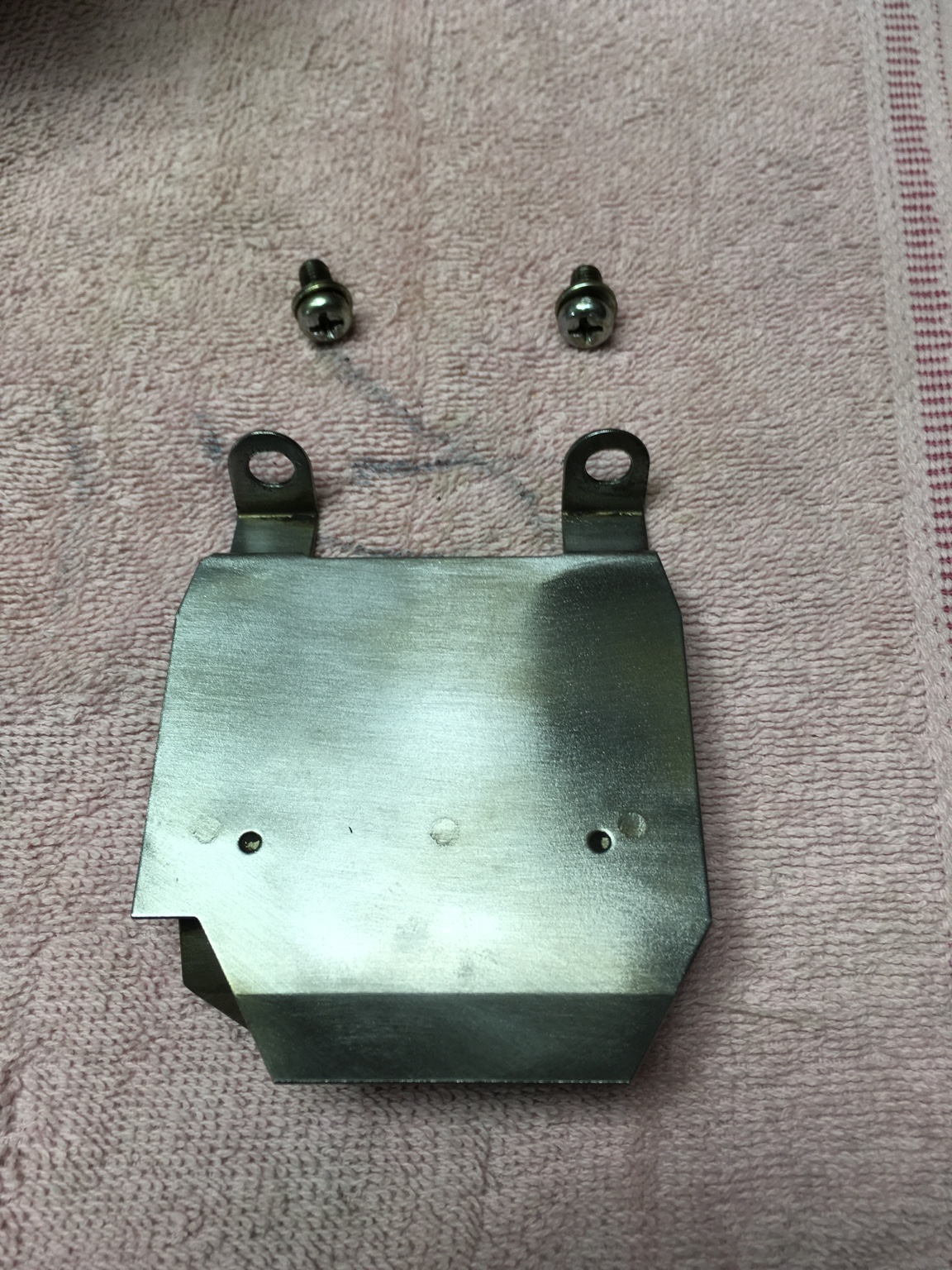

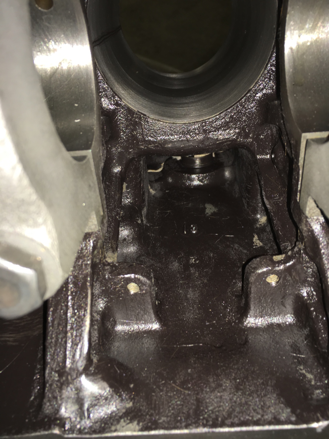

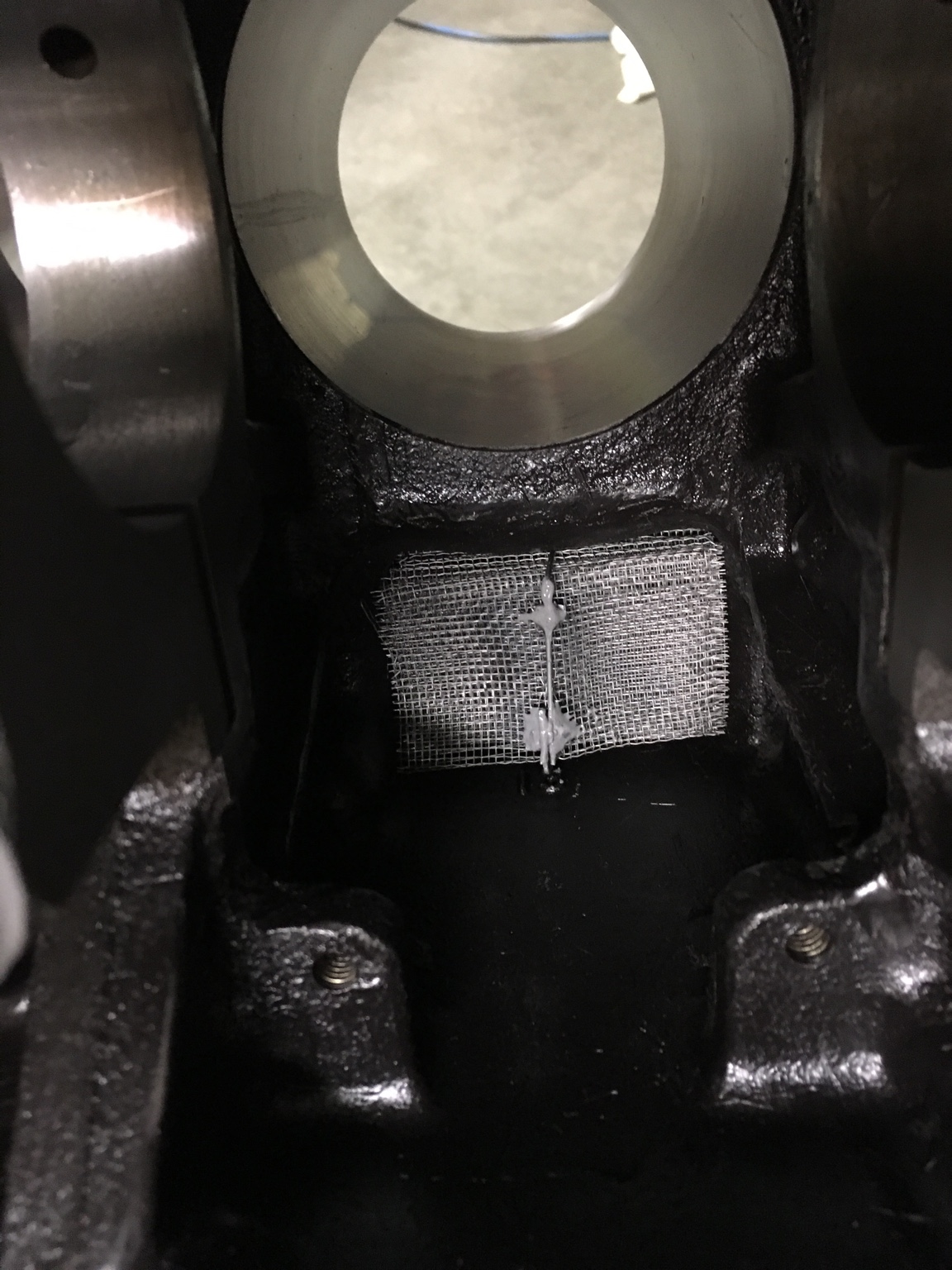

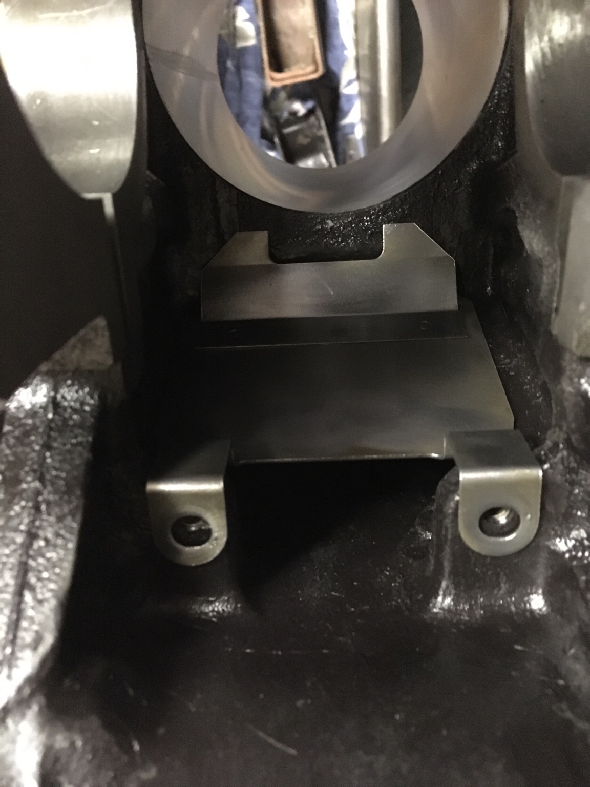

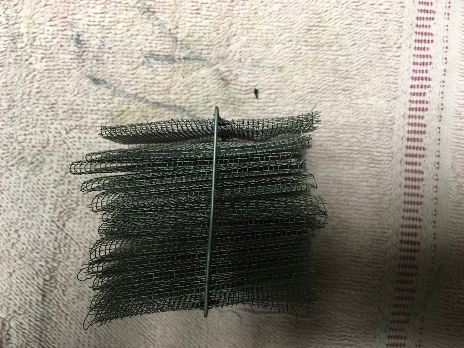

More progress:
Vent screen installation
Test fit
Very pretty.
Compared to the many photos I've seen in various L engine rebuild threads, the ones shown here seem to capture 'Nissan Engine Blue' the best.  It's more of an 'industrial' blue than an 'automotive' blue.
Also: Those may be the first photos I've ever seen (anywhere) that document the installation of the crankcase vent screen inside the block casting.
