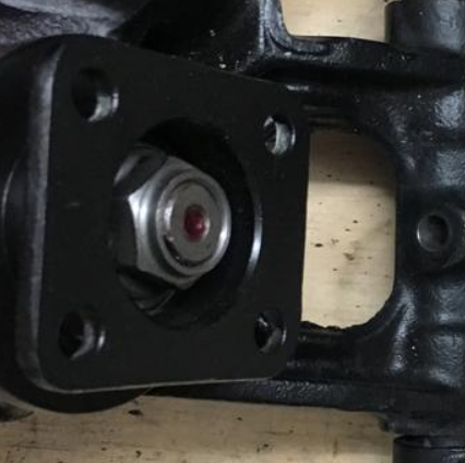

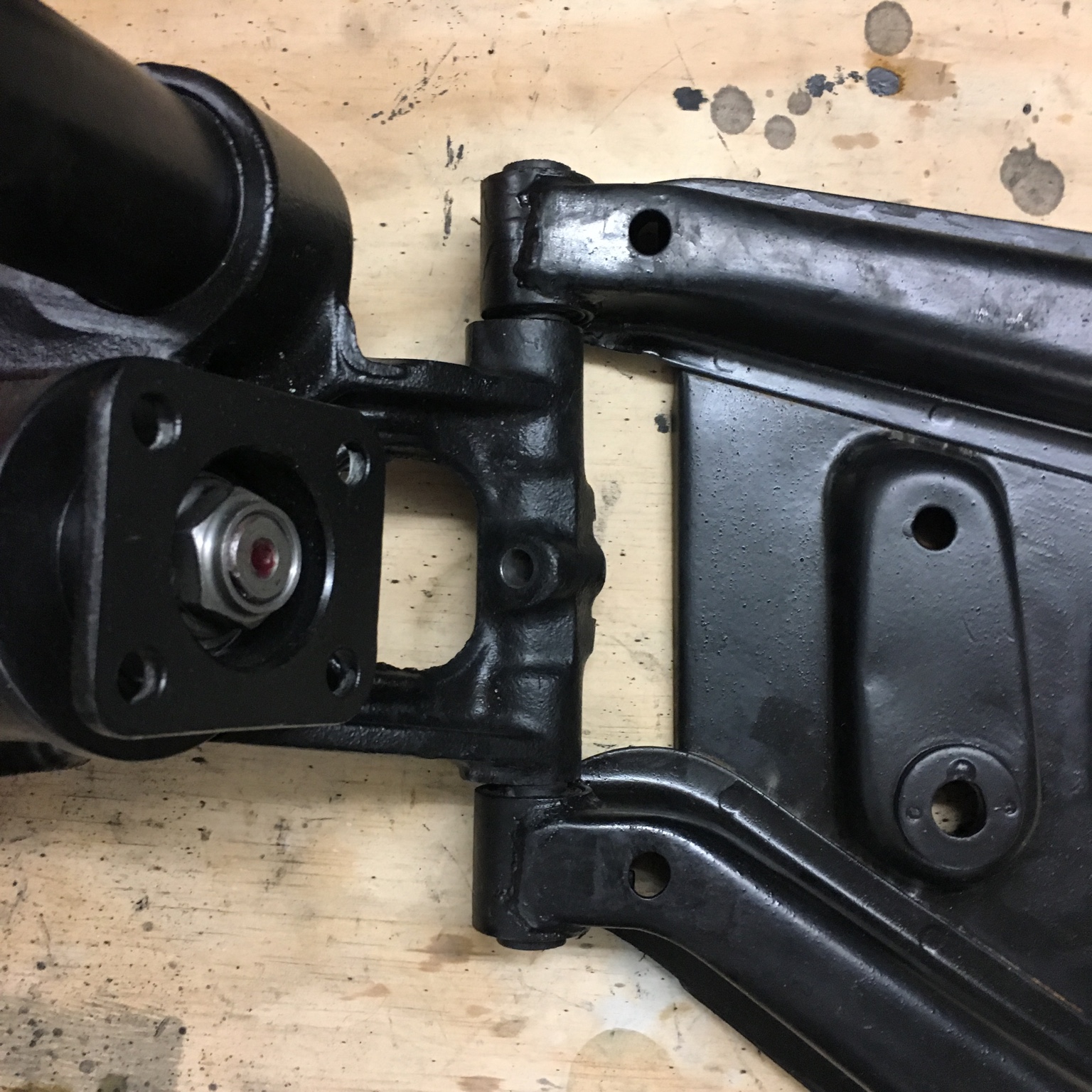

In other news, after taking some sand paper to the pin tubes on the struts, the pin slides right in. I think it must have been the POR-15 around the lip of the hole. Going to go around and do the rest of it tonight.
After that I’ll do some blue thread lock on my ball joint bolts, which came with the joints.

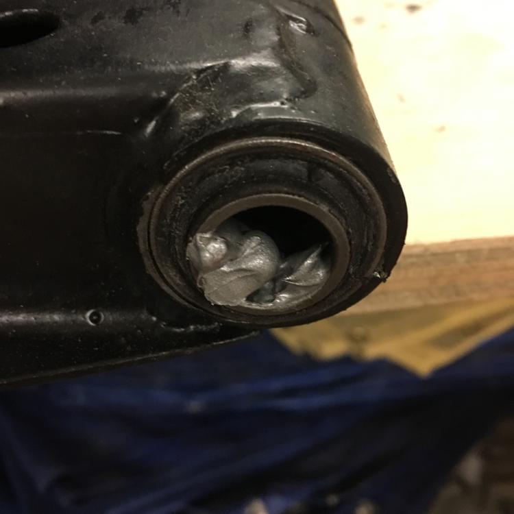

And in other news, looks like the guy that pressed out those bushing and pressed in the new one not only chewed up up the bushings but also bent one of the LCAs. I measured it and it looks like they still match, but one of them looks like it’s been in a North African rally a few times.

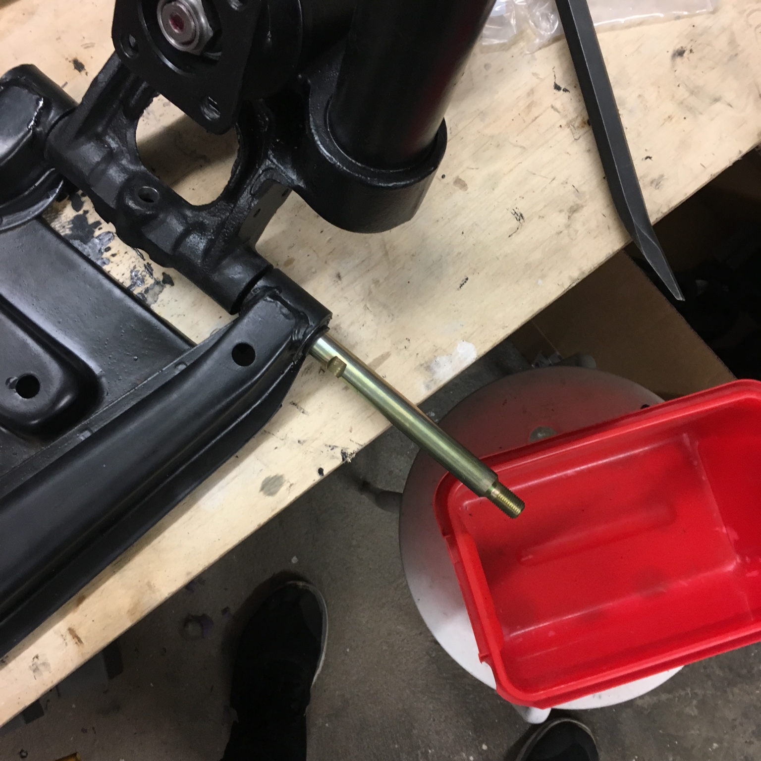

That did it.
The pins slide right out. The ant-seize actually made them less slippery. Had a nice time getting it completely out of the threads. Everything is finger tight for now. I’ll do the blue thread lock tomorrow.

Good. A POR-15 burr is a lot easier to take off than rust throughout the hole. Glad it was that easy. And I'm not surprised that the pin slid a little less easy after you had lubed it. That lube is pretty viscous and has significant shear required to move it. Makes sense. As long as it's clean and moves finger smooth, you should be good to go there. And don't torque the crap out of the tapered retaining bolt. All it needs to do is keep the pin from rotating while you torque the nuts on the ends of the spindle pins. Many people over-torque that tapered lock for no reason. It just doesn't need it.
And I wouldn't worry too much about getting all the grease off the threads before the thread lock. Especially if they are deformed thread nuts. I've been known to both lightly grease and thread lock nuts sometimes. But I've got a screw loose, so maybe you shouldn't follow that example.  :)
Bummer. Where did it bend? My PO messed up mine pretty bad too. So bad that I ended up replacing all four corners on my 77.
It’s just the brace that spans the arm. They squeezed it in a vice and caved it in about 3/16ths of an inch. I measured it against the other one and don’t see any geometry change, so I’ll keep it. Just pissed because it was pristine before I gave it to them.
