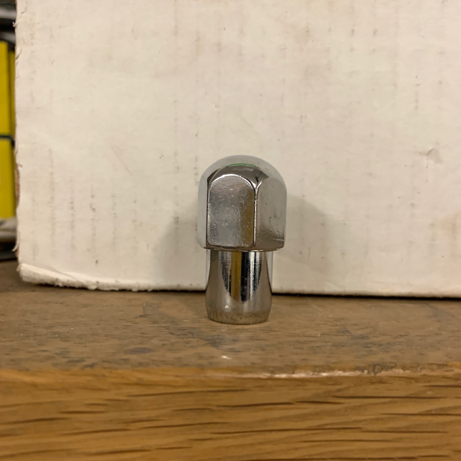

When digging through my garage for things to use as a sanding block on these wheels I found a pry bar that almost fits into the wheel hole and measures 17.42mm diameter. I measured the holes again on two wheels and got a range from 16.2 to 17.23, so I bought some domed mag nuts that have a .68” shank, which is 17.272mm, and I’ll open up the holes with a round file and cylinder hone bit until they fit.

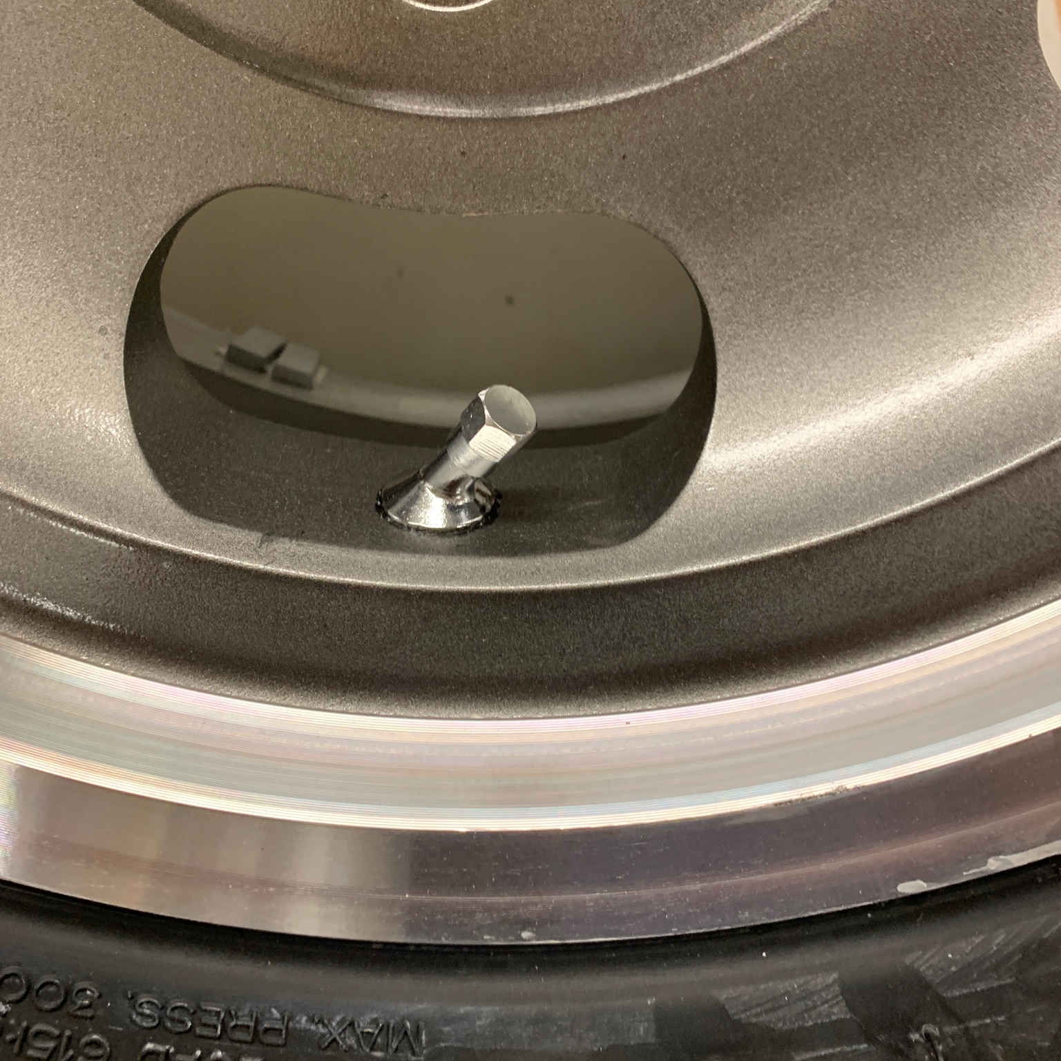

Now I just have to figure out how to turn the angled valve stem Costco installed sideways without taking it back, breaking it, etc.

Yep, Bruce nailed it. The .68” mag lugs I bought slip in perfectly from the other side, so it looks like a mix of compressed material in the front and poor measuring on my part. Most of them have zero resistance at all, so I’ll just file around the edges until it’s uniform.
These are the lug nuts I got (washer not shown):
Cool. I know you know this, but just be careful with the file. Fine tooth file and do a little bit at a time and don't remove any more material than necessary. Remember that they are lugcentric wheels and the registration position of the wheel on the car depends on the accuracy of the lug holes.
Don't go crazy with some aggressive rat tile file down in those lug holes and potentially change the center position of any of the holes.
