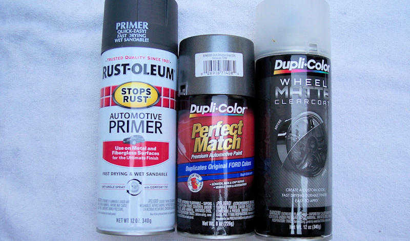

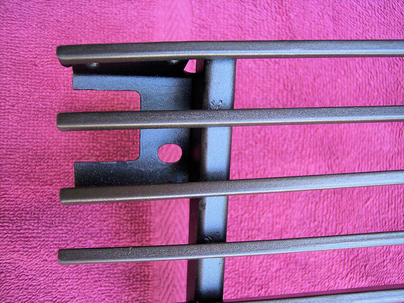

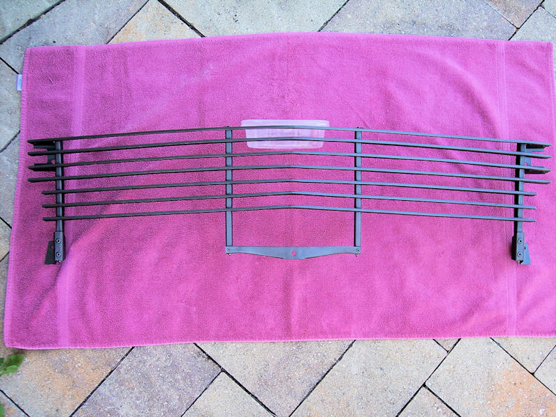

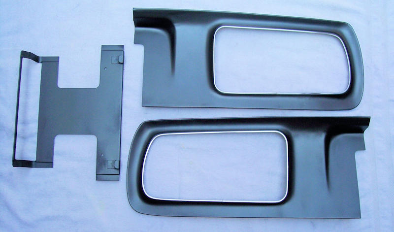

+1 on the Duplicolor approach.  I've finished one grill and two rear panel sets with that combination. The grill close-up is for a color check.  BTW - I primered the back side of the rear panels then sealed with clear.

Ah damn! I wish I had seen that before I did the wheels. I didn’t know that it was supposed to be non-metallic. They would have looked better like that.
Okay, so Dupli-Color CBFM0360 it is. Thanks for the help guys!
