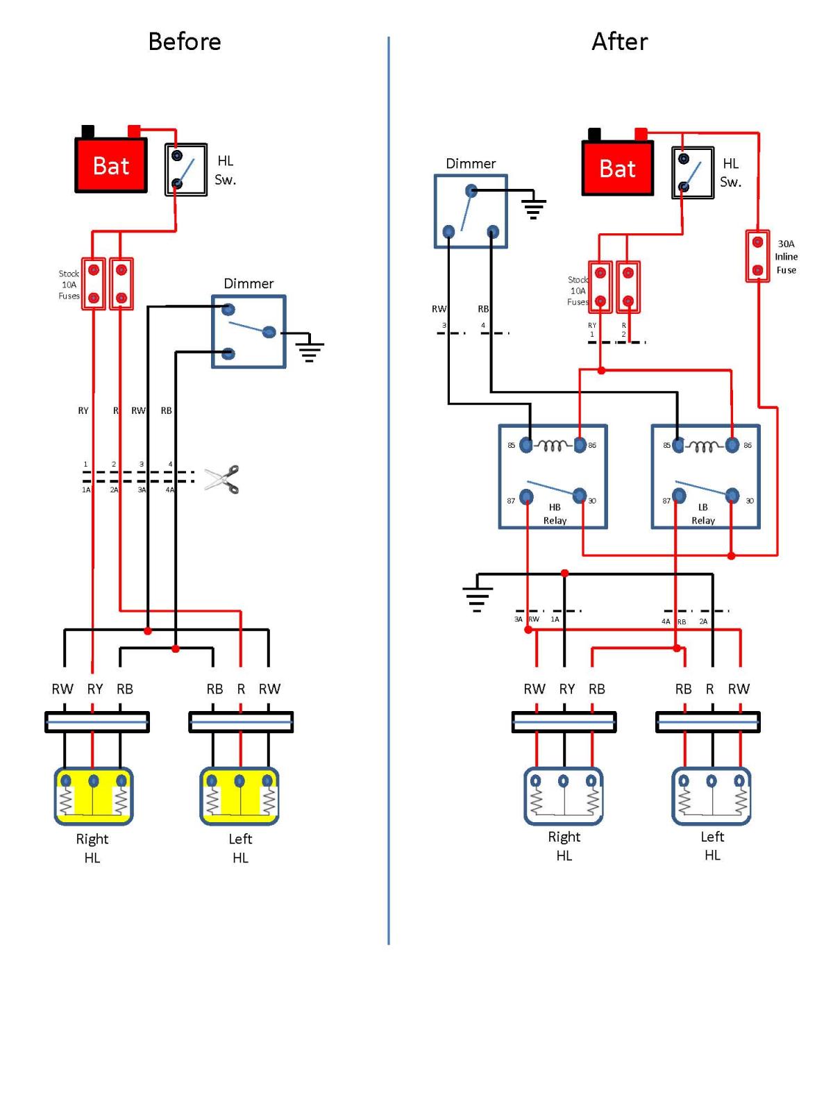

I recently completed a headlight relay upgrade, but I did it differently than the traditional approach. It's a little more complicated, but I think the results were worth the effort. Basically, I used four relays instead of two so that each filament has it's own set of contacts and high currents are not shared on the same set of contacts. While I was at it, I also modified the headlight switch to connect to ground instead of connecting to power. This enabled me to reduce the number of wires needed run to the relay block.
Advantages are:
Uses the original fuses in the fuse block and does not require additional wires run from the battery.
Original fuse block lid printing still accurate. Original fusible link still accurate as well.
Independent failure modes. One blown fuse or relay fault won't turn out all the lights at the same time.
Each filament has it's own relay minimizing losses in the relay contacts. High beam currents are not shared.
Fewest number of wires going to the relay block (six).
Disadvantages are:
More complicated than the traditional approach. Not plug-n-play.
Have to modify headlight switch and jumper around headlight switch under steering column. (Much easier than it sounds!)
Have to run additional R/B wire out to one of the headlights.
Here's a schematic of how my headlights are now connected:
I took some current and voltage readings before and after the upgrade and I'll get them into presentable form and post the numbers. The results were illuminating.
Thanks for the glowing review.
I've got a couple other sketches of different alternatives, each of differing levels of complexity and advantages/disadvantages. For example, a compromise on the 4-relay version above is one that uses two relays instead of four. This two relay version is simpler and would probably be what I consider the "sweet spot" between complexity and benefit.

I really like the fact the original fuses are still used and fusible link rating is still appropriate. I also like that there is more than just one fuse for the whole headlight system as compared with the traditional approach.
And other than the changes required to the headlight switch (which sound more terrifying than it really is), this version can be done with add-on harnesses which can be removed at a future date if desired. That's why I'm thinking this may be the sweet-spot between features and ease of use.

Now that we have fuses that are hot at all times, let me shed a little light on how I modified the headlight switch to connect to ground instead of +12.
First, de-solder the two original large wires from the headlight switch. Note the two shiny empty connections on the right side:
Solder on a couple smaller wires with bullet connectors on the ends. One male, and one female. Doesn't matter which one goes to which post on the switch. Snap the male bullet into the large dual bullet black ground connector and leave the female hanging:
Plug the male bullet from the HI/LO beam selector stalk into the female bullet and you're done. Note that the wire from the HI/LO selector used to get plugged into the large dual bullet connector on the black wire. Now instead it goes to the female bullet to the headlight OFF/ON switch:P1070087_zpsellki9hc.jpg
So now, with the headlight switch OFF, the HI/LO switch doesn't connect to ground, but with the headlight switch ON, it grounds the beam selector switch.

My dimmer switch (I called it the HI/LO Beam Select) is in the lower right of my schematic.

Here's a wrench for your idea:  Can you figure out how to do this with less wires through the firewall?  You're trying to put 4 more wires through a large grommet that is packed full of wires already (on my 280Z for example.)  You may split the grommet and lose the seal if you force too many new wires through there.
