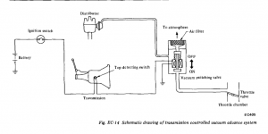

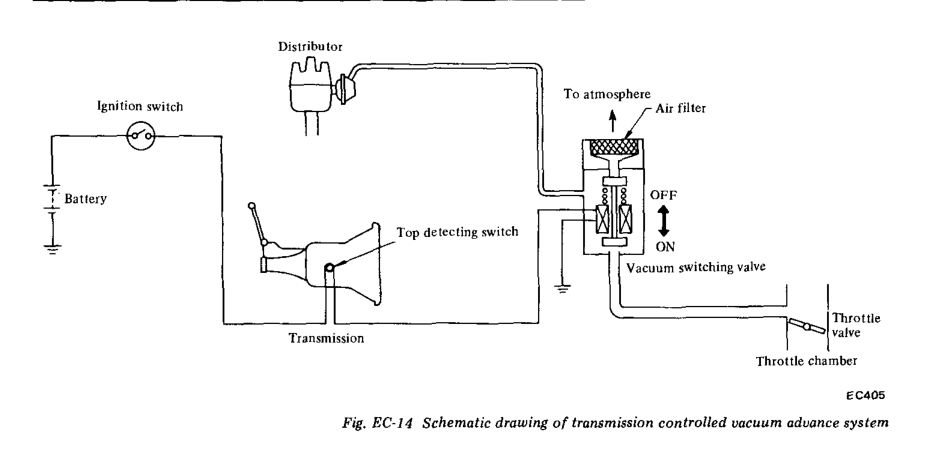

That just gave me a thought. I don't have the Ported Vacuum switch installed ( Federal Dizzy 1976 280Z) . That should have +12V with ignition and I believe that it is ground switched.
One more goofy 76 switch is the "top gear switch" that actuates the vacuum advance control solenoid.  It runs through the transmission switch though so you'd need to extend the wire from the switch location.
Looks like they used it to power a lot of small loads, like the hazard switch light and various gauges.  It's fused though.
post-19298-0-56337400-1432946501_thumb.p
Yes..that's the thingy I was calling a Ported Vacuum Switch. I'll find it's " Hot " feed somewhere.
