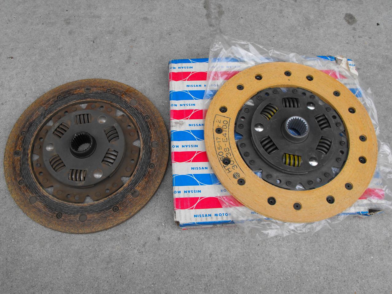

Original clutch disc from my 3/70 240Z and the replacement disc.  Original disc shown has about 95K miles on it.
Rich
Thanks for adding the pic here for reference, Rich. Would have been nice to have an original disc with the box to add to the build for originality, but the replacement disc will have to do. In the future it can be changed if there's nothing left to do. The one thing I noticed with the replacement disc was that the splined section that sticks up above the hub itself is a tad bit shorter, but I think even the clutch kit ones are the same. It shouldn't create any issues, as i'm sure there is more than enough engagement area on the hub. All Nissan's I've installed clutches onto grab the splined input shaft with splines showing passed both top and bottom of the splined region. So aside from this disc not being exactly OE, I think it's gon' work! Bit of a set back waiting a week for it to come in :(
