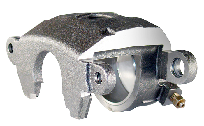

Yes, that's how the calipers look right now, and they are all assembled and ready to install.
