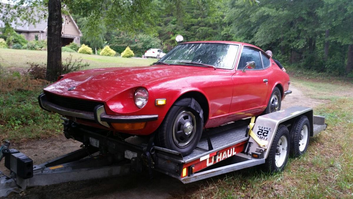

Looking at the pictures, there was some welding done to it. But I don't think it's that of a problem, you could get a bodyshop do some repairs to make the body solid.
The interior is in decent condition to ? Looking on the pictures it even has the original size tires with hubcaps, at 6K I agree with the rest above, this is a steal, even if some bodywork was needed.
One question does it have the matching number L24 ? If not that would be a set back..
I can't believe everyone is telling you to just buy it. Yes it's rare, yes values are going up, but I'd only buy it with the expectation of replacing both front rails (which is worst case scenario) also the front radiator support not being early type indicates it's had a front end smash (in my opinion).

The real question is, do you want to go that far on this car? Yes $6k seems cheap, but you may find another early car in better shape for around $15-$20k and that car will cost far less in the long run than something that needs the front frame rails repaired.
It seems to me that everyone is telling you to buy with your heart not your head. I know that's sometimes the fun of it, but you don't want to buy a bent banana.

Even if it has rust in the common spots, white and blue combo is super rare.....Make no mistake it will need full rust work but it's complete from the look of it.
I would approach both cars as if they need full restoration...

@ Gav: it can't be that bad that's it's beyond repairable. The bodywork seems to line up fine from the pictures, but I can't tell for sure. Maybe the topic starter could get the car to a good body shop to have a closer look ( pay them a few dollars to inspect the bodywork ) if he doesn't know where to look for himself ?
To quote a friend of mine "As you know photos can hide a lot of $^!#". Yes the car looks to align in the photos provided, however it's all relative to the angle of the shot, quality of the photo etc..
I agree it all depends on what the OP wants out of the vehicle, however if the car is to be daily driven and does have serious frame rust issues how safe will it be in a crash? 240z's are not very safe to start with, let alone a 40 year + rotten frame in an accident.
In my opinion if you sand blast those frame rails it will be a 'heart stopping moment'. You either have solid metal or lots of holes.
The problem with buying such a vehicle is that once you start taking it apart to fix something like that, it becomes a slippery slope to full restoration. I'm the last person to deter someone from restoring an S30z especially an Early S30z which are hands down my favorites. I just want them to know what they are possibly getting themselves into.
