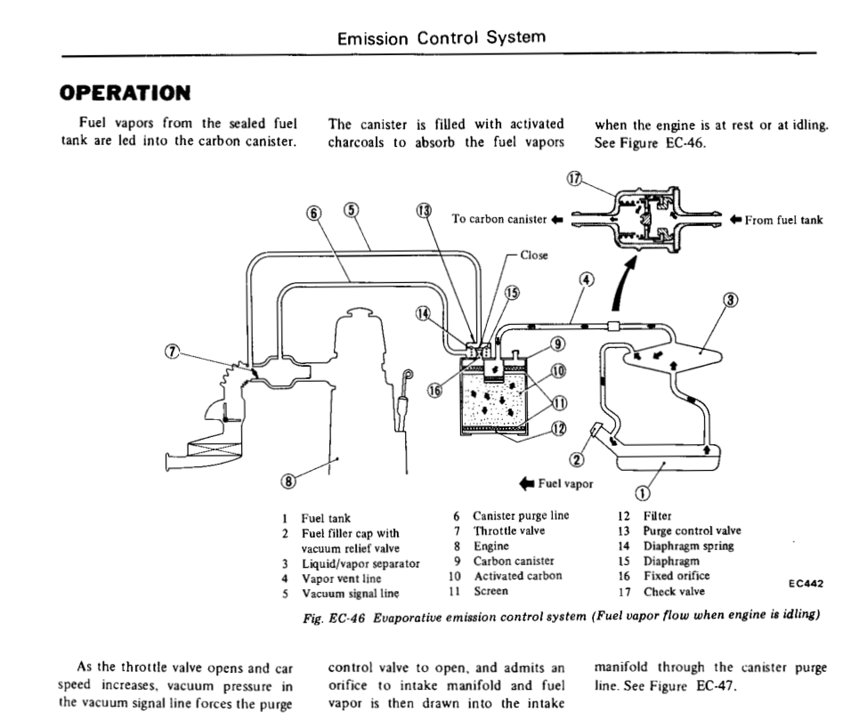

My gas cap doesn't whoosh, and the system seems to work fine.  Could be that my check valve is weak though.  Copied a picture just to show all of the parts of the system.
post-19298-0-79560700-1433956942_thumb.p
